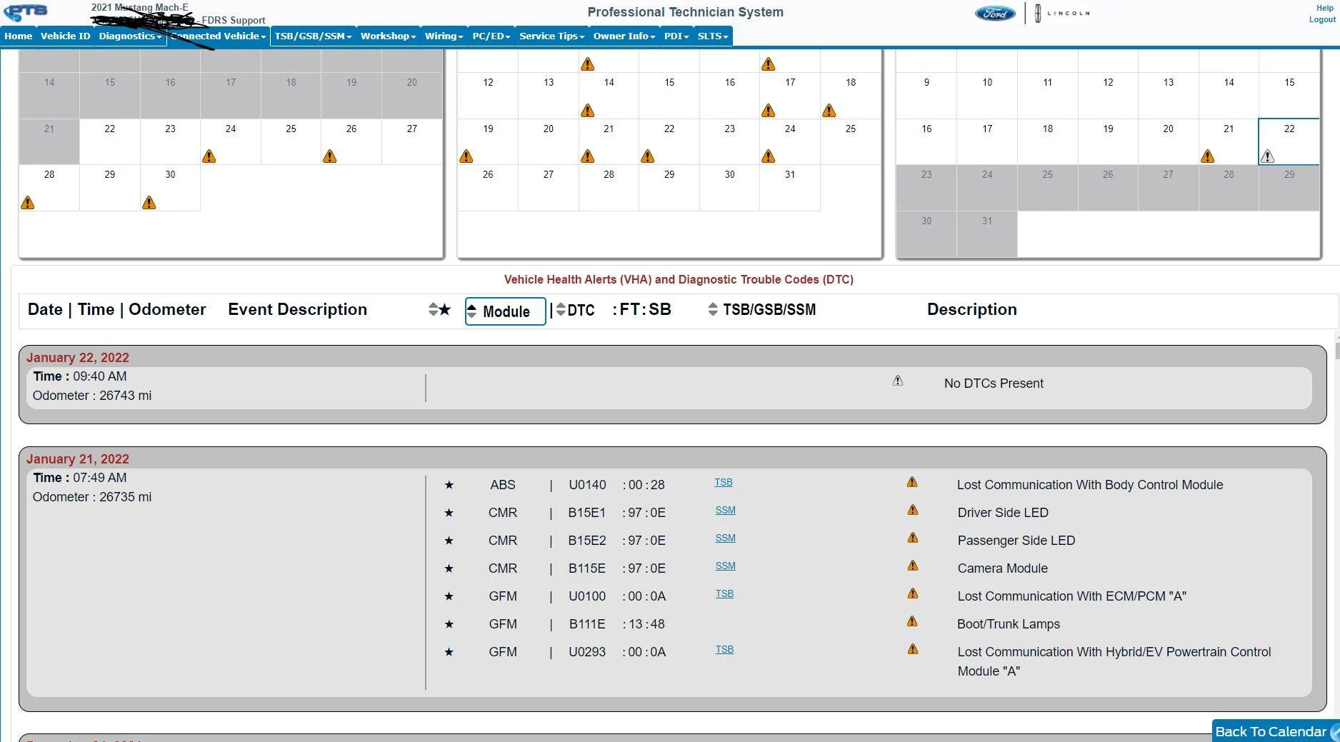

UPDATE!
We were surprised to get a call late yesterday saying the car was complete, so had to scramble to get a plane ticket to get to where it is. My partner is picking it up right now. He is going to stay with family close by and drive home tomorrow (7 hours) so it will be put to the test.
Replaced 12V Battery and the Battery Energy Control Module and High Voltage Fuse Box and happy to login this A.M and see No DTCs Present as being reported OTA. :)
I will update once I have the paperwork showing exactly what they did and the tech notes, and how the drive home went for him. Just in time since it has been 4 weeks, but they are covering 1 monthly payment for the hassle, along with paying for the rental of course.
Wishing everyone the best with their specific situation, we know how challenging and frustrating it is!

I finally have the tech notes of what they found with our MME.
406 10B687 CC 42 VERIFY CUSTOMERS CONCERN VEHICLE HAD NO POWER 12V BATTERY DEAD. LOAD TEST BATTERY WITH DCA 8000 BATTERY FAILED 312C4XXXXXXD PERFORMED BATTERY REPLCEMENT AND RETEST
FOUND U0594 IN BECM, P0DA8 IN SOBDMB, P0D2D, P1A10, U351B,U351F IN SOBDMC. PERFORMED HOTLINE CONTACT PERFORMED PPT CH AND PPT R, RESULTS INCONCLUSIVE. HOTLINE CALL FROM BRENT. FOUND P0AA2 IN VEHICLE HISTORY. PER HOTLINE. LOWERED BATTERY PACK. PERFORMED HIGH VOLTAGE JUNCTION BOX AND BECM REPLACEMENT. PERFORMED BATTERY LEAK TEST-PASS. REINSTALLED BATTERY PACK. PERFORMED REPROGRAMMING AND COOLANT FILL PROCEDURE. CLEARED ALL CODES VEHICLE NOW RUNS AS DESIGNED.
$2,650.50 for parts/labor of 7 hours plus$500 of rental car fees. Was out of service for exactly 4 weeks.
