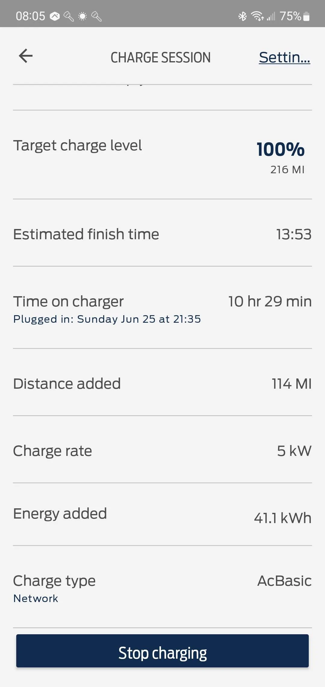

Does anyone have seen a higher than 4kWh charging rate with Ford Mobile Charger Level 2, 240v, 32Amp for Mach E GT?

7.68kW is the rated output power of the Ford Mobile Charger, level 2. However the charging rate of which the Mach-E GT received mostly at 3-4kW, rarely at 5kW.
The latest updates in the FordPass app has the Charge Rate. It also can be calculated by using the Energy added / Charge Time in Hrs. = kWh in average.
In theory, it should charge at 7kWh at the beginning then slowly tapper down to 3kW after 60-65%. The highest charge rate I have seen is at 5kW but very selfdom, typically at 4kW then down to 3kW.

Ford Mustang Mach-E Charge Rate Screenshot Charging_FordPass
Your outlet voltage has to be seriously low for this to be the case or the EVSE is faulty. I would check the CB and outlet for excessive resistance which results in heat.
The Ford Connected Charge Station is an option for the Mach E which Ford recommended. This charger has an output of Max 48A / 11.5kW. I want to upgrade the charge to this but unsure of how much AC energy the Mach-E GT can accept.
With DC fast charge, it can take as high as 150-163kW.
You have outlet, wiring, or charger issues slowing your charge rate down. It should always show 6 kW or higher in FordPass. If the amber light turns on, Mobile Charger is bad and should be replaced.

For OP- regarding the time value…
the pics you posted look to be before your charge session was complete. I had a similar reaction this morning when looking at mine. However you will notice that in the snapshot it shows “time on charger” - this number only indicates how long the cable was connected. (Not sure why they even report that)
To see actual Total Charge Time for the completed session:
Select Charging/ Charge Logs/ then select your session from list. Now FordPass shows you the Total Charge Time that you could use.
