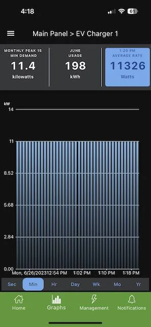

Same as you Mike. I charged this afternoon from about 75% to 90%. My car is in the garage and it is 82˚ in there. I have the charger set to 48A charge rate and it maintained an average of 11.3kW. I have not seen any fluctuation or reduction in any of the times I have charged recently. Below, I took a couple of screen shots from starting at 1:20 PM and ending at 2:20 PM and you can see it never fluctuated.

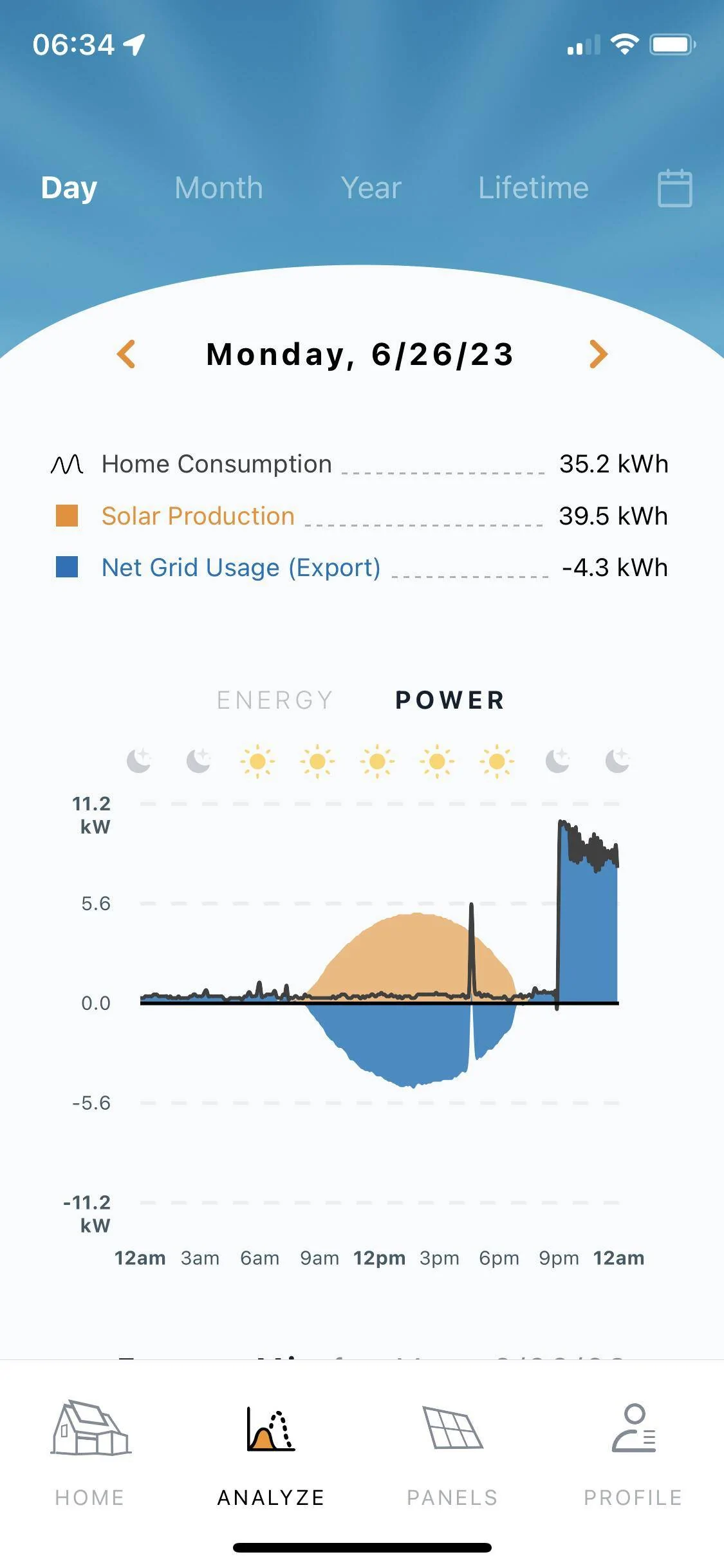

I have also seen this behavior with the recent updates. I first noticed this right after I got 4.2.6 (which included 22S41), but I had also gotten 23-PUO105-DC-CHG2 shortly before that. Anyway, here's two screen shots of my house power, monitored by my solar installation. The first shows a steady ~9.5kW draw, consistent with 40A out of my L2 charger (Grizzl-E). The second shows an erratic behavior, starting at 9.5kW, but dropping down to below 7kW. (I'm subtracting off my ~0.5kW baseline house usage at night).
