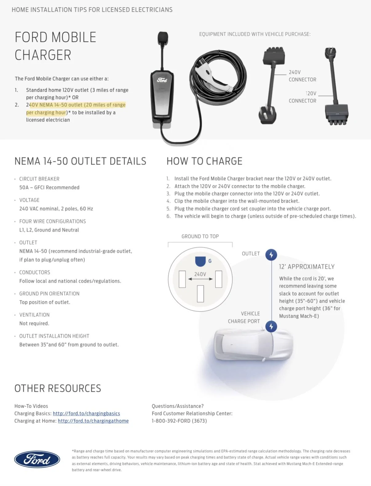

The MME’s max charge rate is about 11.5kW, but that requires a 48A EVSE.
Why does ford advertise the mobile 240v to be so much faster than it is then? Was just discussing how ford says it goes so much faster with a friend who also has a Mach-e. I understand what your saying just seems crazy that what it can do is less than half of what they say

this says 20mph
that's actually pretty accurate. you might be confusing the units.
assuming you average 3 miles/kWh driving efficiency (which they note they used on the 120V input) and the mobile charger's top charging rate (32A at 240V) of ~7 kWh into the battery, you'd have ~21 mph of charging range added.
EDIT: clarified miles unit of measure

this says 20mph
MPH isnā€˜t a good measure of charging rate since the miles you can drive per kWh can vary greatly.
That being said, at 6.5kW you get 6.5kWh in an hour. If you get 3.1 miles per kWh, that’s 20 miles. Which part isn’t accurate?
