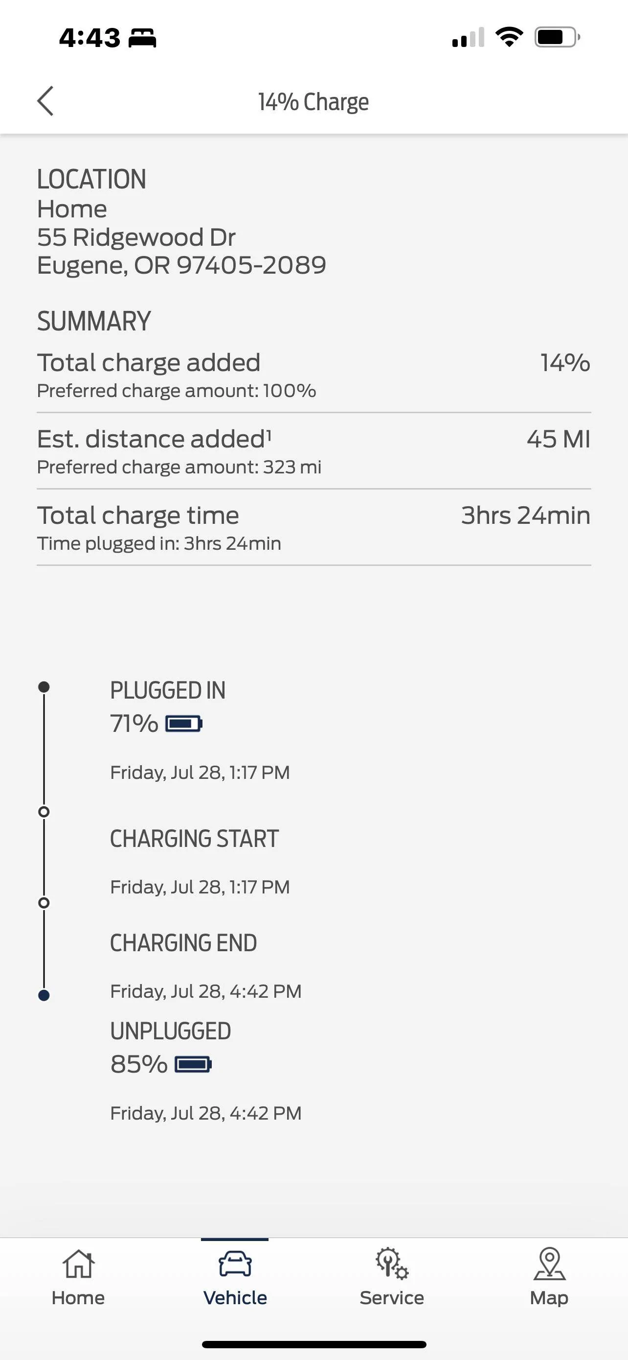

Charging again. First, FordPass has not updated in 30 minutes. (Yes restarted app) Second, the car itself is showing a charge rate which amounts to 4%/hour. Third, FordPass is not showing the amount of kw charging, even when charging status was being updated yesterday. Fourth, and this is the usual behavior, FordPass shows the amount of time plugged into the charger (not useful info) and not how long it’s been actually charging during the current session, which would be useful.

My vehicle is charging around 4% per hour - so definitely not at the normal rate.

Here….
Ford Mustang Mach-E L2 Charging at 3kw E86131E9-02EA-4EF6-8860-EC78FE4415B9
