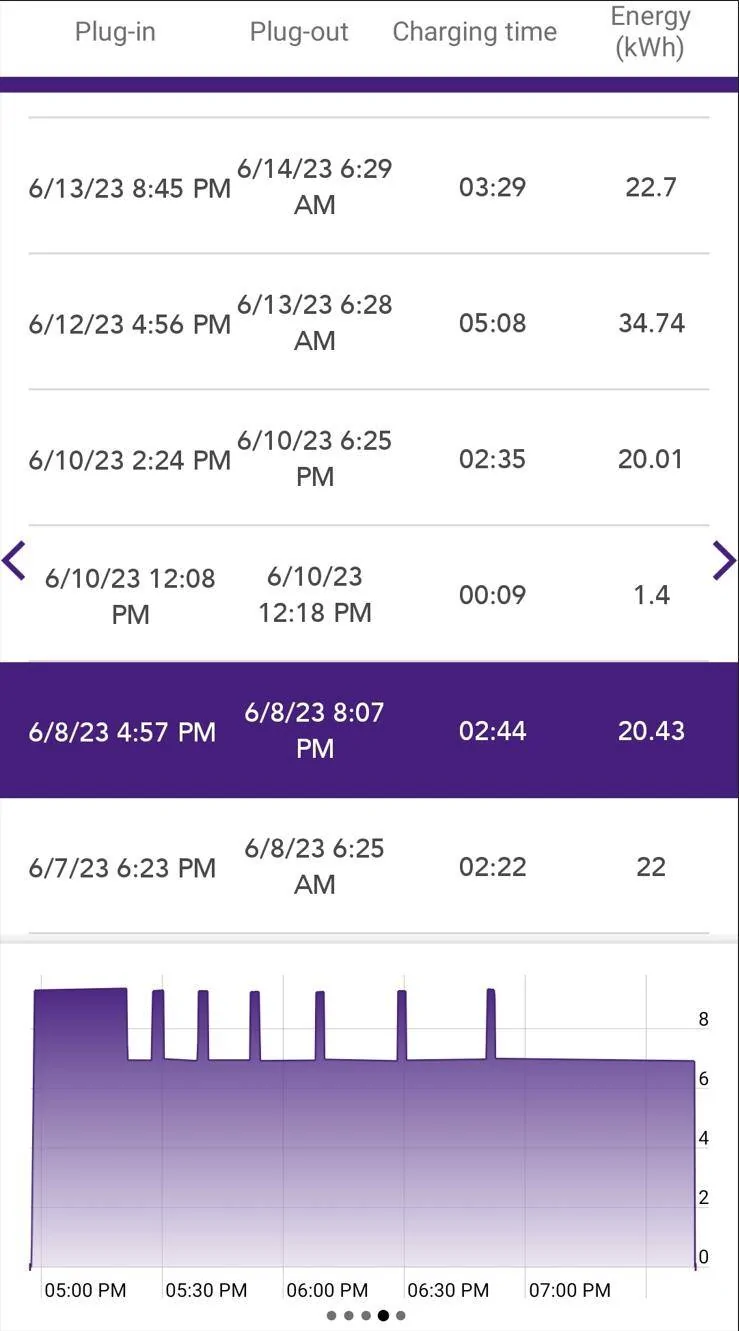

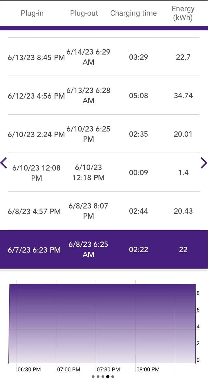

I have a 2022 GT
Every charge session up to 6/7/2023 looks like this:
Every charge session on and after 6/8/2023 looks similar to this:
What happened on June 8th? First Priority Update 23-PU0105-DC-CHG2 and then Ford Power-Up 4.2.6
I have the same behavior, 21 Job 2 (Aug 21 build) Premium 4ex. I looked back at my charging graphs and the behavior changed for me (at home) sometime between May 10 and May 22. I was on an extended trip during that time and I'm pretty sure I got updated during that trip. Since then, I seen the same style graph (Juicebox Pro 40) as the lower picture above. Note that I'm in CO at some altitude and its not warm here yet, so I don't think heat is the problem. Highest temp I've seen at home this year is still in the high-70's, and my garage is cooler than that.

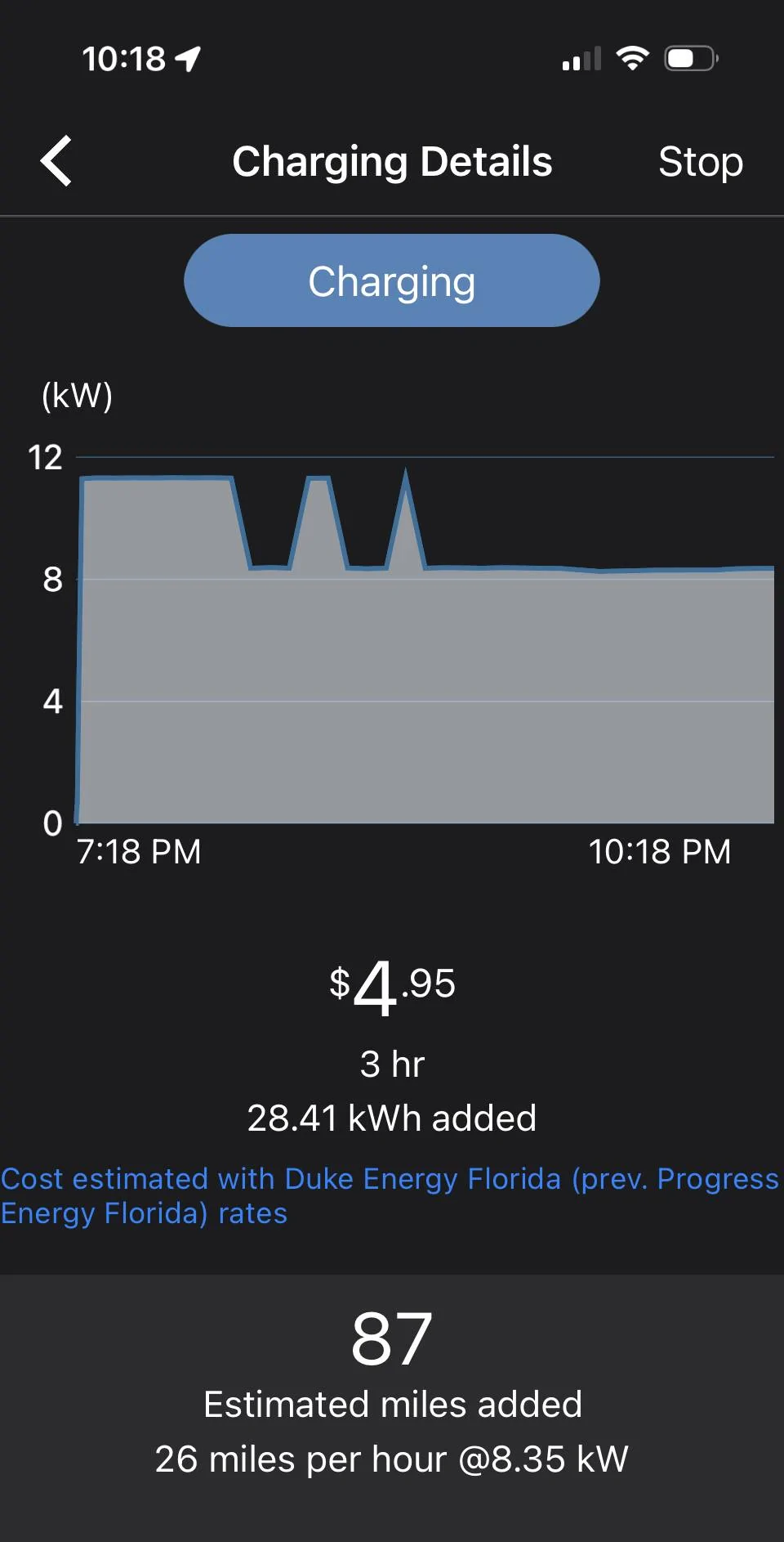

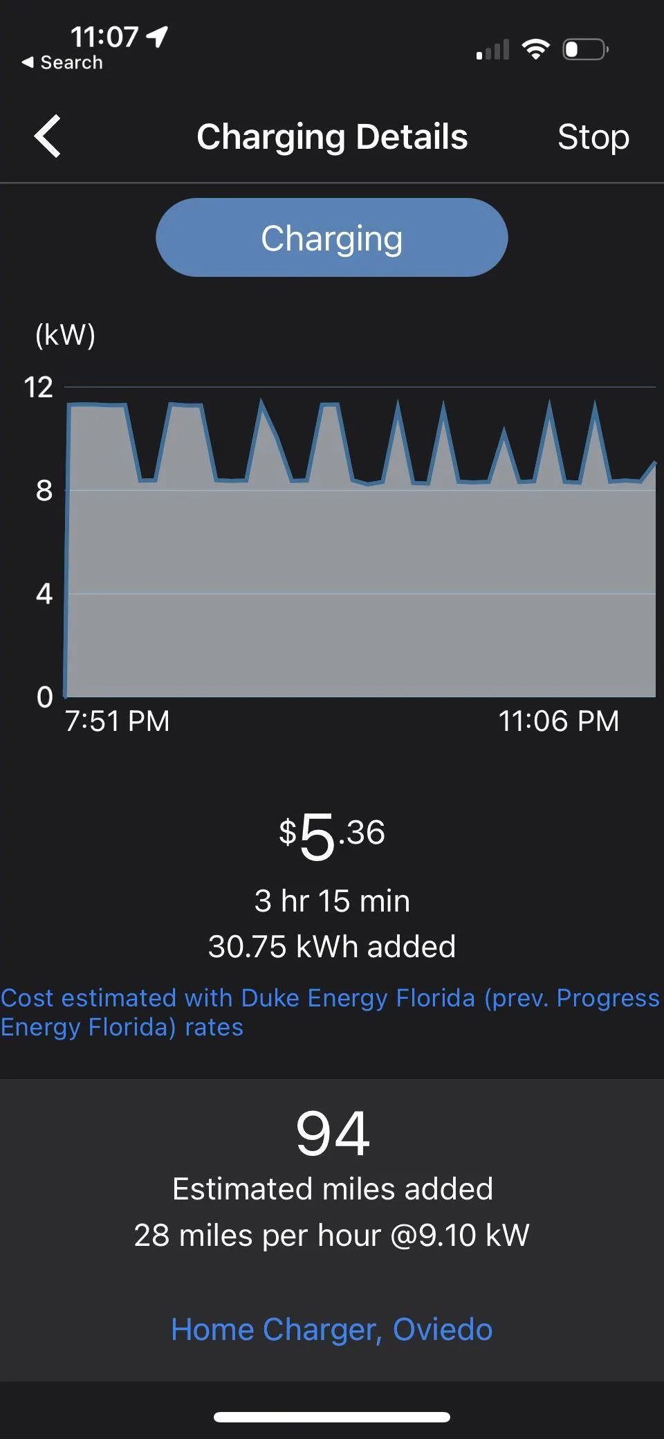

Adding my experience... Job 1 2021 First Edition. Had tons of software issues but those have been resolved finally and have gotten all OTAs and I'm current on 4.2.6 and recent DCFC update. I'm using ChargePoint Flex on 60A circuit for 48A delivered, in Florida where it's hot as hell. Anyway, I've always charged at 11KWH at home no issues for 2.5 years. After this last update, it starts out at 11KWH then throttles down to 8 KWH (per ChargePoint but Ford App says 7 KWH) or so and back up and down, but mostly down.
I also have a brand new Rivian R1S and that charges flat at 11KWH all night long no issues.
Would love to know if this is as Ford intended for whatever reason or if this needs to be fixed. Bit of a PITA for me because we share the one charger so sometimes we charge one car in the evening and swap out but now the charging is quite a bit slower, right?
