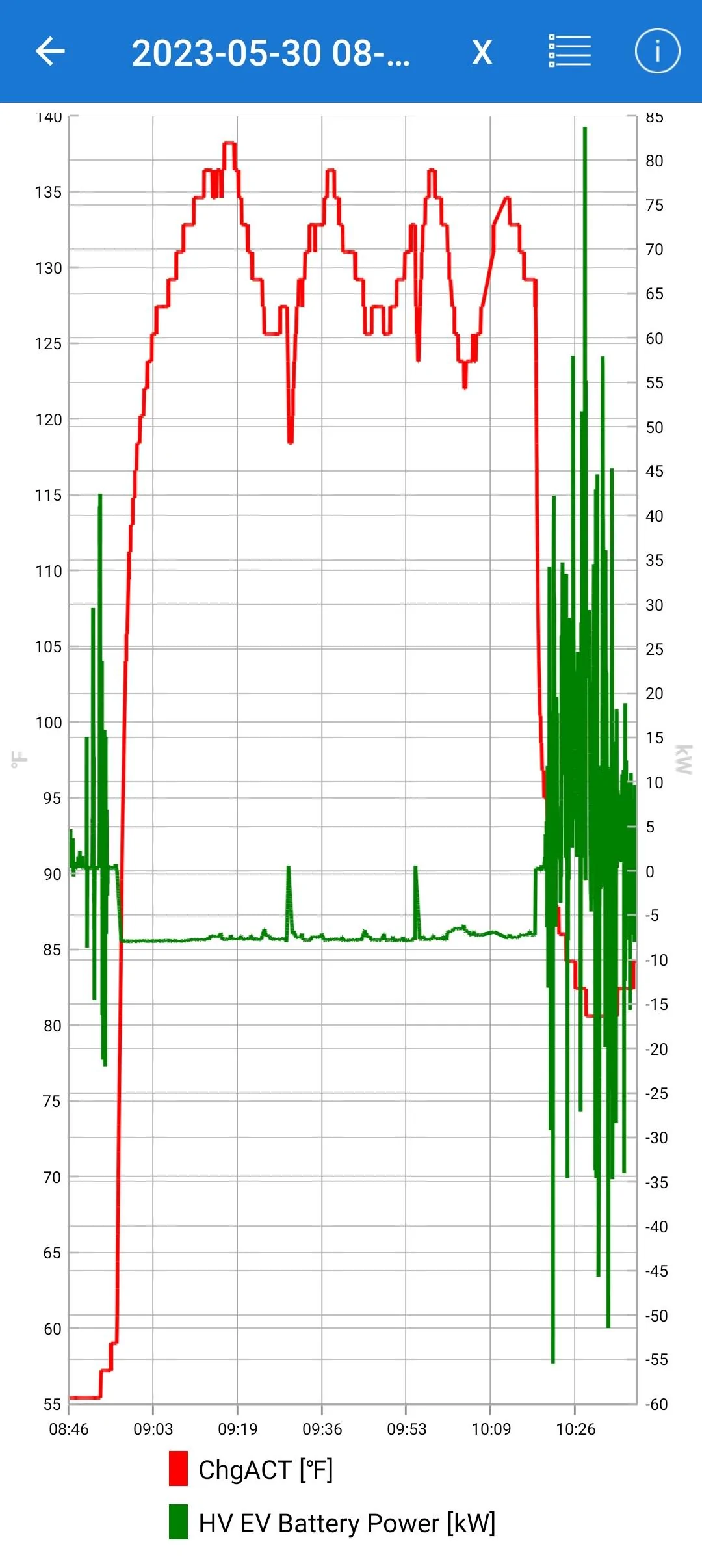

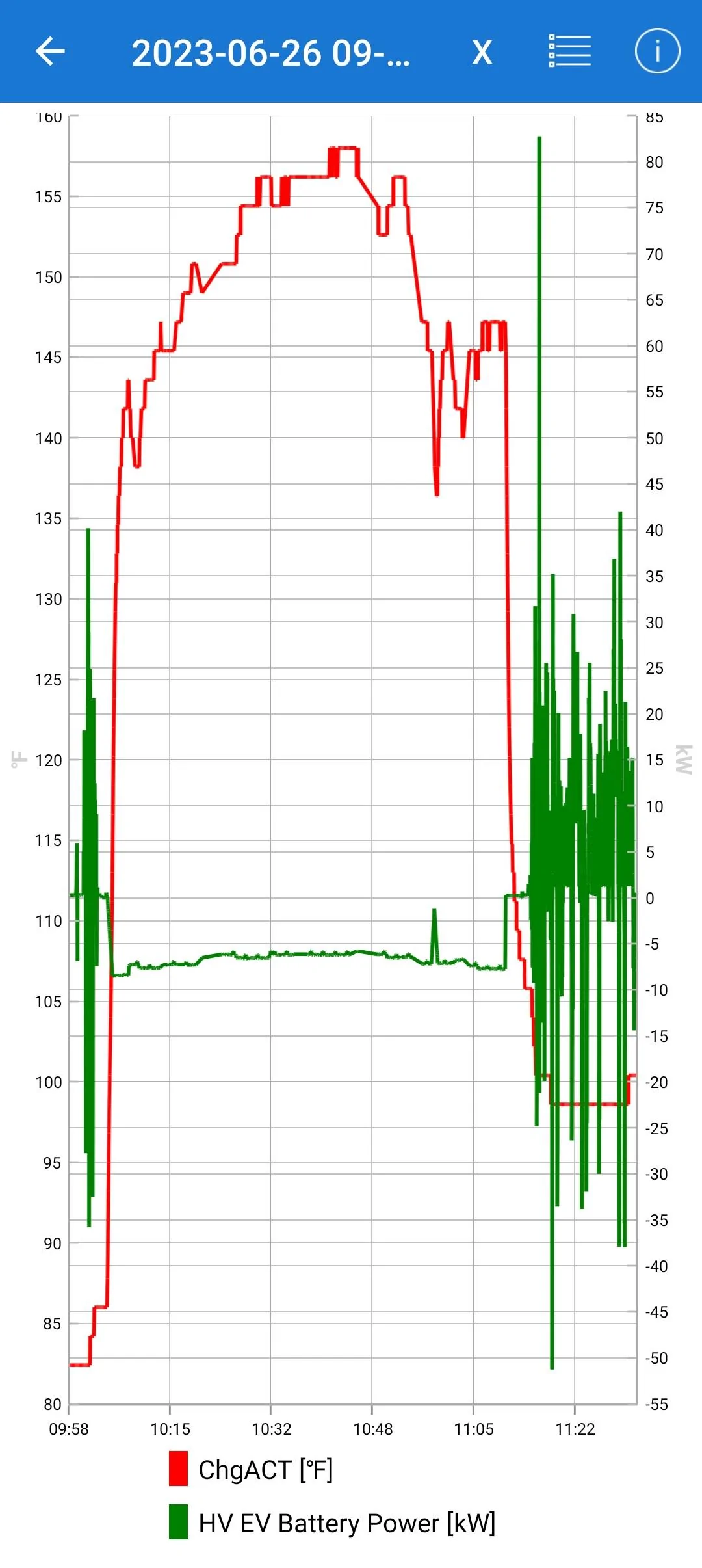

My 2021 Job 2 has not started reducing the charge rate, but something seems to have changed re: OBCC cooling strategy. Last year my car had a single episode of charge cycling, it would stop momentarily then resume every couple of minutes. I started monitoring the AC coupler temp. value in Carscanner to see if a pattern was developing. I observed that the coupler temp. would rise above 135F then go down to 127F consistently, coolant pump could be heard cycling. I believe this was the normal behavior before the OBCC OTA, which I got on June 2.
The graphs are from charges before and after the OTA. Coupler temp. gets well above 135F now and does not show the previous cooling. Where there's smoke, there's fire. Charging varied from 6 to 8 kWh at the HVB.
Ford Mustang Mach-E L2 charging speed recently dropped 33% Screenshot before OBCC
Ford Mustang Mach-E L2 charging speed recently dropped 33% Screenshot after OBCC
Those extreme Coupler temp. readings some have seen have to be a conversion error that may be unique to Job 1 MMEs.
FYI, I never could find the Coupler temp. that throws a fault for the MME, but I came across a Porsche TSB that stated 195F was the threshold for the Macan, FWIW.

I think the data parameter is wrong in Car Scanner, what you're actually looking at is the on-board charger internal temperature. FYI the charge port is not liquid cooled. The charger power electronics are liquid cooled. I also think the temp scales are wrong in Fahrenheit.
It looks like for whatever reason, on some Mach-E's the motor electronics coolant pump is not being turned on when it should, and as a result the charger electronics overheat and the charging rate is derated in order to protect itself from thermal damage.
