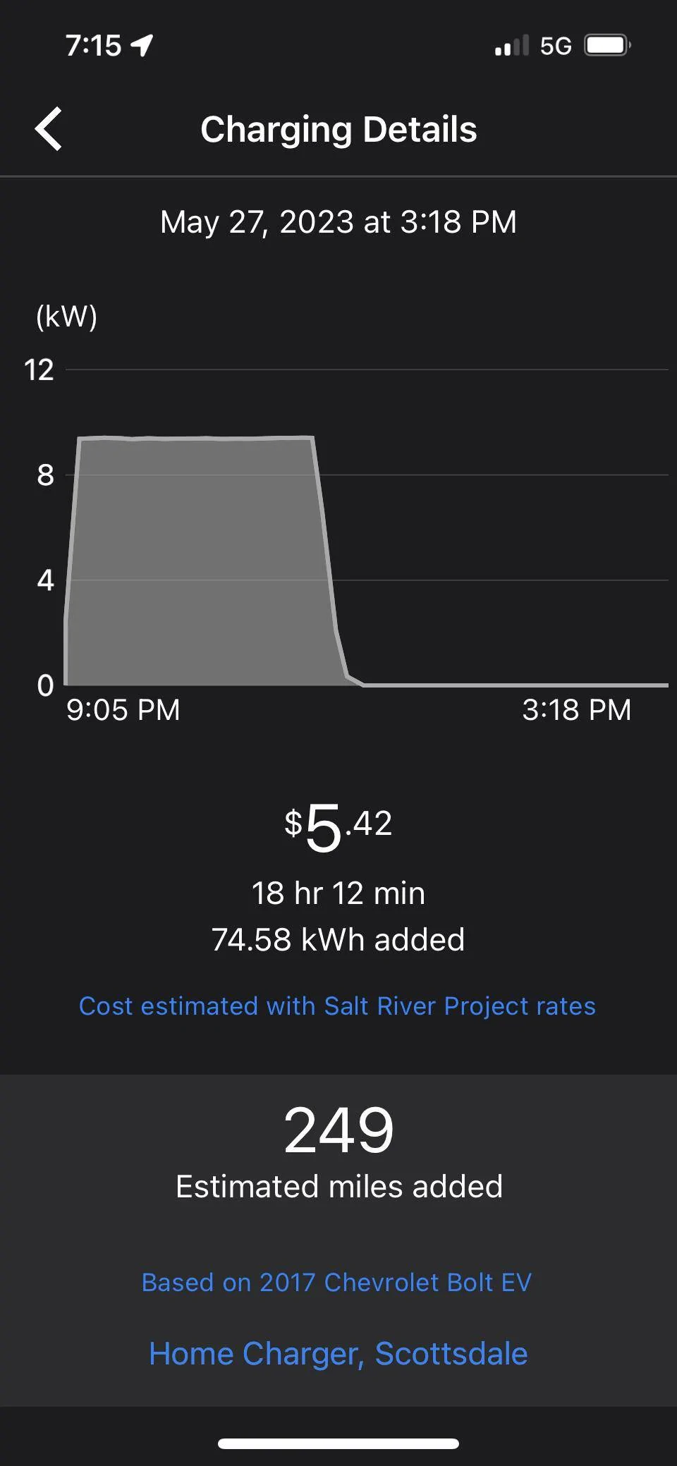

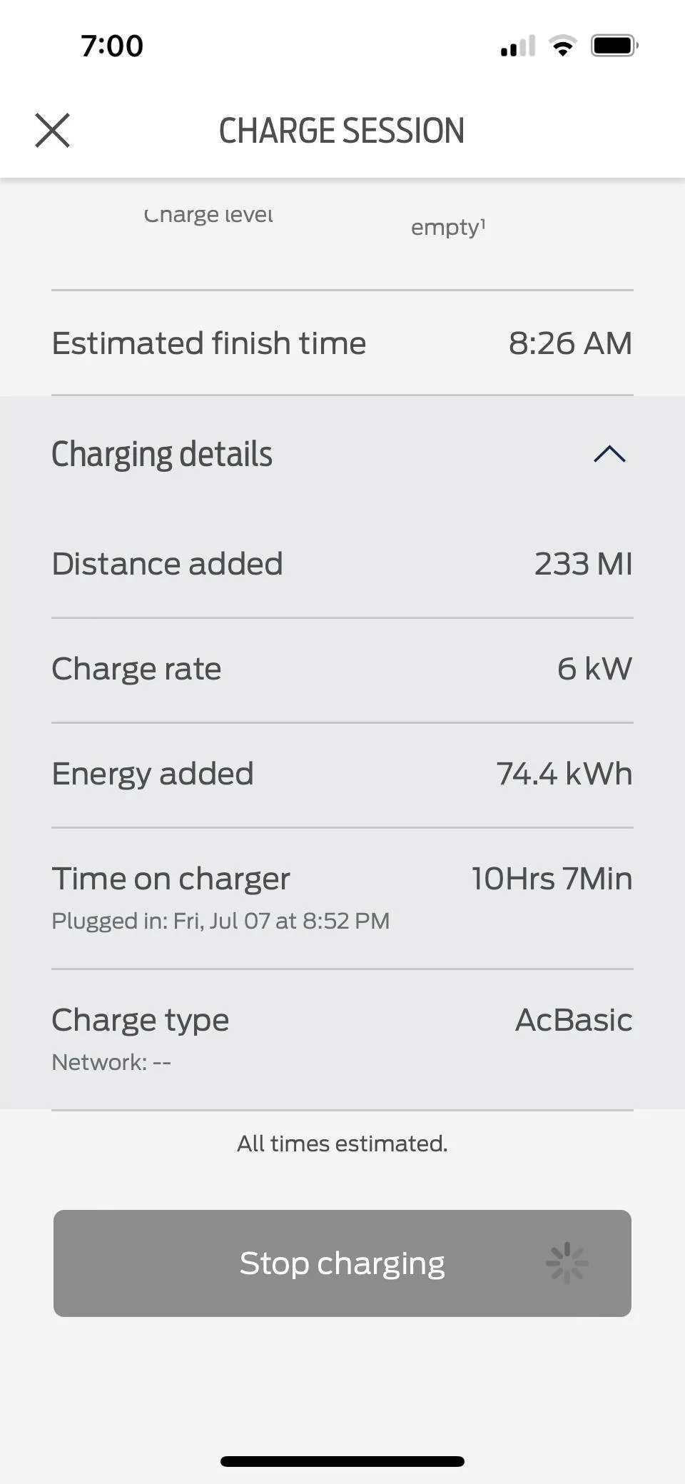

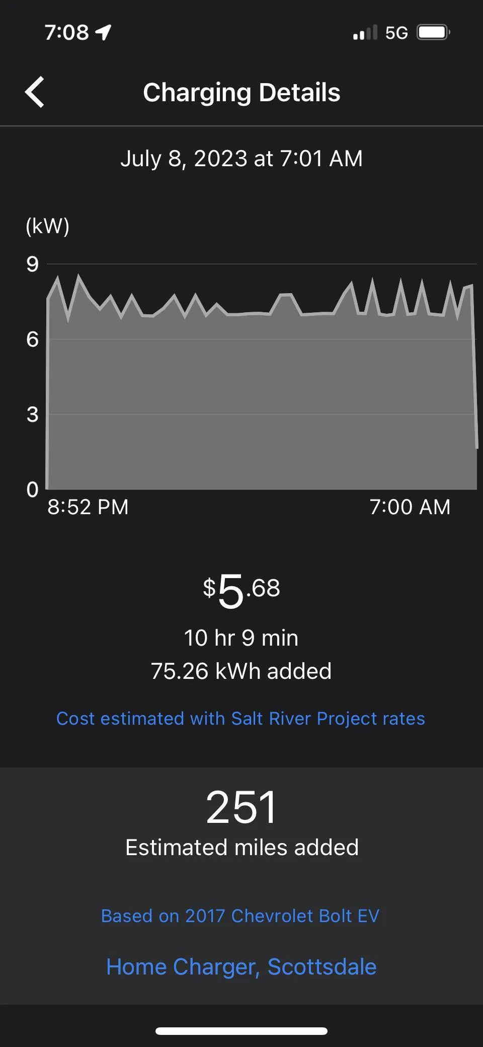

I hate the DC fast charging update. I never use DC charging and my home L2 charging rate has decreased and takes longer. Only peaks above 7KW intermittently for brief periods. Charging slower than my wife’s Mini with a less capable charger built into the car. Ambient temperature is not the problem either because I charge in an air conditioned garage where the temperature is maintained in the 78-80 range. I can no longer get a full charge overnight when rates are super low. You can see that prior to the update, the car had no problems charging at 9.4kw. Ford, please fix this.
