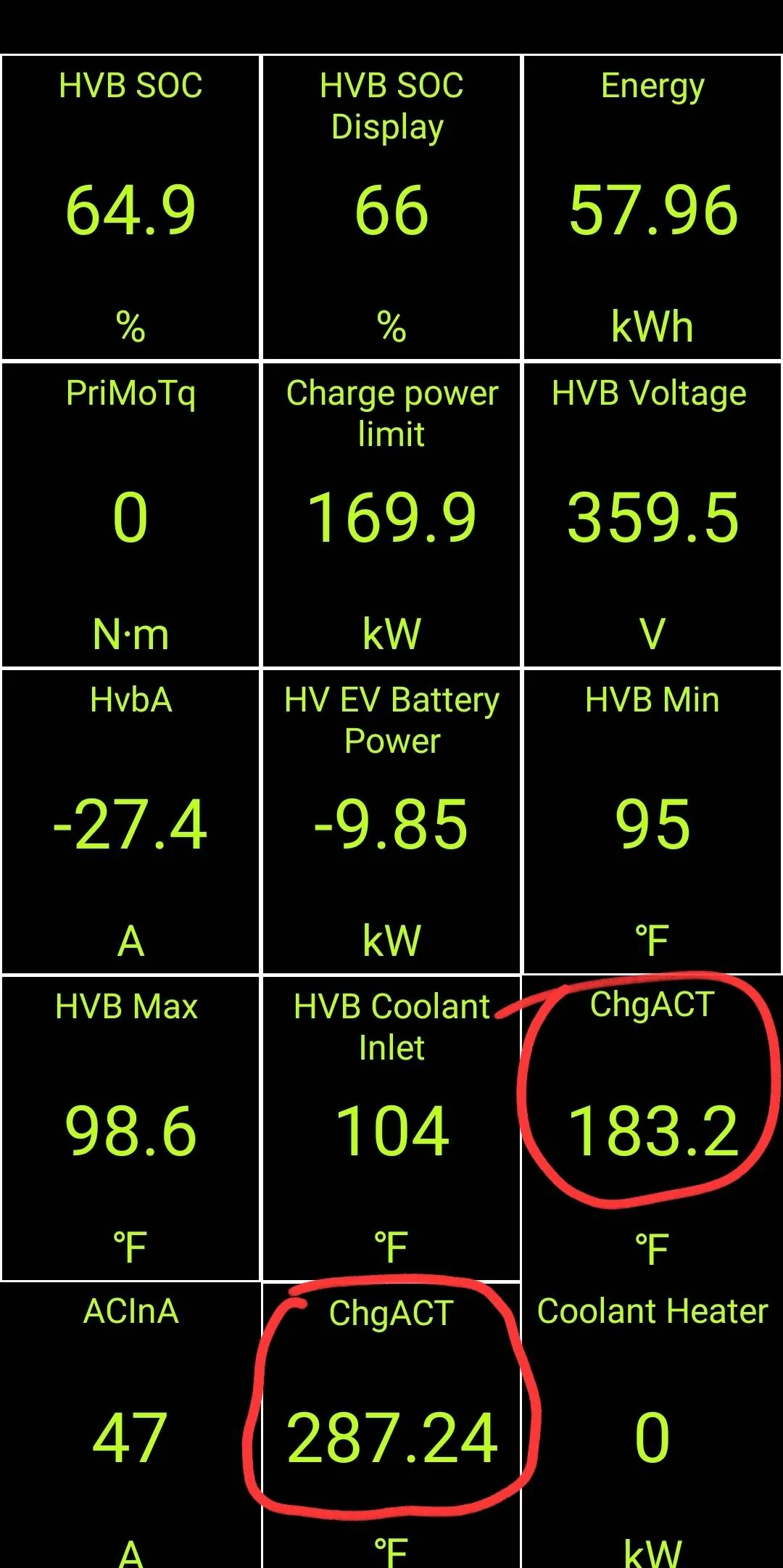

Is this consistent with what people are seeing when they need to get the charge port replaced? I finally broke down and pulled out car scanner and got this just before the car stopped charging.
The circled values are AC charger coupler temp

The 183F is actually the charger internal temp, not the charge port temp. Anything above 180F is too warm. The 287 number is just plain wrong, ignore it.
Looks like your charger module is overheating slightly. The cooling fans should be running at that temp.
I discuss these numbers from Car Scanner in a recent post:
https://www.macheforum.com/site/threads/44a-charging-temperature-study.29165/

Oh that's excellent! I'm going to have to analyze that a little bit more closely. I think my next step then is to check out the numbers with fdrs. Because as it stands I can charge for about 10 minutes on 48 amps, and 30 to 40 minutes at 32 amps...
Not acceptable at all
(And yes. The fans were going full blast)

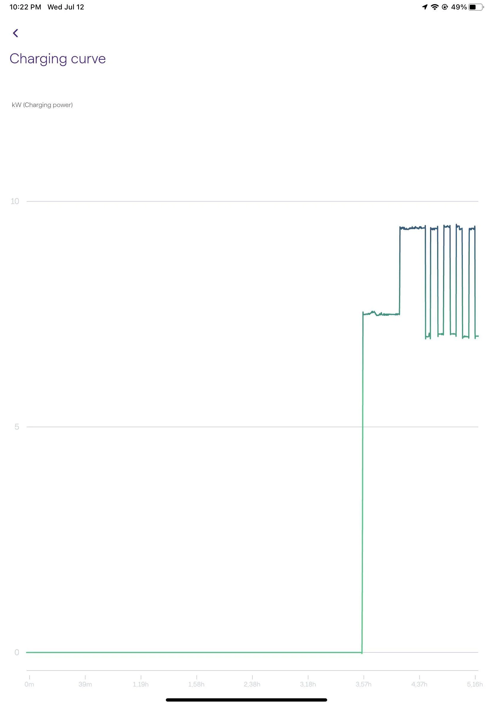

I haven’t used the car much since I was traveling- started to charge up tonight at 32 amp (unit is a Juicebox 40 amp plug in)
for about 30 minutes or so charge seems normal. When I remembered I had derated it to 32 amp, I changed to 40 amp- you can see from the attached picture what is happening, ping pong effect. I noticed this once before when charging right before I left on vacation but thought it was the juicebox unit. Guess not.
I have read bits and pieces here, is this strictly from a software update or will hardware need to be replaced. I would think software.
BTW my car is silent not normal cooling noises coming from it.
