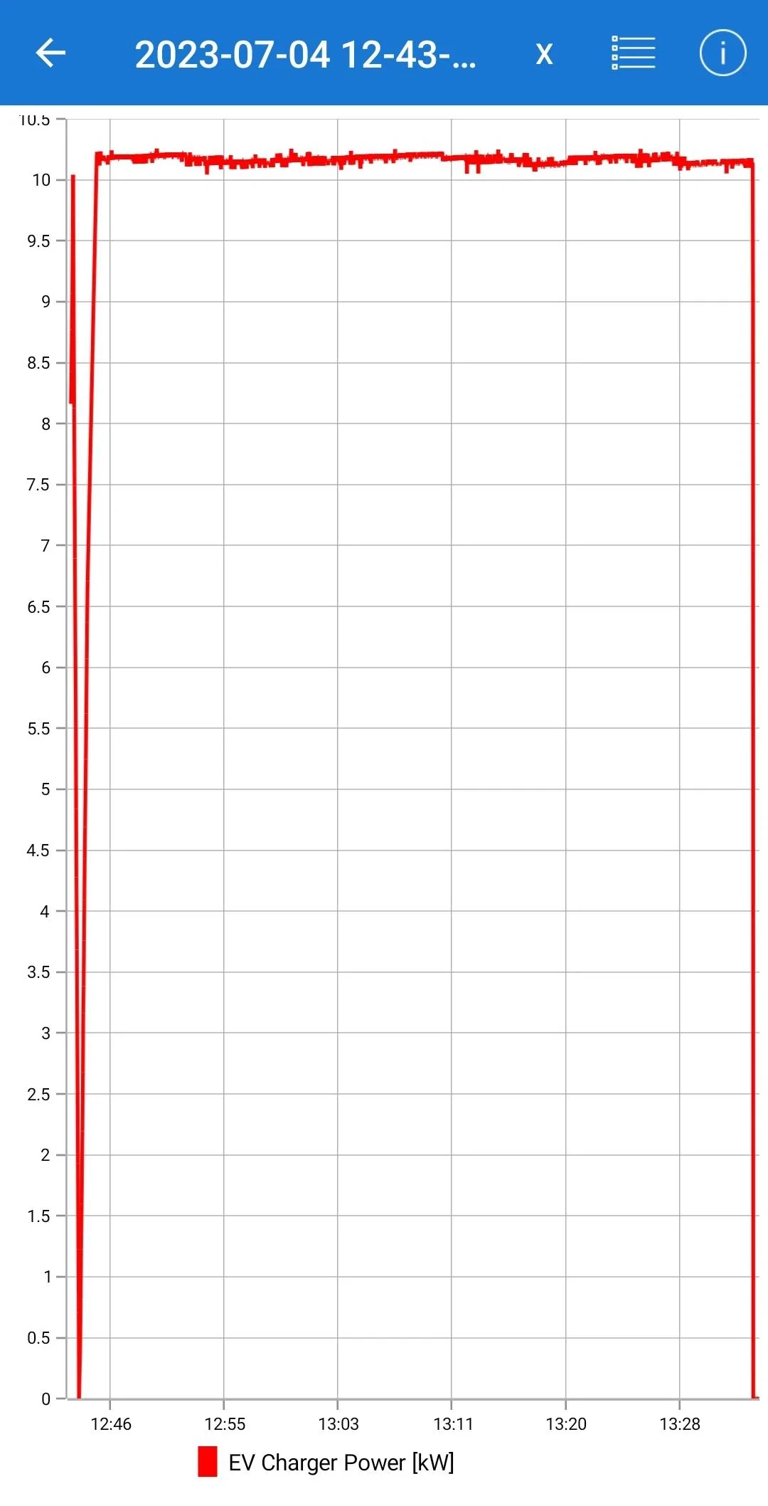

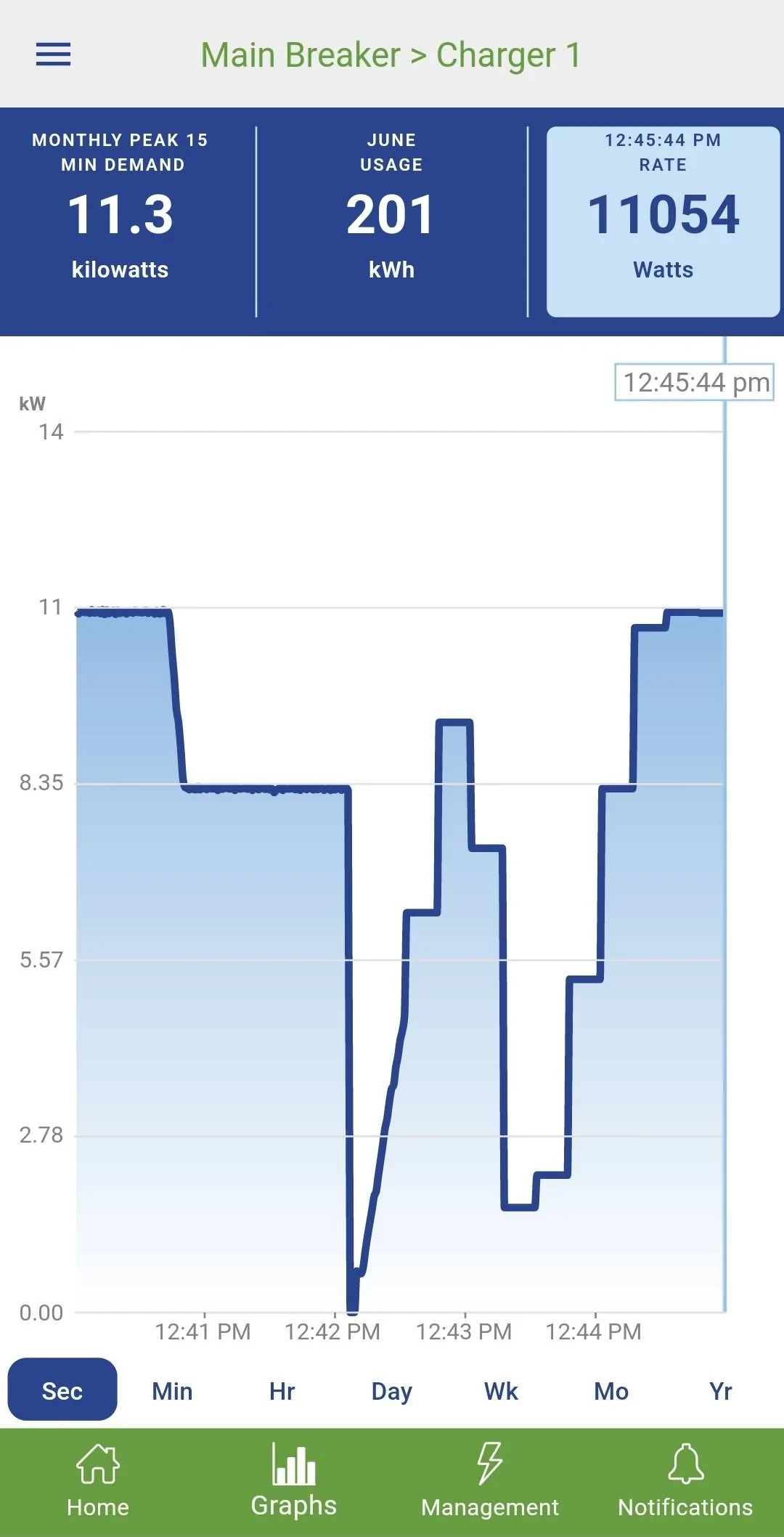

Well, I just discovered my car also has this problem. And I think it is related to the cooling of the internal charger as Lee suggested a while ago.
I parked my car in the driveway, in the sun with ambient temps of around 90 degrees. The car indicated 100 degrees on the display when I drove the car after charging, so the car was definitely hot.
About halfway into the charge I checked and saw this craziness:
Ford Mustang Mach-E L2 charging speed recently dropped 33% Screenshot_20230704_134314_Emporia Energy
Unfortunately I wasn't recording OBD data so I went to the car and started it in accessory mode to power up the modules needed to connect my phone. Within a minute of me doing that the charging rate stabilized and continued as normal:
Ford Mustang Mach-E L2 charging speed recently dropped 33% Screenshot_20230704_134453
I noticed the car was very quiet and I didn't hear the fan when I went out to connect the scanner. After the charging stabilized I noticed the shutters were open on the front of the car and a fan noise was audible, but not very loud. It is possible that fan was running and the shutters were open before - I wish I had made a more careful observation before I connected to the scanner. I didn't expect the problem to go away right after connecting the scanner.
When the car reached the target charge level (90%), I received a charge fault message in FP and the charging ring was blinking yellow.
If your car is doing this try turning on the power to see if that kicks the cooling on, like it appeared to do for my car.
Edit: I should have included that my MME is a Job 2, 2021. So this is definitely not isolated to Job 1 vehicles.
