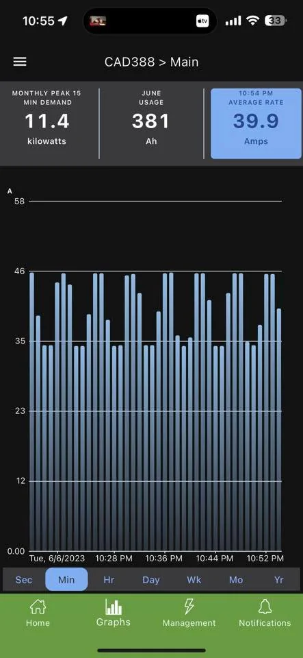

Here are the Facebook plots from earlier this month. Two different users showed similar behavior. In the red plot, the poster stated that the charge rate was set to 32 Amps.
I'm not convinced this isn't intentional, but my Grizzl-E doesn't make plots like that.
So i noticed that after 10-15 minutes of constant charging it does this. I am thinking that this must be a temp sensor issue. It may be intentional but i very much doubt it since this new protection blocks anybody charging at 48 amps. I believe they changed the sensitivity of the temp sensor on the charge port and as a side effect it caused this issue on the AC charge

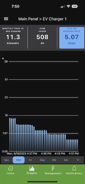

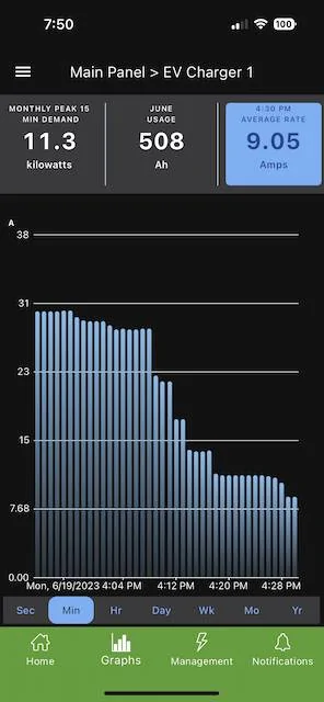

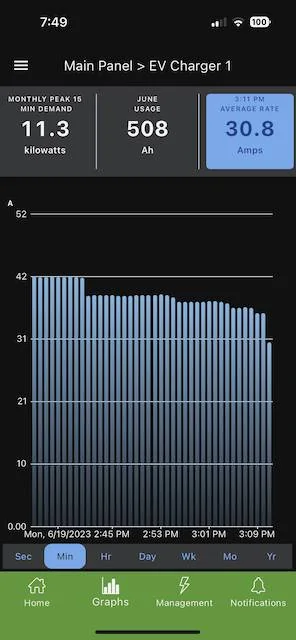

last nights session leaving charger at 40. Notice the same behavior during pre departure conditioning

It does not surprise me that charging speeds are reduced as ambient temps rise, sensors detect, and software prevents damage. I'd rather have slower charge than hardware failures.
'better' solution would require enhanced cooling plumbing around charge port, along conductors, and onward thru HVBJB under bus bars/contactors, and all the way to the batteries.

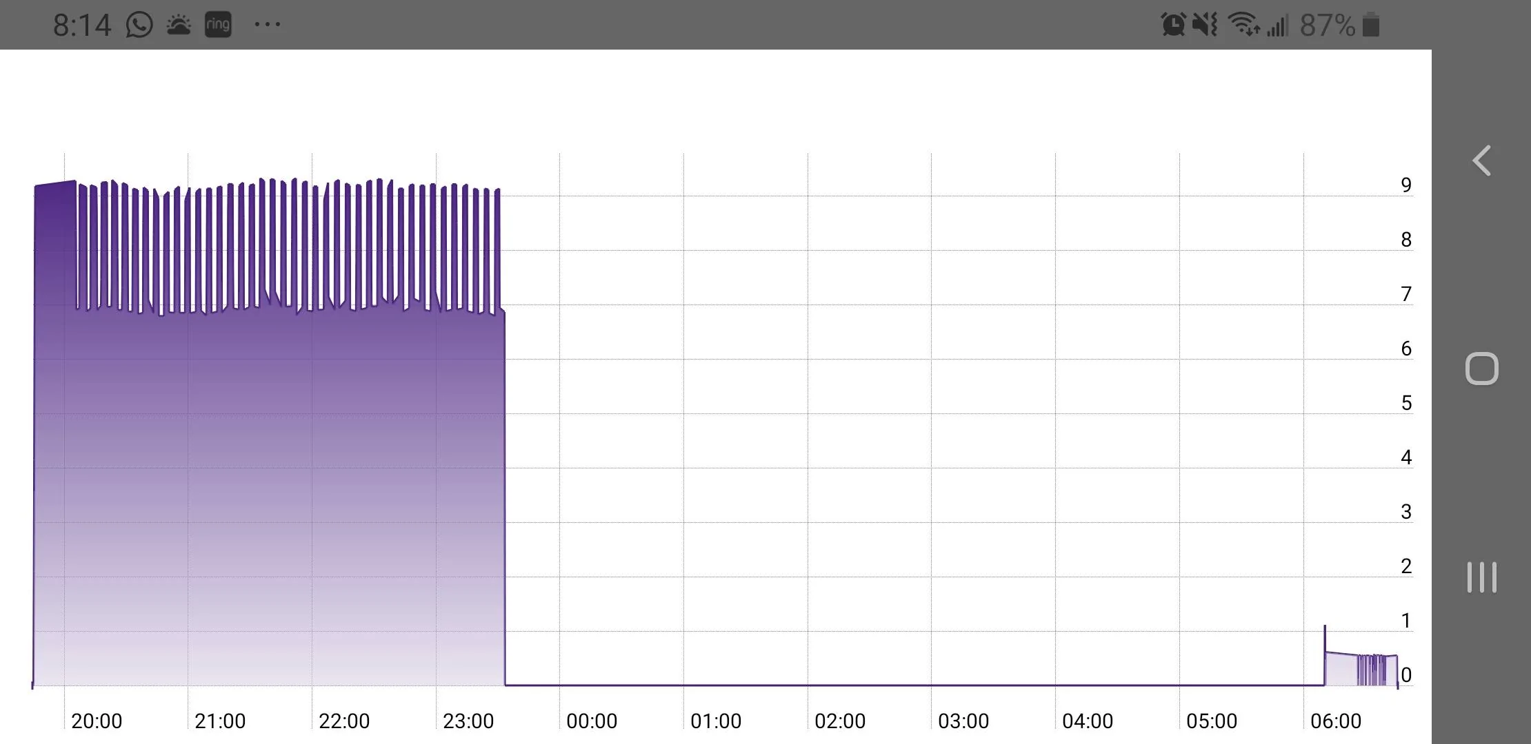

I just looked at my Emporia Charger App. I charged last night (overnight) at the same 9.5kW I always have.
I received the DC fast charging update on June 3.
I have the Emporia and still consistently 11kW reported by Emporia (10kW reported by Ford pass app).

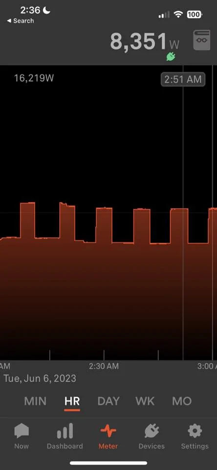

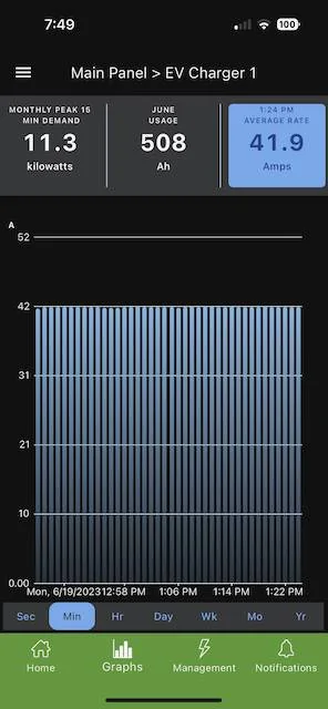

That is an interesting plot. My Emporia EV charger will vary from 2A-42A (I have max amperage at 42) because I have it set to only charge on excess solar but my graph plots are fairly smooth. As the sun goes down naturally the amperage is less.
Ford Mustang Mach-E L2 charging speed recently dropped 33% IMG_6321
Ford Mustang Mach-E L2 charging speed recently dropped 33% IMG_6322
Ford Mustang Mach-E L2 charging speed recently dropped 33% IMG_6323
Ford Mustang Mach-E L2 charging speed recently dropped 33% IMG_6324
