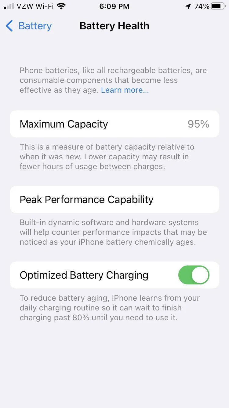

I'd be interested to seeing a comparison to any other similar(?) battery and it's daily charge schedule.
My iPhone 7 is four years old, and after charging to 100% every night Apple considers it “significantly degraded” with only 74% of original capacity.
If that occurred in our car:
  1. The SR would have a range of 156 miles after 4 years.
  2. Ford would be replacing the battery pack in every single car.
  3. The resale value once the battery is out of warranty would be zero.
