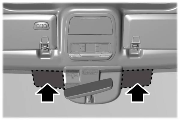

My first time crossing using my FasTrak Transponder was crossing the Bay Bridge from Oakland to SF. I placed it the same place I did on my Focus: "Under" the rear view mirror to the top-center of the windshield. I didn't get beeps, so it didn't work.
Before my next trip, I was going over the owners manual, and found the reason:
Vehicle Identification
"The device must be placed in the defined areas shown. The remainder of the windshield has a coating that prevents the device from working properly."
Ford Mustang Mach-E Clunky Transponders imagen2
My next trip using the FasTrak was crossing the Richmond bridge. I placed it on the driver's side and the beeps happened a charm. Mystery Solved!
I use a boxy transponder and will continue to use one once I get HOV paperwork cleared. I don't know how this effects the sticker transponders (less surface area an issue?).
This is not in the PDF owner's manual (first printing). Really nice to see that the online HTML manual is already being updated! I expect we'll see periodic updates of the PDF, also.
The solution you found was also discussed here: https://www.macheforum.com/site/threads/ez-pass-transponder-interference.3463/
BTW the sticker transponders work fine up there, too. Unlike with my past vehicles, I don't feel the bump texture of the frits. So they may be sandwiched in between the laminated glass layers?
