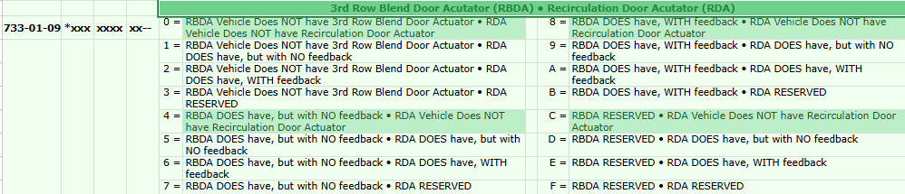

This has always been a pet-peeve of mine. I have been meaning to go into the HVAC with FORScan and disable everything that has to do with the recirculation strategies to see if it just stays on what I set it to, but I have yet to actually do it to see what happens. Part of the reason is, if you go to the FORScan spreadsheet under the HVAC and control F and search for "recirc", there are SO MANY different kinds of recirculation strategies, I don't even know where to begin in terms of disabling them.
The one thing I have seen there that may just prevent the recirc actuator from ever working is this:
My truck shows a 2 there which means no 3rd row actuator (makes sense) and it does have a recirc door actuator WITH feedback. No sure what "with feedback" means, but I have thought of going in there with FORScan and chaning it to a 0 to see if the recirc actuator just gets disabled permanently while recirc is on and just stays on.
