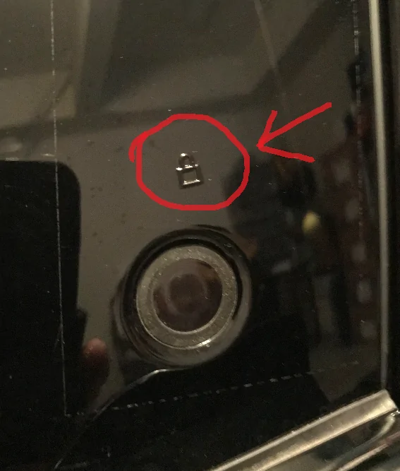

Touch and hold the lock icon (above the open circle button) for a second or so. This works on both driver side and passenger side. But it may require key to be in proximity.
Alternatively, touch and hold 7•8 and 9•0 simultaneously for a second or so. This is what I do.
Pressing the lock icon works if you have fob or PAAK-enabled phone on you.
Touch and hold 7•8 and 9•0 simultaneously works without fob/PAAK.
pp 76-77
I vaguely remember reading that some where. Thank you for the definite reference.
That difference sounds ... stupid. Why would a key be required to lock the car in one case but not the other. Well, maybe it makes sense, if you use the keypad, you likely know the key sequence for opening the door, so accidental lock out is less of an issue.
PaaK works pretty well for me (except that it doesn't detect the phone in the driver seat when it's in my pocket. But it's a nice reminder that I put it on the charging pad, so not a big negative). But it's not 100%. So I use 7•8 and 9•0 for locking the car.
