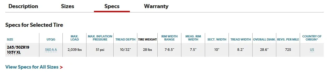

Here is a dumb question - I don't know anything about modifications
It looks like you have installed 245 width tires on the stock wheels/rims(which comes with 225 width tires from factory)
I am thinking that it is not possible(they will not even fit). Am I wrong..
Will doing such thing void the warranty ? thanks
It won't void the warranty.
The factory wheels will typically fit multiple-size tires.
A good reference is Tire Rack. I have attached the specs notice that the 245/50/19 will fit 7-8.5" rims. The MME factory 19" wheel is 7" wide.
Changing wheels and tires it's important to get everything right if you are not an expert go to someone who is can't go wrong with Tire Rack or Discount Tire
Ford Mustang Mach-E Continental DWS 06 Plus 245/50/19 installed and performance results Screenshot 2022-08-10 112935

followup please, I really would like to change the wheels on my mach E (scheduled Sep/12).
It is just simply replacing the tires or, do they need to do extra work of aligning the brakes/sensors etc etc
When I changed my tires with the Continentals DWS 245-50-19, they didn't do any adjustments. Still same rims. If you change rims, now you need to be aware of offset and brake clearances
If you're going from a 225/55/19 factory size to a 245/50/19 you can just change the tires. No other modifications are needed. I would put some miles on the car before you do this and have a good idea of what you want to change in the way the car rides.
