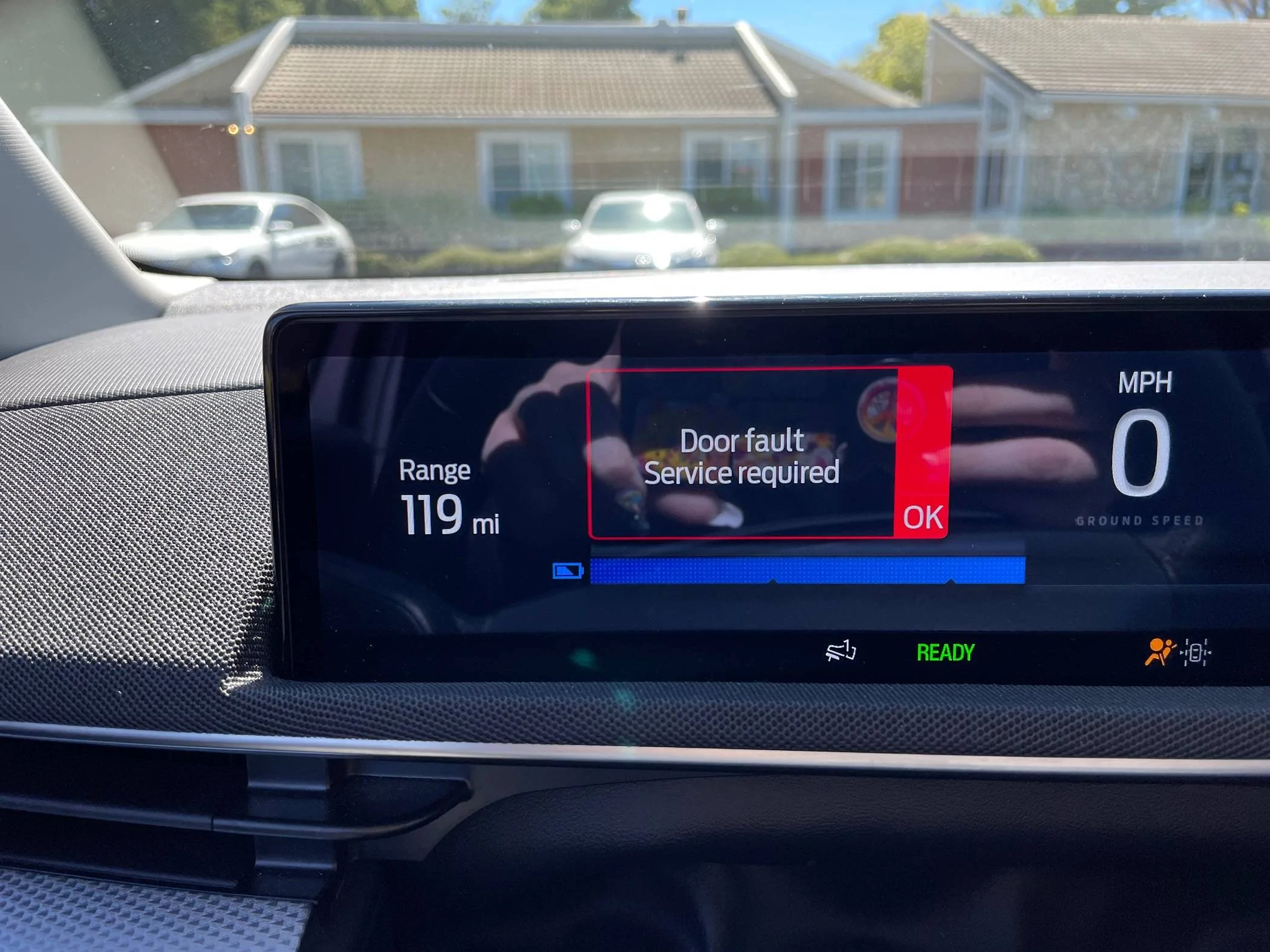

I have the same exact issue with my ‘22 Mach E right now. “Door fault, service required.” I already scheduled an appt at my local Ford dealership. Please provide any further suggestions about this issue?
- Monica
Ford Mustang Mach-E Continuing Door Fault and other errors IMG_9690
Ford Mustang Mach-E Continuing Door Fault and other errors IMG_9656
