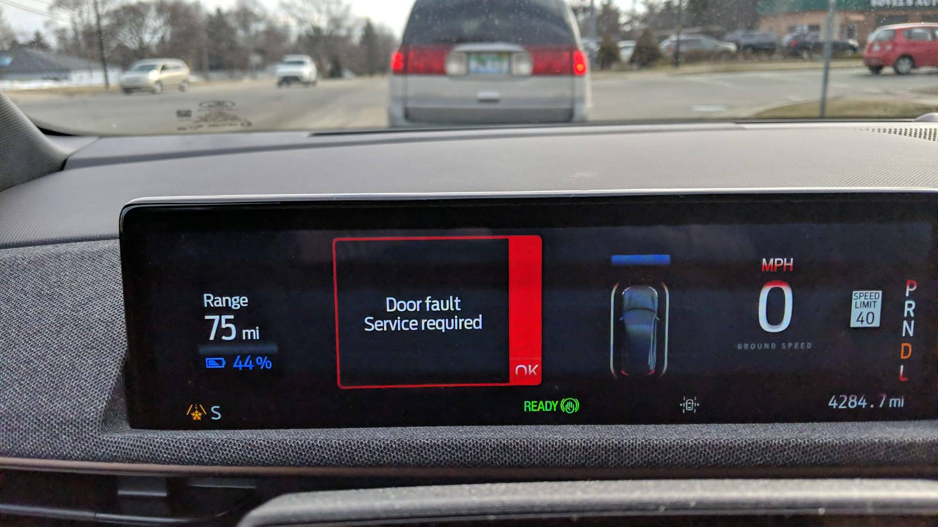

Anyone seen this error msg before and is there a fix that don’t include going to the dealer because dealer said they need at least one day just to diagnose

Clear it and see if it returns. Often these things are there one day and gone the next.

It’s been doing that since Sunday every time I clear it it come back when I restart the car

That is critical information to include in a post. I think the car is right. Take it to the dealer.

UPDATE: the dealer said I need a actuator,they going to order it and I need a new door speaker and tweeter

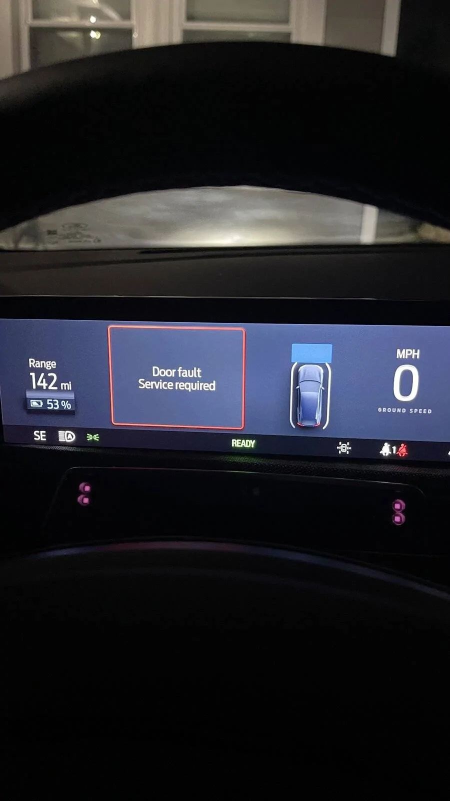

I started getting this today as well. Will clear and see if it returns. Any one else have this issue, please enlighten us. Thanks.

Yes, the OP said: "UPDATE: the dealer said I need a actuator,they going to order it and I need a new door speaker and tweeter"

they had to change 2 modules to fix the problem when I had the issue

I've started with this a week ago following an overnight update.
I can cope with the annoyance each time I turn the engine on, but I'm also getting other issues i.e. hill assist not working.
I'm hesitant to take it to a dealer as there are very few here that can diagnose / fix the e-fleets, the nearest one is miles away, and last time it went in for an issue with the charging module, which ended up being replaced, they had it 7 weeks with no courtesy car available! ?
