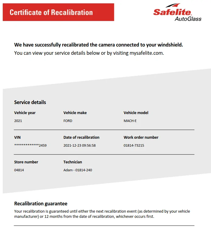

I understand that recalibration is required after replacement of the windshield. I will have my windshield replaced at Safelight and then take it to Ford for the Panoramic Roof and Windshield recalls one week later. Is it reasonably safe to forego the recalibration at Safelight with the expectation that the dealership will do the recalibration? P&T.
Safelite was able to perform the calibration. Or at least they claimed they did it. I got a certificate in the mail for my records. Might all be BS but at least I have documentation in case I ever need it for any reason. (I highly doubt I will ever need it though....)

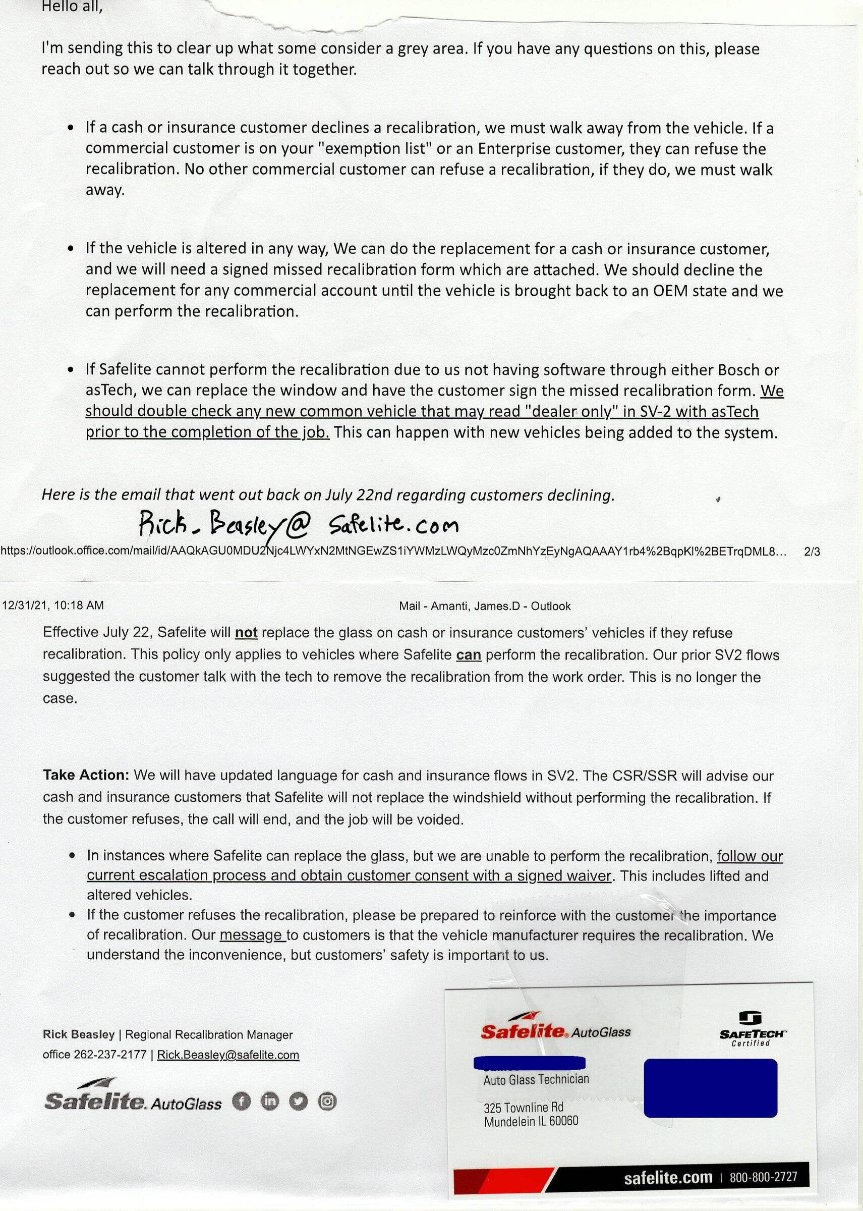

Thanks for replying but there really doesn't appear to be a source that directly states recalibration is not required. It's somewhat moot if you're using Safelight because they mandate recalibration. If one refuses recalibration, they won't replace the windshield, period. It just doesn't make sense to have them do it and then have Ford redo it the following week. We don't want to unsettle the "Regional Calibration Managers."
The Ford Workshop Manual section 501-11 has instructions for removal and installation of the fixed glass (which includes the windshield). Step 21 is the calibration step for the Imaging Processing Module A.
I would expect a glass shop to follow Ford's instructions and perform the alignment procedure if possible. That being said, it doesn't mean the system won't still work if the alignment step isn't performed. It probably will......but Ford says to do it so most will follow the instructions.
