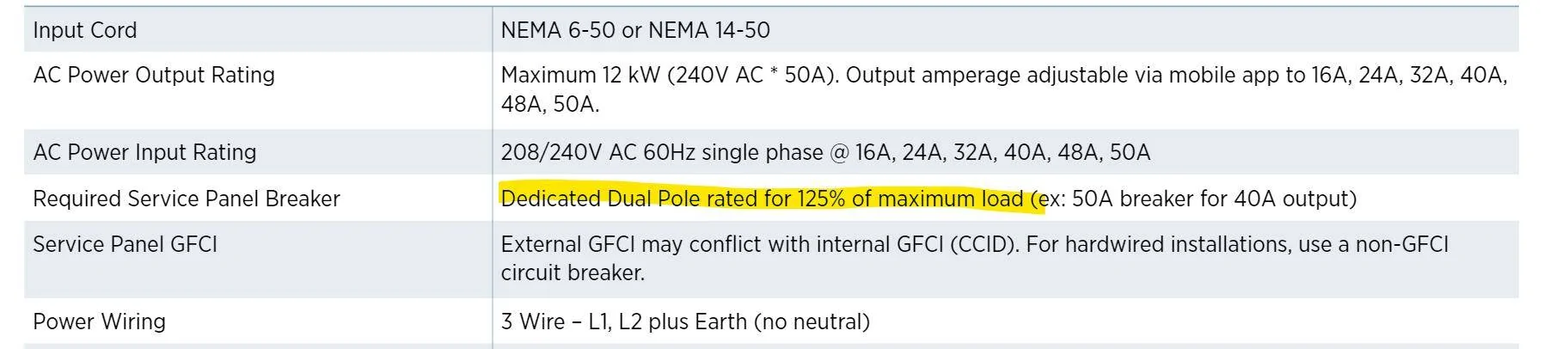

If that is the ChargePoint Home Flex (CPH50), you can adjust the output to match the circuit you plug into.
You can, but you need WiFi & Bluetooth connectivity for that.

Doesn't the CharePoint Home Flex max out at 50A charging? Shouldn't you limit the EVSE to 40A when hooked to a 50A outlet?
The outlet isn't that important. The wire is the most important part of the circuit, so the first order of business is to make sure the wire is sized for the EVSE. The next most important part of the circuit is the breaker which protects against the wire overheating and protects the EVSE.
The outlet is the least important part of the circuit and traditionally hasn't been an issue. Unfortunately the build quality has become very low -- a 14-50 outlet might not be able to support a constant draw of 32A. To address this problem the building code now requires a GFCI breaker which will detect a failing outlet and shut off the circuit before the failing outlet causes any damage.
Bottom line is if the wire and breaker are sized correctly, and the breaker is per code a GFCI breaker, you can have a 6-30 or a 14-50. (It's also why you don't need a GFCI breaker if you hardwire the EVSE).
