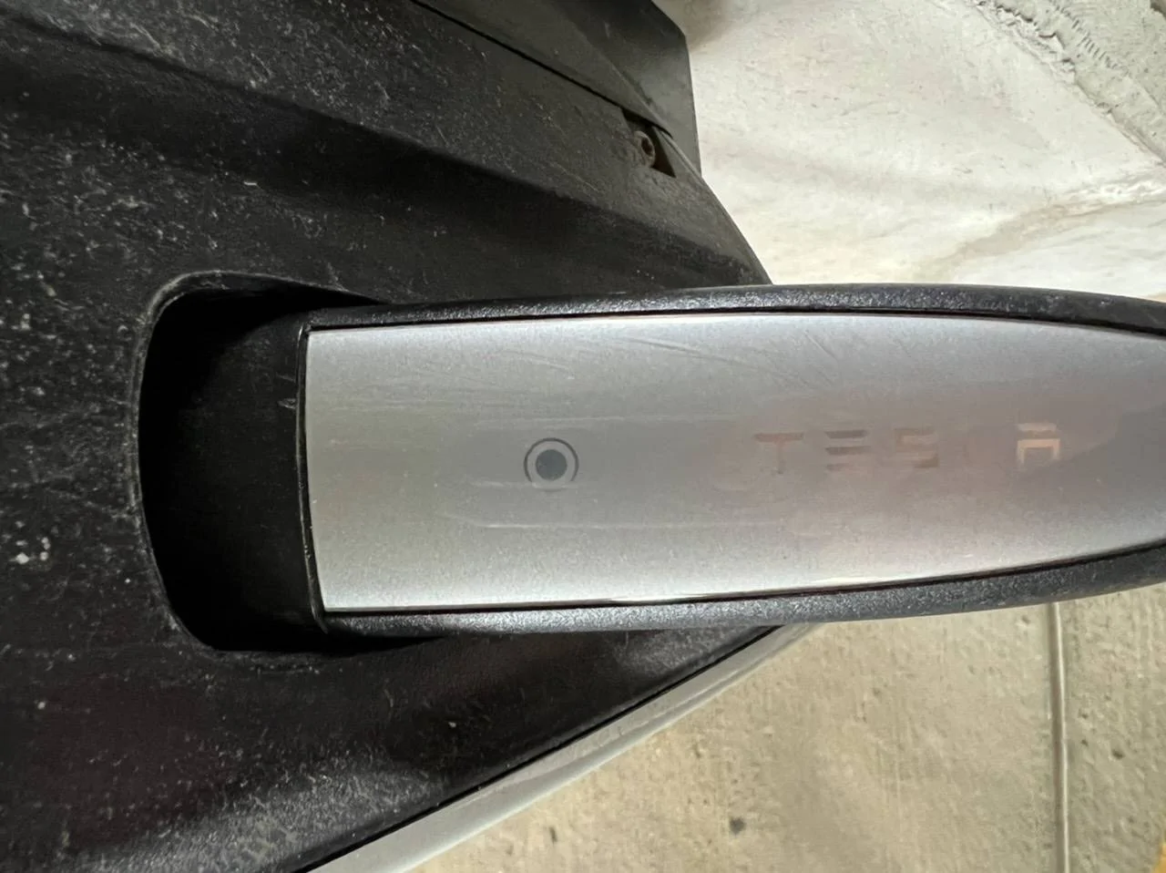

Does this button have any function when charging a Mach e using the TeslaTap? I can press it and it makes a click. Or is it only for charging a Tesla?

The Tesla cable end goes into the TeslaTap. So it’s the inside surface of the TeslaTap that needs some lubrication (or the outside of the Tesla charging cable end).
What’s that thing on the Tesla charger handle that looks like a button one would press?
It's a release button.
