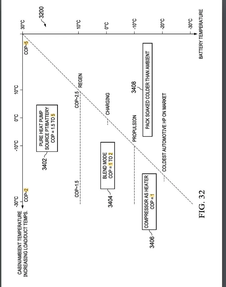

The Y has a battery that is 75 kwh compared to the 88 or 91 in the Mach e. So the Y did 2.26 mi/kWh at 16F and the Mach E did 1.93 mi/kWh. Correct, a 38% loss of each. In the summer, Y did 3.63 mi/kWh where the Mach E did 3.11.
The heat pump Tesla uses May have a 1:1 performance at 16F. The reviews I have seen touting the Tesla heat pump seem to all be at 35-45F, which this tells us why.
As noted above, if it was 25-45 ambient, there more than likely would have been a difference, but in reality that difference is 10-20 miles.
Is that worth the expense, complexity and weight? IDK.
Here is the Tesla heat pump efficiency curve from their Patent.

So much for that vaunted heat pump.
That was my first reaction when seeing the numbers as well. I've always suspected this was the case. Lots of added complexity for little gain.

The Mach-E is less efficient in all climate conditions - but the range loss due to this cold test is the same for both, at the very least leading the reader to believe heat pump/Tesla is not a huge benefit over other manufacturers.
I probably wouldn’t see any benefit because with preconditioning and being garage kept my heat barely ever turns on to warm up the car even when it’s cold. All the numbers match up from what I’ve experienced.

Sure: the math is clear - the Model Y is more efficient with its electricity usage. That's the tradeoff for being ugly. But the market has spoken, at least for now, efficiency is not what it cares about -- it cares about range, and the Tesla heat pump doesn't give it an advantage in real world testing.
