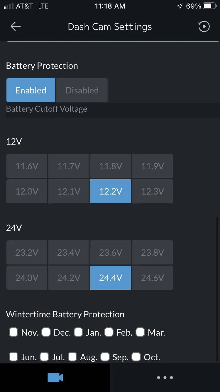

Hey guys,
I just installed my Thinkware Dash Cam using the OBD port and I was wondering what settings should I put here for the voltage cutoff?
Ford Mustang Mach-E Dash Cam Battery Cutoff Voltage Settings IMG_0949
The values here are the default ones.

12.2 or 12.3 are best for the batteries lifespan.

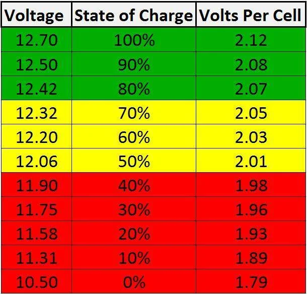

As for the OPs question, I have my physical cutoff device set to 12.5 and it cuts off 90% of the time. I need to do some testing on the battery to see where it likes to be and adjust accordingly. Here's the chart for battery health.
