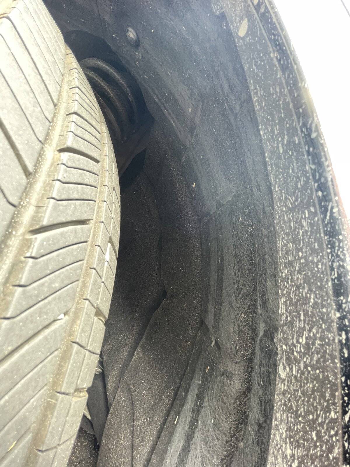

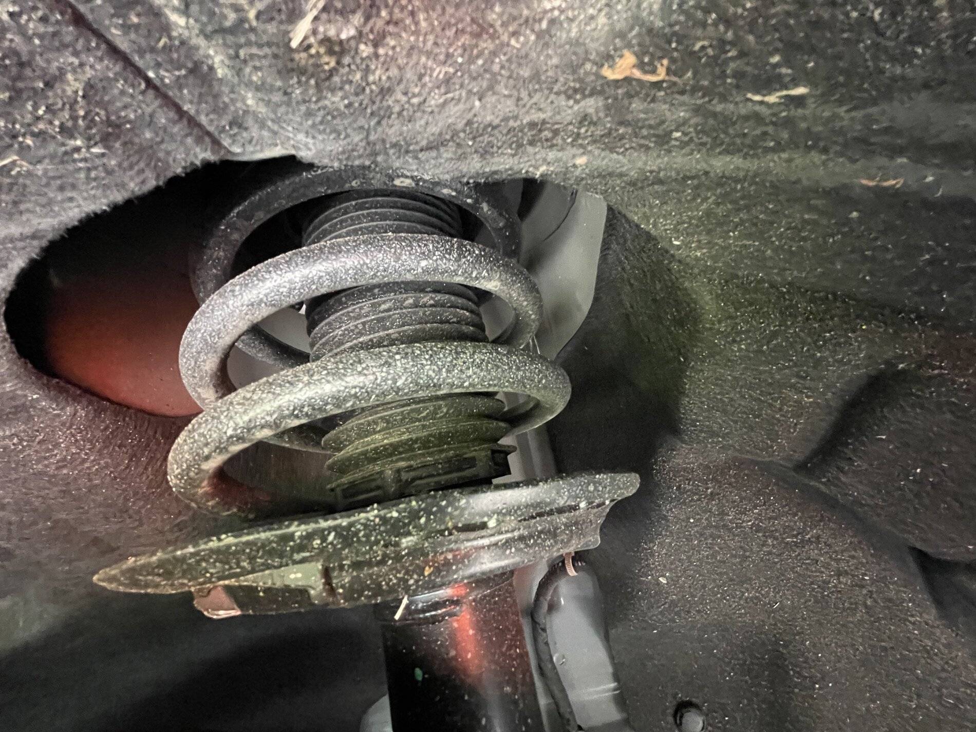

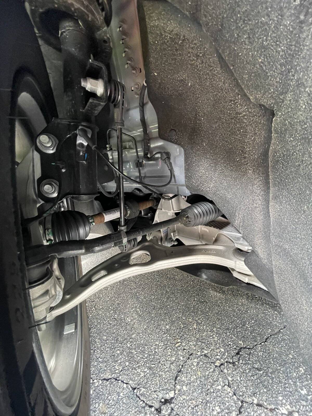

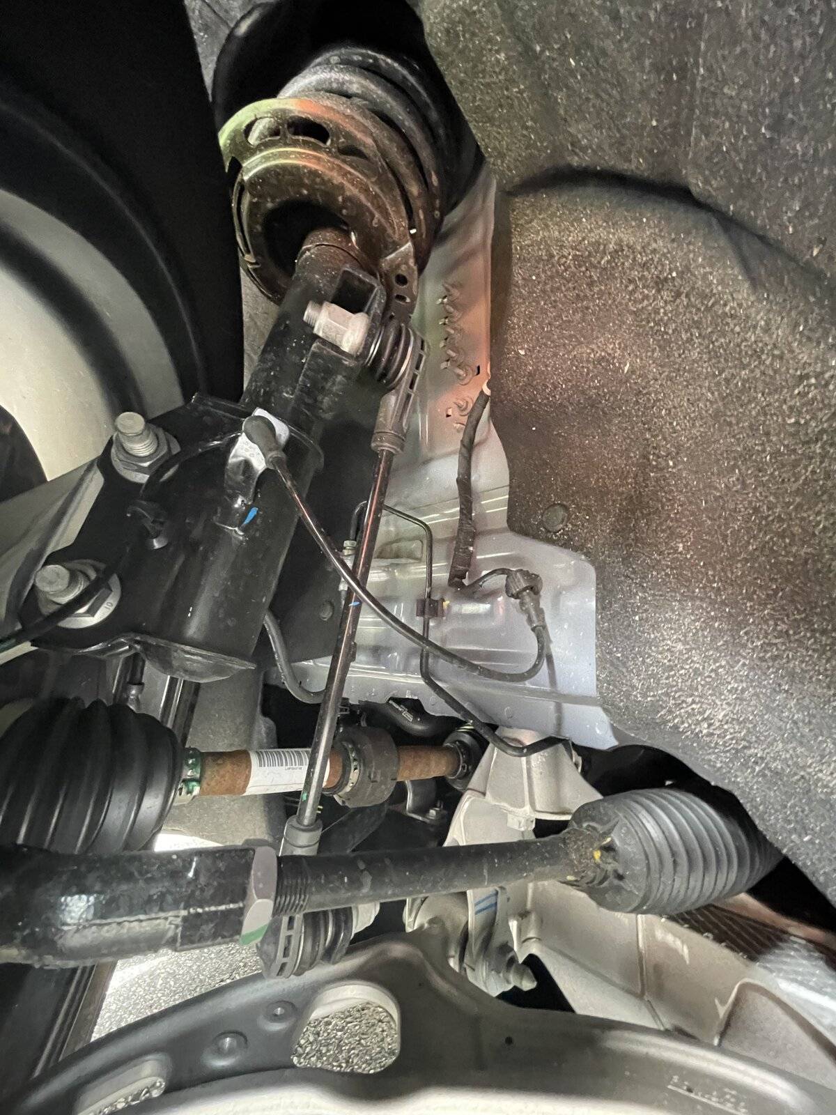

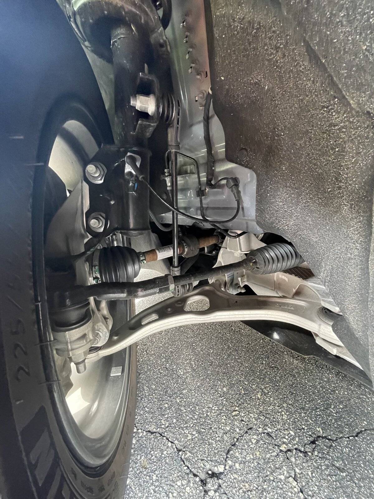

Check and see if your tire appears to be wearing evenly
Tire appears to be even, the cars only 3 months old though.
Other possibilities are bad strut shock....check for signs of leaking and lastly, look for missing plastic fasteners for the inner wheel well and under body panels.
I looked in the wheel well, and I’ll admit I have no idea what normal looks like, but nothing was obviously wrong. See pics.
Perhaps the shipping blocks were left in the coil spring on the drivers side?
Checked, didn’t see them.
I'll bet the MME floor pan is ambidextrous and there is a similar filler under the carpet.
I actually discovered the dead pedal is just a piece of trim that’s held on by 3 clips. So I removed it and checked underneath. Find some electrical connections, but nothing obviously wrong. Re-seated the clips, so maybe that will help.
here are some pics of inside the wheel, shout if you see something I missed ?

On FWD and IRS cars a torn CV joint cover will sometimes make some noise at it flaps around, but yours seem OK.

Thanks for the pics inside the wheel wells, I was surprised to see the sway bar link so long and attaching high up on the strut versus the lower control arm.
