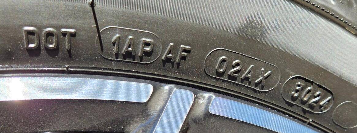

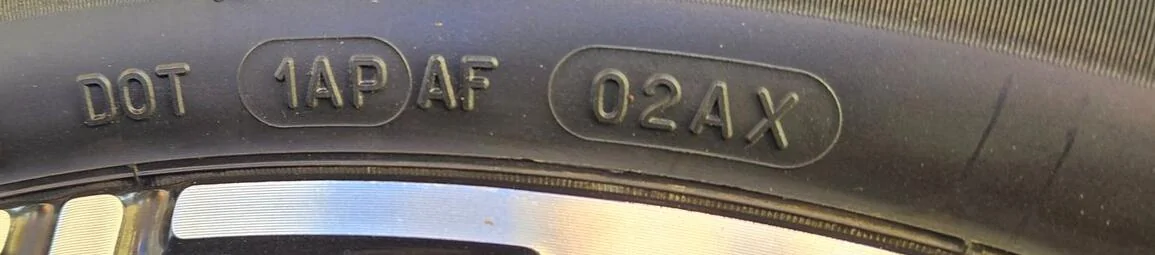

Registered my tires with Michelin. The DOT Codes are:
1AP AF 02AX 3024
1AP AF 02AX 3024
1AP AF 02AX
1AP AF 02AX
No idea what these codes mean and why 2 of the tires don't have the 3024.
Anybody know what these codes mean and if it's OK that they are different?

The codes show where the tires were built and when. The last four are the week they were manufactured and then the year so week 30 of 2024
Tires have an inside and an outside. The full date code ( the print showing 3024) typically should show on the part of the tire to be installed on the outside. That could be what's causing you issue (maybe) if the CC2 was designed to be installed a certain direction. My Quatrac Pro+ say inside and the sidwlewall is much more basic on the part to be installed on the inside.
On a side note this/ last year we had some week 53 of 2023 tires build

I registered my CC2s just after purchasing them (and just got the $60 gift card in the mail too) and had the exact same thing, with only two tires having those last four digits. As has been said, these are directional tires so if they are only printed on one particular side I guess we wouldn’t see two of them, unless we looked at the side facing the interior. Hard to do unless you want to crawl under or lift.
Good luck sorting this out. They might have to take it for a ride to reproduce the vibration if it doesn’t show up in the re-balancing.
