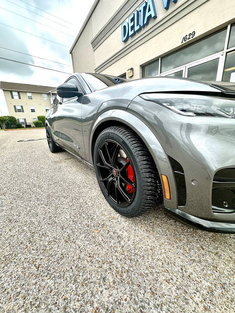

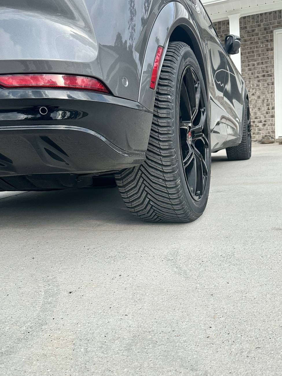

I’ve been running the CC2’s from day one and I’m at 9000 miles. It’s the best set of tires I’ve ever owned and they really look good.
Ford Mustang Mach-E Michelin CrossClimate2 - vibration at 37mph - 47mph? IMG_7705
Ford Mustang Mach-E Michelin CrossClimate2 - vibration at 37mph - 47mph? IMG_7702
