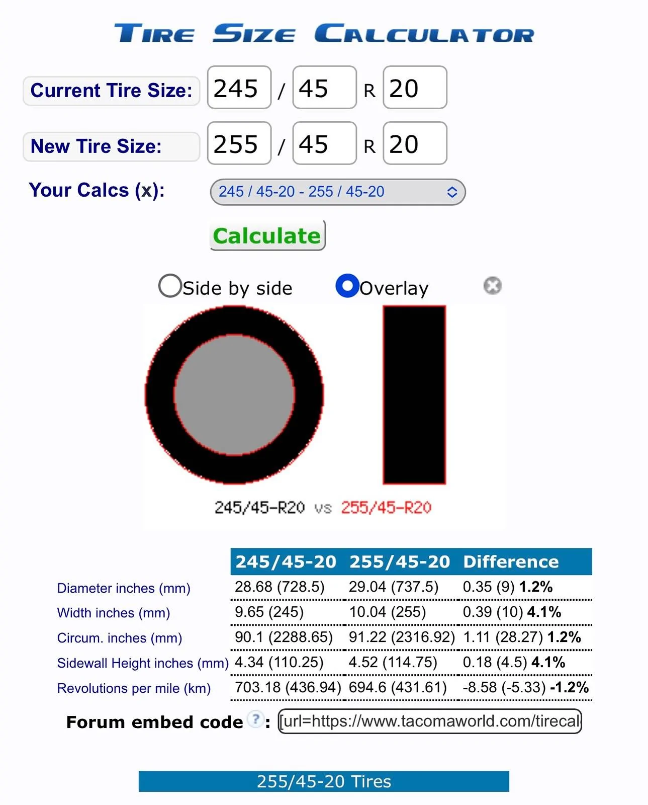

I’m Having the Mich CC2’s I mounted this week. I’m replacing the stock Continentals. The Michelin’s are gonna be 255’s instead of the 245’s, so I’m hoping the slightly taller tire changes nothing. Everything I’ve read about taller tires once moving are more efficient on the road. I know they’ll be slightly wider so that may just negate everything i’m thinking, but doesn’t matter, I don’t need them for efficiency because I just drive around town Mostly. Could throw the speedometer off very slightly, maybe a mile or two difference .
I have 255s (Hankooks) on my GT and the there was a bigger speed difference than I expected. With the OEM 245s, when the speedometer said 80, I was going 79. Now when the speedometer says 79, I am usually going 80 but it flips between 80 and 79, so I am guessing it's off by 0.5-0.75 mph at 79 mph.
It's a big change to flip from slower than speedometer to faster than speedometer, as I like to ride the edge between speeding ticket and not.
Sorry for the naive question but just curious— how do you objectively measure your speed accurately and precisely, while driving, to get those numbers?
Jerrytball
Jerry
Feb 21, 2024
2,152
1,136
Gulfport MS
2026 bmw i4 M50
this website where you compare different size tires you can see they tell you the percentage of your speed difference in the two different tires size.
