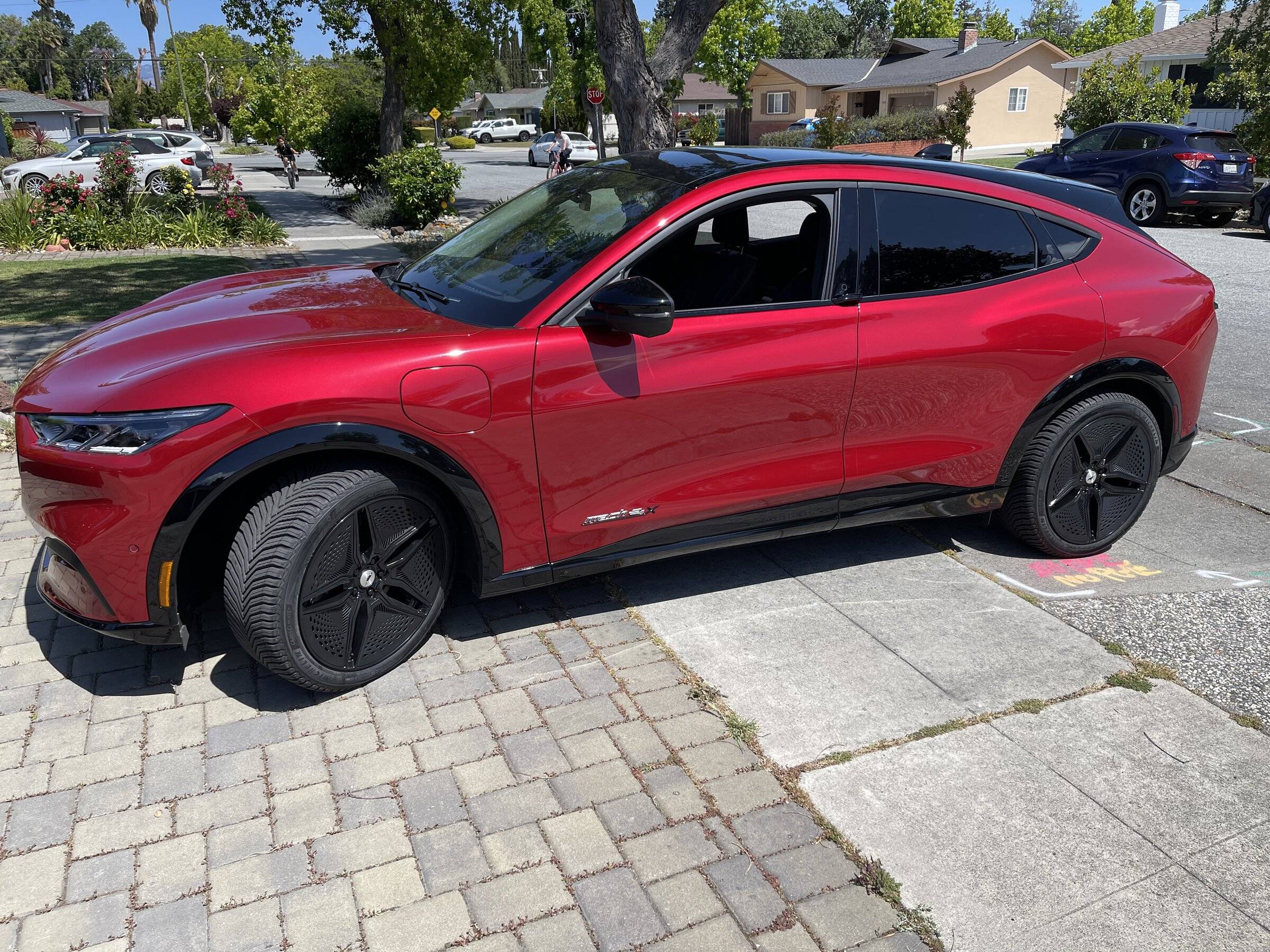

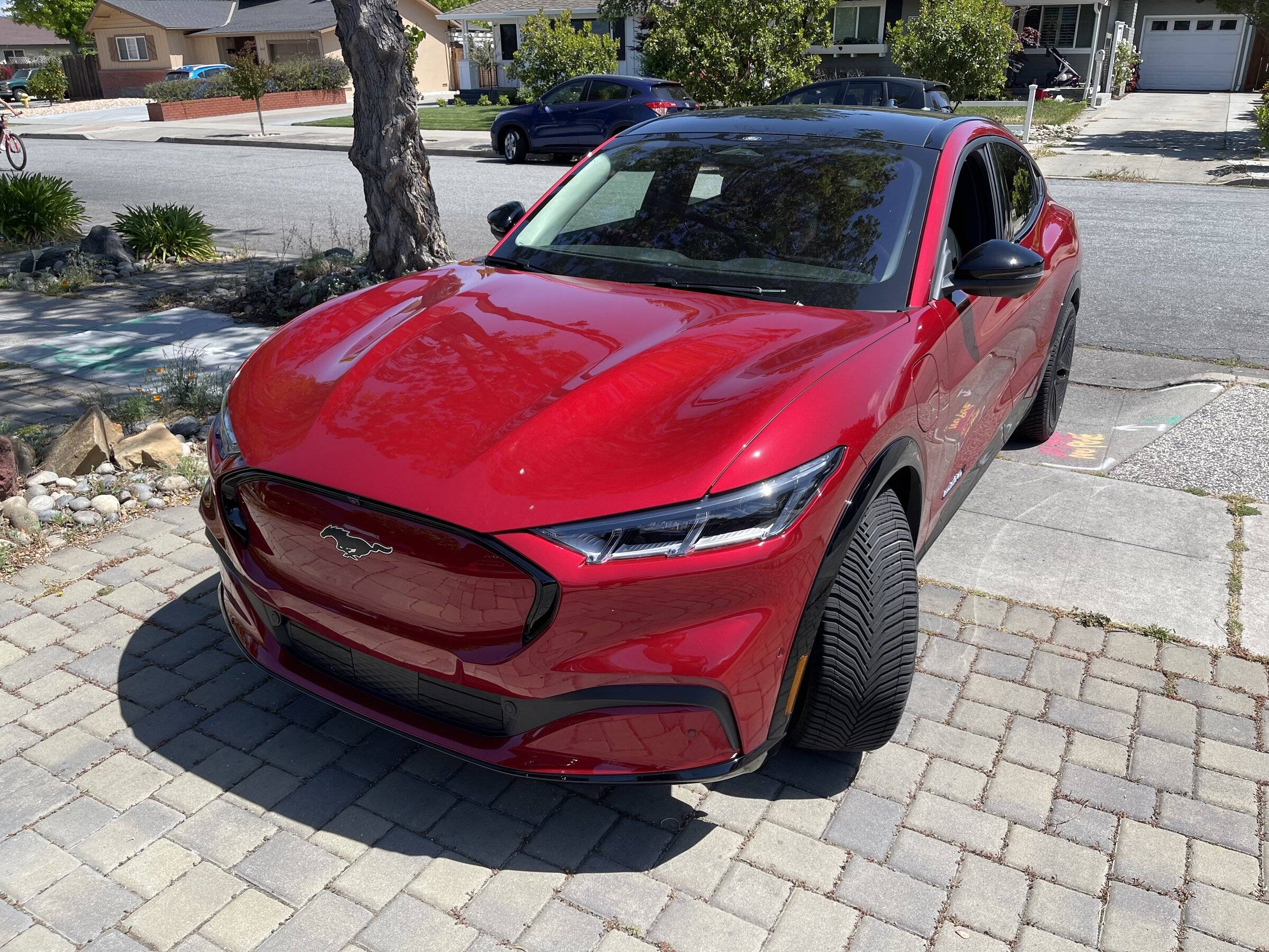

I like them. The 245/45/r20 9” wide. add to the width Nicely flush with side of car. .no major impact on Efficiency
Ford Mustang Mach-E Anyone running on Michelin CrossClimate2? 28A6BBC4-B386-47AB-881C-BC7D5A4F2DA0
Ford Mustang Mach-E Anyone running on Michelin CrossClimate2? 37C88FD4-2E99-491D-B5F8-AE68F4809B93

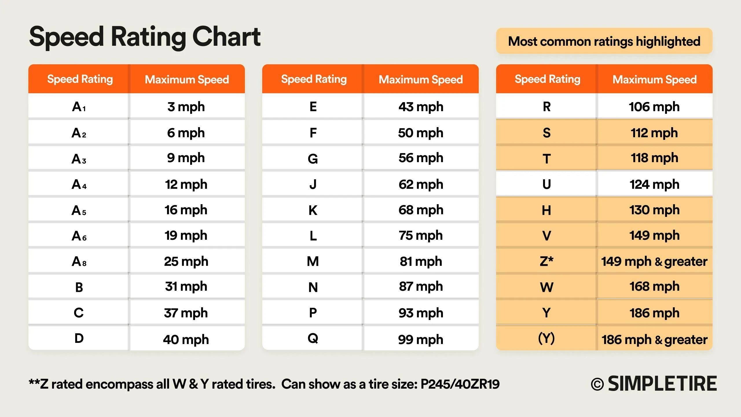

I ordered these through Costco based on really good reviews from the Forum members but since we have a GT with the PE package, Costco refused to install the tires since our car came from the factory with "Y" rated tires. They could only drop 1 speed rating based on their corporate policy.
I argued that the GT (without the package) comes with V rated tires but they would not have it. Seems ridiculous as you would never run anywhere near the rated max speed and I doubt that the GT would even come close to 186MPH?!? LOL....

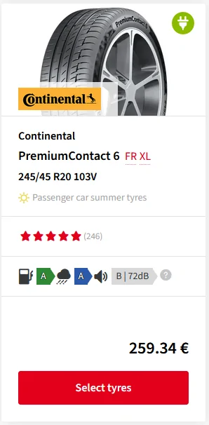

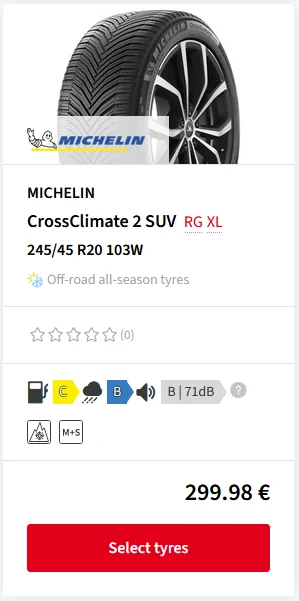

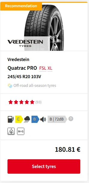

Speed ratings should not be called speed ratings. They should be called performance ratings. I remember reading for my old 1993 Mustang the difference between a H rated and V rated tire in stopping distance was 20 feet. BTW that is one step if you look at your chart. The rating is just speed but to build a tire that will handle the higher speed it's built better and will also affect cornering/handling and stopping. Indeed there probably is not a huge difference but there is a difference. Get an all-weather that has the right rating. After all, you bought a GTPE for the PE.
If you dead set on the CC2 see if they will let you do a 255/45/20 105W XL inflate to 36psi, I have the Wintrac Pro in that size and rating
