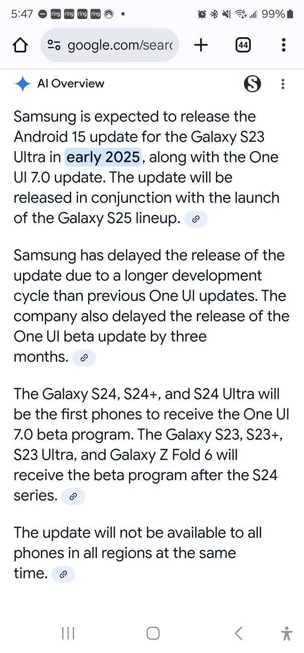

I decided to Google when samsung will release android 15 to S23s and this is what the google AI answered. Felt like Ford and its "soon" statements lol.
Thoughtful. Backend. Process.
I heard probably Feb., after the S25 phones are released. There will only be beta for S24 phones.
