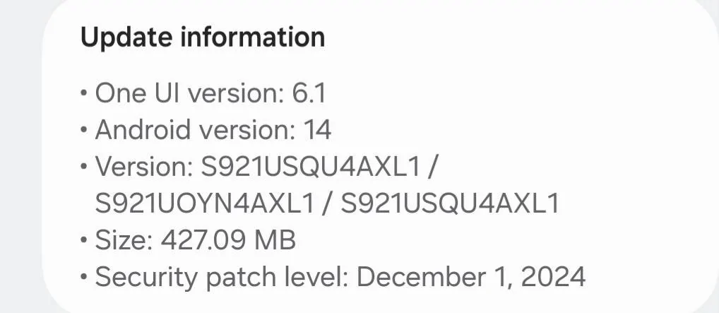

I just received an update this morning on my phone. Can it be that its fixed?

Haven't seen an update on my Samsung since 12/14/24. What phone and what software update?
It's strange the update is from today 12/23/24 at 9:45 am but it's says its the Dec 1 security update.
Google releases a monthly security update. December 1 is when that was released. Then Samsung has to prepare it and and it out to the phones. The phones only check every so often for a new update unless you manually check sooner, so not everyone gets it at the same time.
I cant explain it when I got my update this month I lost the ability to use my PAAK and it's been weeks i posted here on Dec 13 that, it was not working and that was after a few days working with Ford and on my own trying to get it to work again. It's one of those things.
If there is a fix from Samsung, the December 1 date likely won't change but the version will "AXL1" will be something else (unless you got the fix and the previous December update has a different version)
