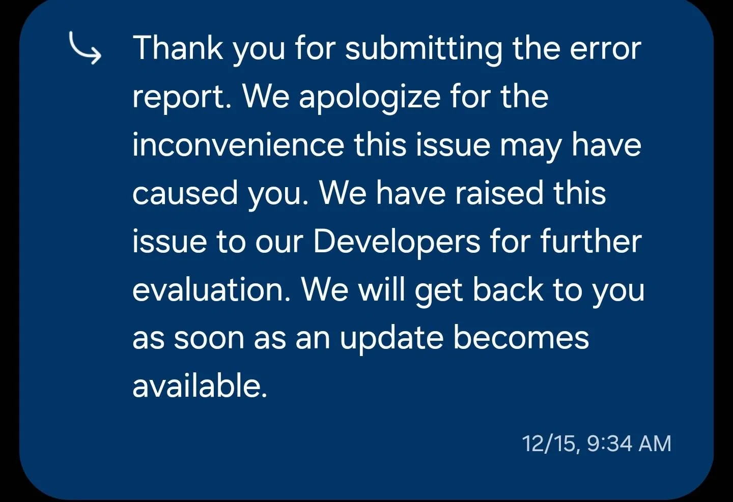

I sent Samsung a full bug report and got this update this morning
Ford Mustang Mach-E Dec '24 Android Update - Bluetooth Connection Problems Screenshot_20241215_165855_Samsung Members

Fantastic. Thank you for taking the lead and submitting the bug report for the rest of us.
Thank you. Unfortunately, my experience with Samsung means this isn't getting fixed anytime soon, if ever, if it's their issue.
