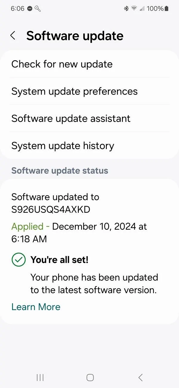

Is anyone with a S24 running the One UI 7 beta? Does it have the December update? Any issues with PAAK?

Saw this thread linked on the Lightning forum as a PSA. My Verizon S23U got the Dec security update yesterday and the PAAK worked fine on my Lightning earlier today. I am on Fordpass 5.10 beta. I wonder if the update didn't impact my phone model or maybe it doesn't impact the Lightning.

Seems to be specific to a Samsung security patch, pushed to newer models.
