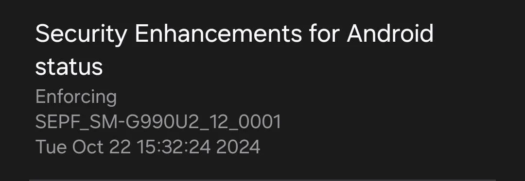

Yeah, I'm an older model Samsung and the current security patch is back in October.
PAAK is functioning just fine
