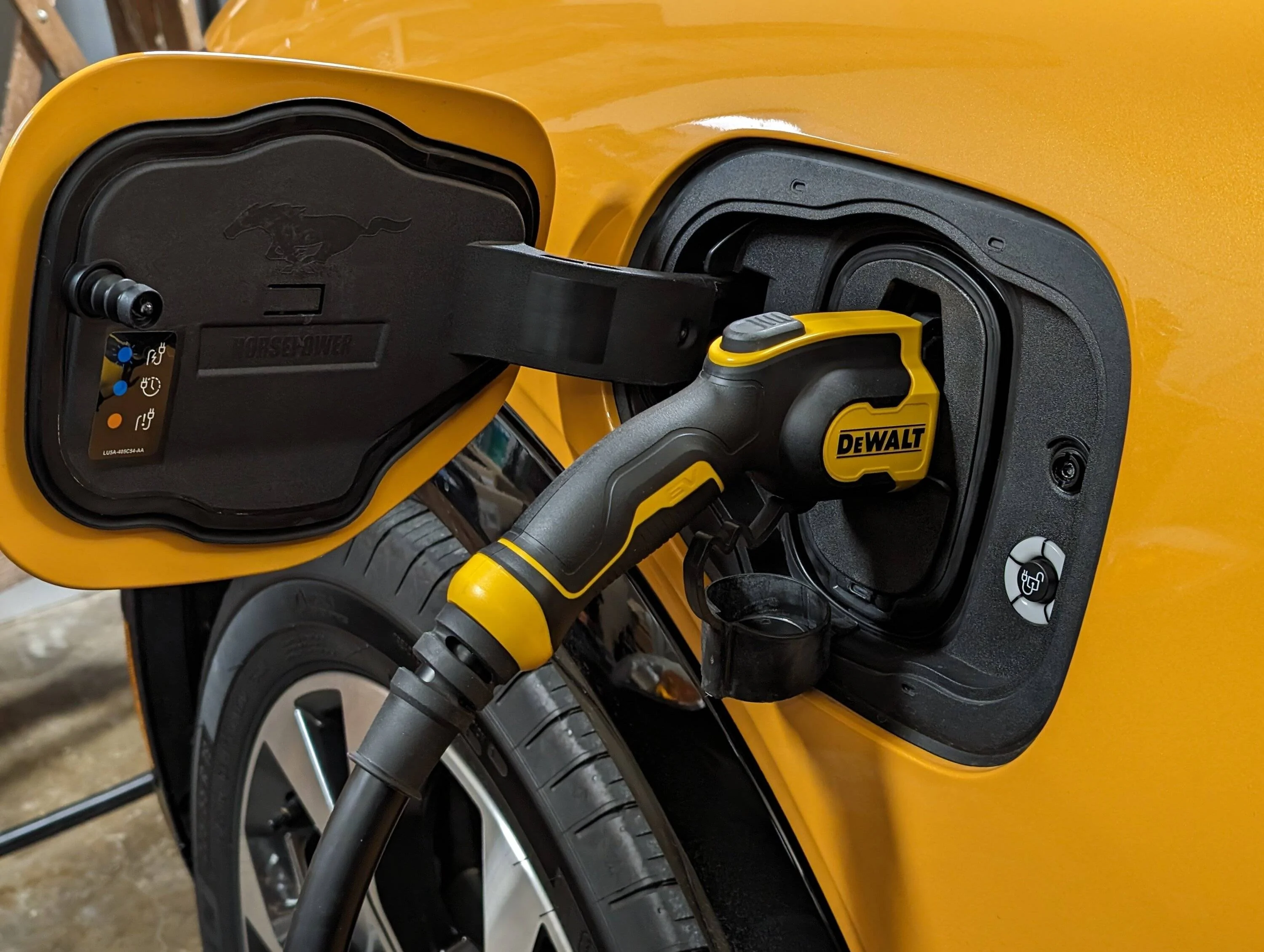

I was wondering how long until a yellow Mach-E had to get the DeWalt charger to match...

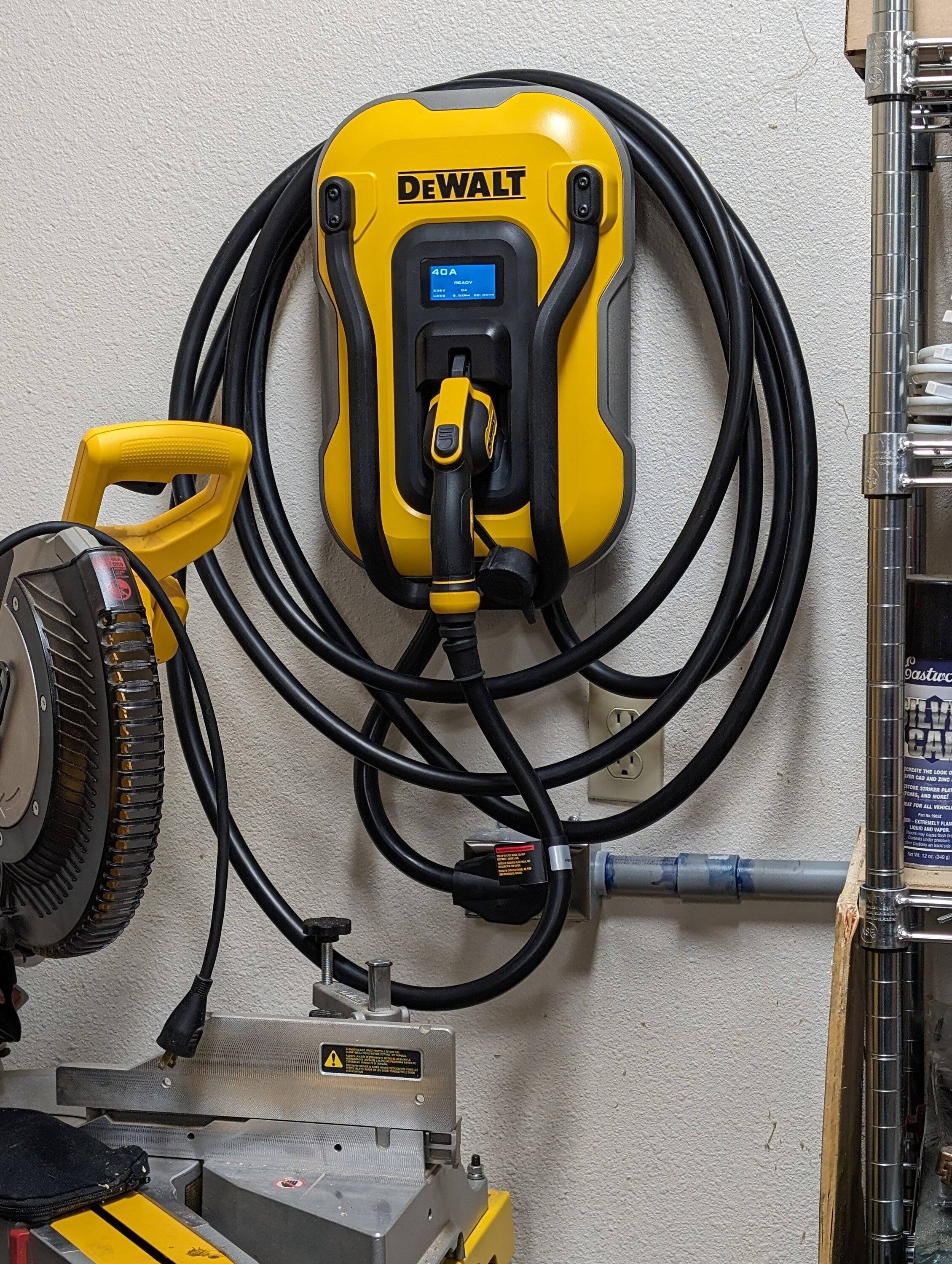

Based on the outlet box size, you didn't use a heavy duty EV rated 14-50 outlet similar to this one https://www.hubbell.com/bryant/en/P...vices/Industrial-Receptacles/9450FR/p/1636788 which only fits in a dual oversized box.
This outlet and cover are available from Amazon https://www.amazon.com/Bryant-Electric-9450FR-Straight-Receptacle/dp/B003A2R9RM
This video shows what could happen when you use cheap outlets from L or HD
If you can hard wire this EVSE and get rid of the plug and outlet, that's the safest installation.

I appreciate your input, but I'm renting and this is what the landlord provided. I'll send him your comments, though!

That's one heavy duty looking unit.
One option that will significantly reduce risk of fire is to reduce the DeWalt's maximum average, say to 24 or 30 amps for example.
