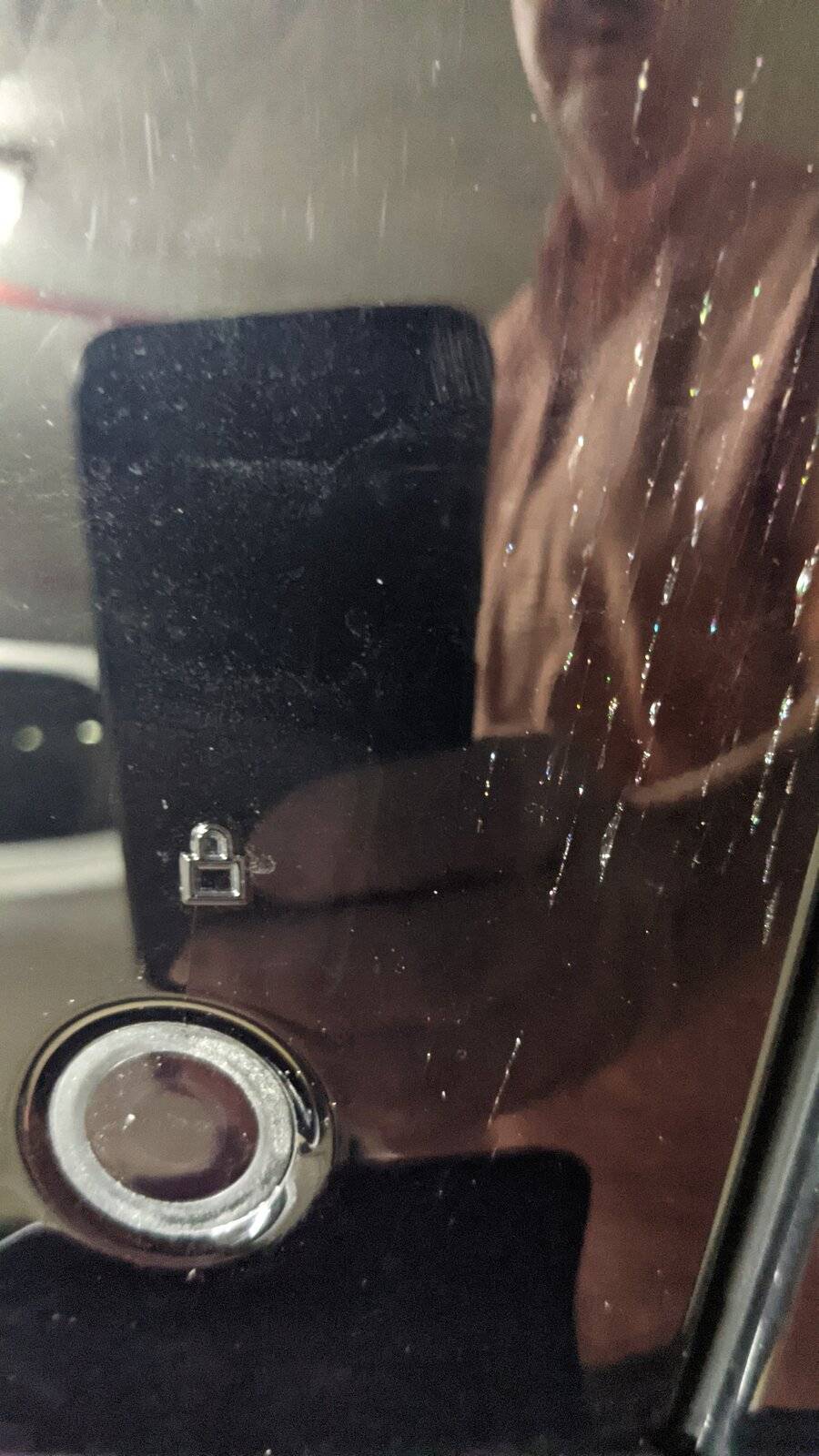

Door lock crack.
bballpirate
Apr 17, 2021
50
61
Texas
Mustang Mach-E
I know there have been posts about this before saying it is not a crack but it looks like I actually have a crack. Anybody else have this issue? Looks like I can add this to the list of issues including the glass recalls, Paak and L2 charging noise updates I need and my stuck sync update.

I have seen hairline cracks on every Mach-E that I have inspected for that condition. Maybe 8 or 10 cars? Must be a manufacturing or assembly fault.

I was going to say that I had not noticed one on mine, which is true, but when I zoomed in on my phone, I see a very faint crack. I assume it would get worse over time, I only have 3,600 miles so far.

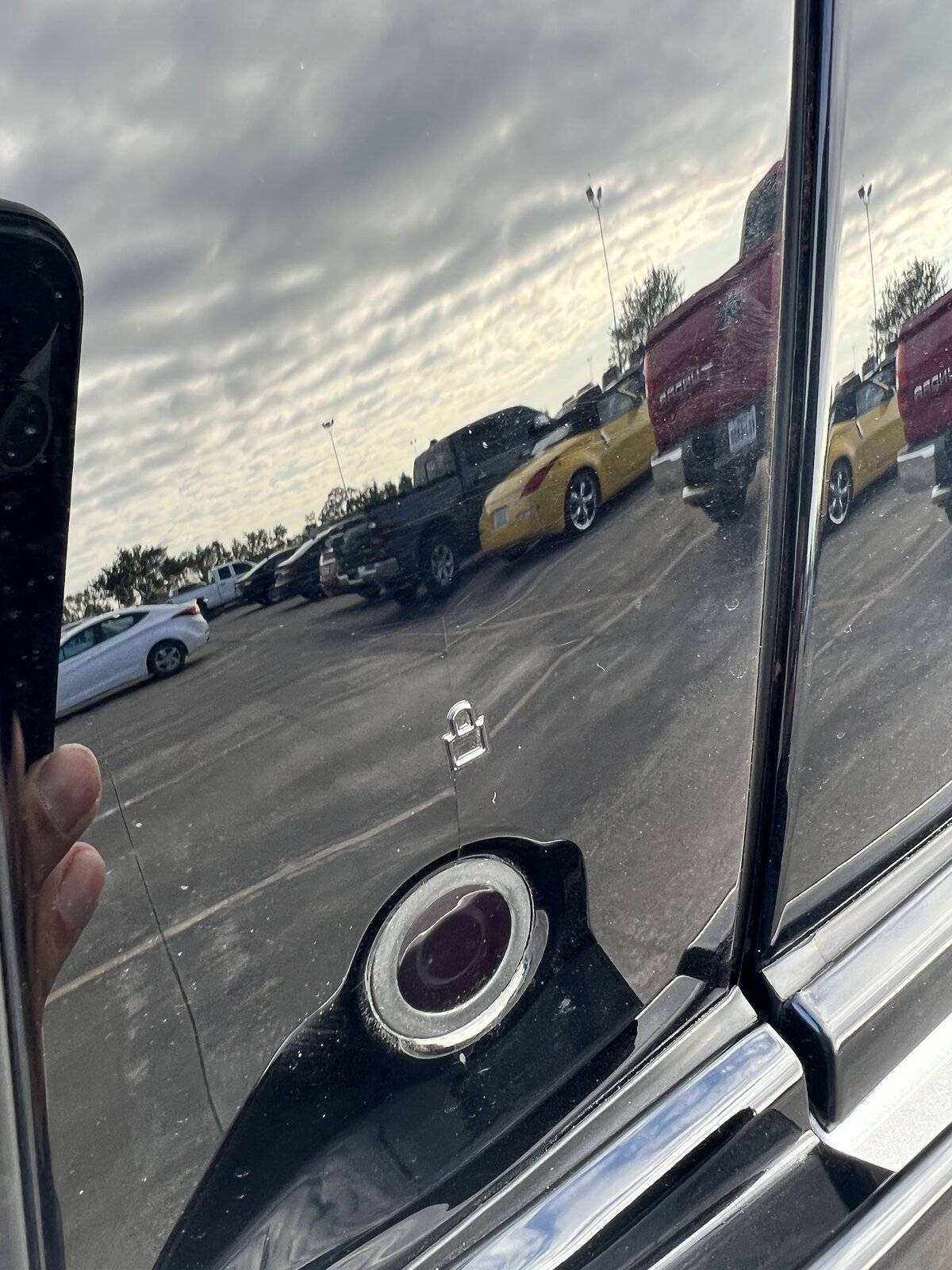

I have stress cracks on the driver side B pillar, I noticed them 2 weeks ago and plan on making the dealer aware of it next week when it goes in for the 10k mile service.

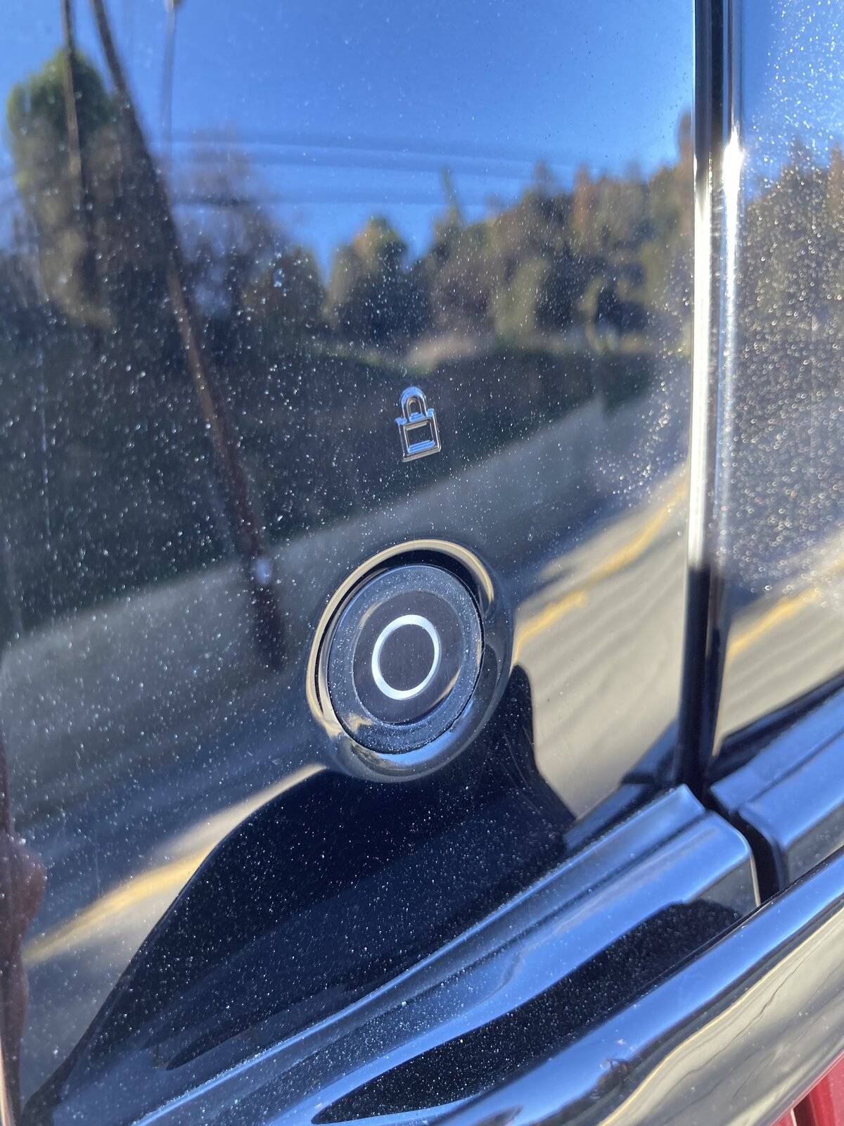

Same deal. Dealer replaced it. I took a good look at my pass. side and it's starting to crack.
I fully expect this to be like the Explorer's plastic rear panel that ALWAYS cracked and now doesn't exist on more than a handful of Explorers.
BTW this is a LOT of work for us down the road.
