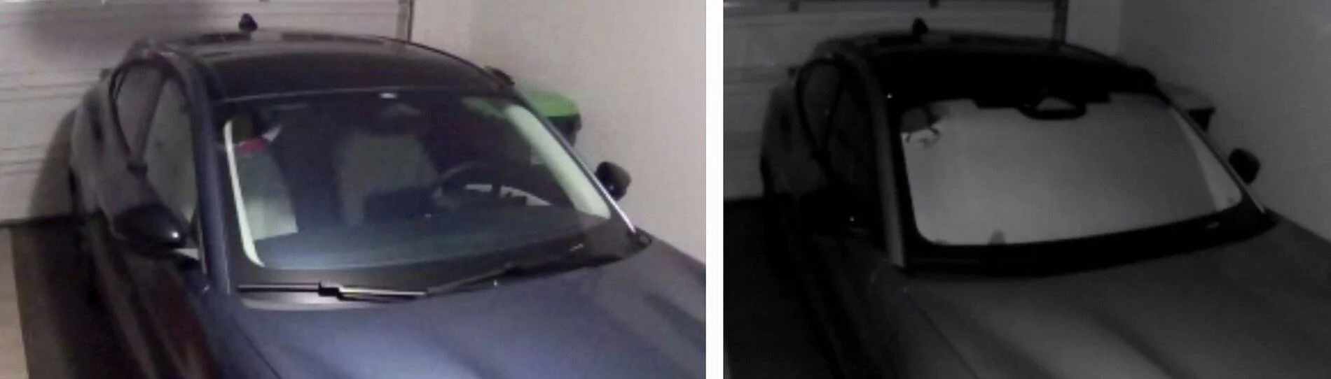

The IRR coating blocks the radio waves needed to make transponders work. You have to put it in the dotted area around the rear mirror where there isn't a coating.
Ford Mustang Mach-E E-470 transponder stickers cameranightvision-jpg
The coating is reflecting the ceiling in the IR photo, you can see the dark spots next to the mirror/camera where the transponder has to go.
