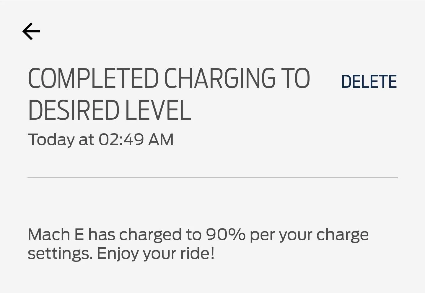

So one thing I have noticed, if you use this new feature, there is no option to set a Max charge. So it charges to 100% no matter what. Not a fan of that at all.
So you can't set the max and it charged to 100% but just realized it sent this when it got to 100%.
Ford Mustang Mach-E {Early Access Feature} Ford Intelligent Charging Screenshot_20210604-163844_FordPass

So, I’m NOT in this particular Early Access Campaign (at least according to the Early Access website), yet I’ve noticed this EXACT behavior recently and was puzzled by it. I have the charging level set to 90% in the app, and get the message that charging to 90% was completed, but on the app home screen, charging was reported as being completed to 100%, and in the car, it was reported to be completed to 100% on the instrument cluster. I’ve been puzzled by this.
My Early Access page still shows i'm not active in any campaigns as well.
