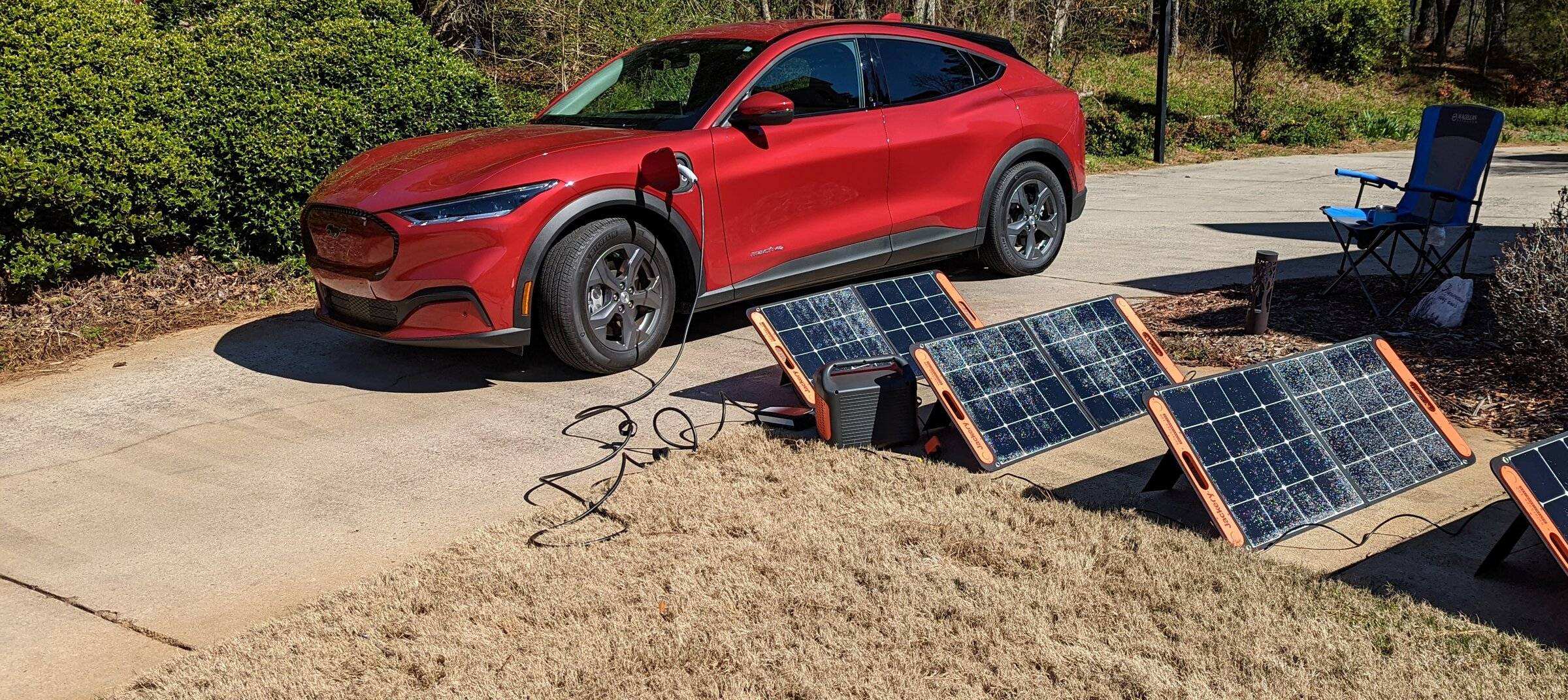

OK I know what you said about Jerry can. I get it ...but I went ahead and got the Jackery 1500 Explorer rated to 1800w peak. Just backup to mainly keep fridge going in power out continually. Unfortunately, charging experiment.. no joy on charging. Ford portable charger stayed orange.
On a good note, was producing almost 450 watts on 4 panels..I guess..
Perhaps my mathematical and electrical abilities just aren't there... what am I missing?
your little Jackery 1500 is rated for 1500watt continuous output.
The MME portable charger is asking for right around 1200watts (using the 120v tail)
....so it *might* work for a little bit. But, hardly worth it considering you could only transfer 1 or 2 kWhr from the Jerrycan, and your Solar won't keep up.
This little system might be ok to keep a refrigerator and a couple lights running..... but not charge a BEV.
If it's not working at all, it may be because the mobile charger sees that the outlet is not grounded. There is probably a 'ground' screw somewhere on the Jackery unit that you could attach a copper wire and long nail to and drive into the ground. This MAY get it working.
BUT, charging will suck the internal battery dry in a hurry, and your Solar will not keep up unless you have 1500 watts dumping in to keep up with what you are pulling out.
..... now, what you COULD do it extract 12v power from the MME connection points in place of your Solar, run thru the Jackery, and run your refrigerator and lights for a week or two without any solar at all as long as the MME is 'ON', and the auto-time-out is 'OFF', the HV will supply 14+ volts to the 12v connection points.
Unfortunately at that price point it probably doesn't include a sine wave inverter, meaning a lot of sensitive devices like chargers won't want to work on it. It is probably failing on power quality.
Also, keep in mind that even if you got it connected to the car, charging the car with it would mean running it at > 1.0C discharge, which will wear out the internal battery real fast. Best case scenario would be that you would charge all day from solar, then connect to the car and charge it for ~1hr, and get about 1kWh into the car for two days of work. You could probably just push the car by hand and get further than that in a day of work...
Experiments like these really show how much energy cars take - most people don't realize that their car is the most energy intensive thing they own by a big margin, all those details are hidden when using gasoline, but very apparent when using electricity which is easier to compare with the other things in our life. A car, even a very efficient EV, requires a lot of energy, and it isn't easy to make and store that much juice.

I think I forgot an important part noted in a few posts:
https://www.amazon.com/Southwire-Co...212d32f414af1&language=en_US&ref_=as_li_ss_tl
Is this true? I suspect I need the ground..
