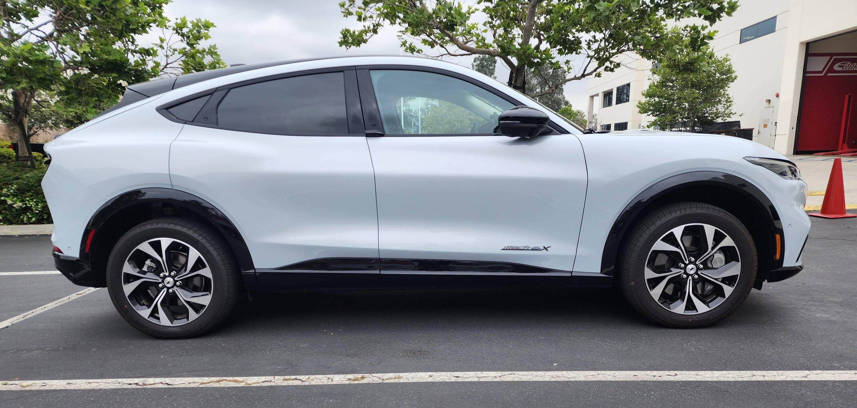

Does this make me the first lifted Mach-E?

Looks well done, natural look to it. Next we’ll start seeing BFG All-Terrains, tubular bumpers with a winch, and off road LED lights ??
stock clearance is plenty for me

Hi Mike, any updates on the car? Now that you've had it a few weeks, any changes to your assessment?
If there are any changes to my assessment, it's been more positive. No ragrets. The ride quality and cornering is fine, the extra ground clearance has been comforting, and many people have said the lifted look is a great match to the car. It "looks" like a slightly bigger car too.
The increased clearance has already helped with parking beside high curbs on my last two road trips. There was a curb in Los Angeles that I cleared by less than half an inch when the passenger door was opened. A stock-height Mach-E would've absolutely smacked it.

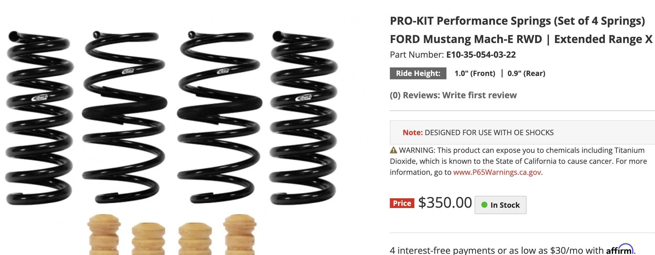

I love it! Makes it more practical for curb hazards plus getting in/out for those us who are older with neck & back arthritis...
So far only 1" lift springs available....
For the same money, I'd rather get the 1.5"

Those are the lowering springs. Hopefully the Pro-Lift-Kit becomes available soon.
Totally agree with the curb hazard avoidance!
I filled out Eibach's R&D form - hoping they contact me.
This was a really good idea for the off road look that I was looking for.

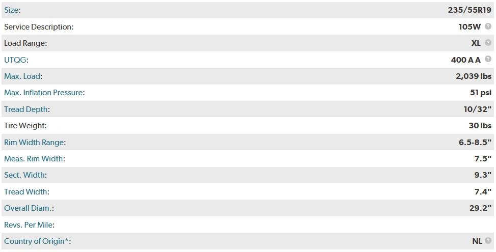

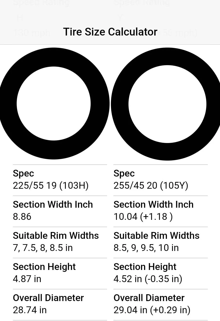

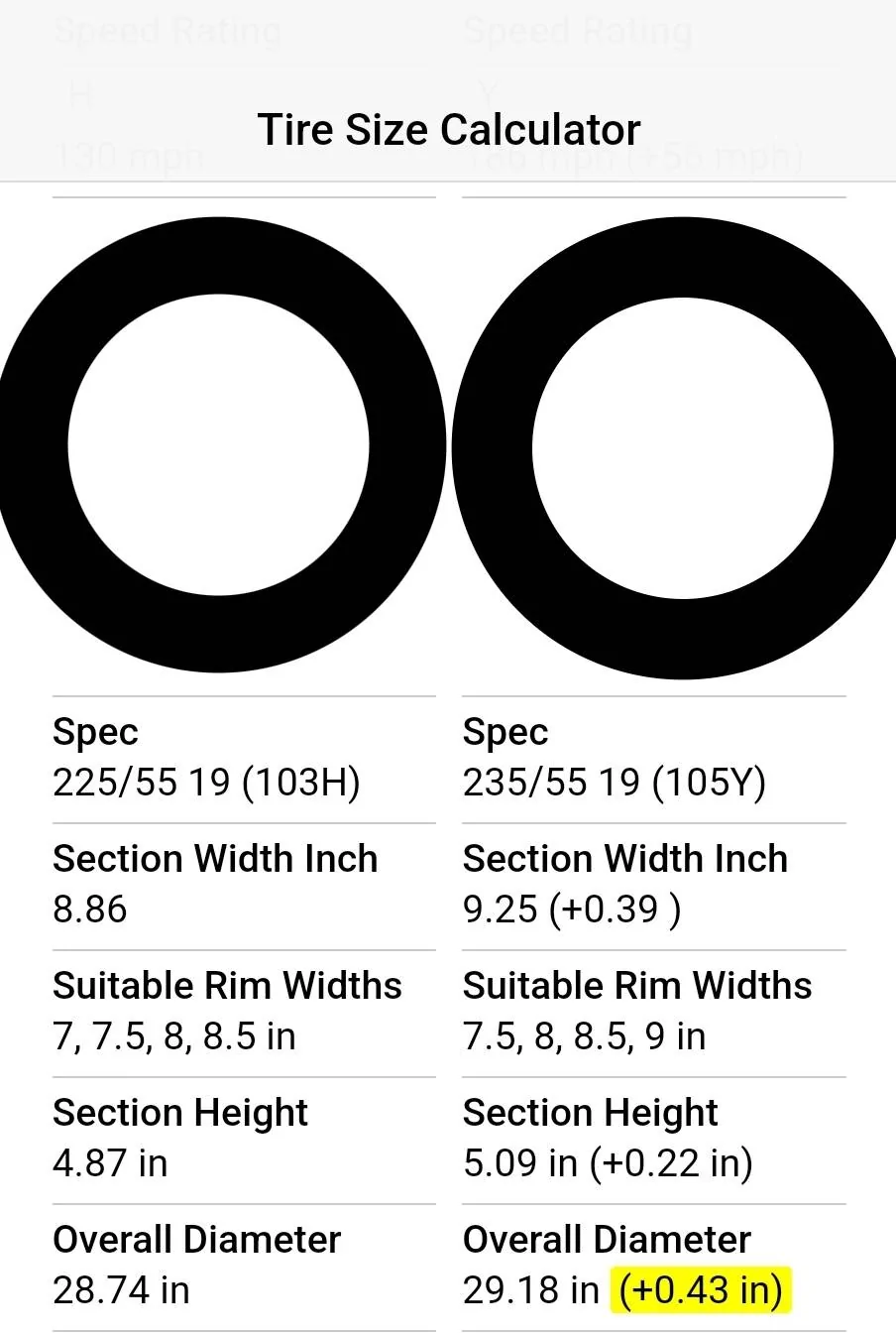

No it's slightly larger than the factory size. Usually up to 3 % difference is acceptable
The problem with 19" OEM rims is that they're only 7" width so you can only fit a max rubber width of 225.
No, and here is a good way to figure that out. Use Tire Rack as a resource look up the tire size and click "specs"
The minimum width required for a 235/55/19 is 6.5". You could actually put a 245/50/19 on the 7" wide factory rim

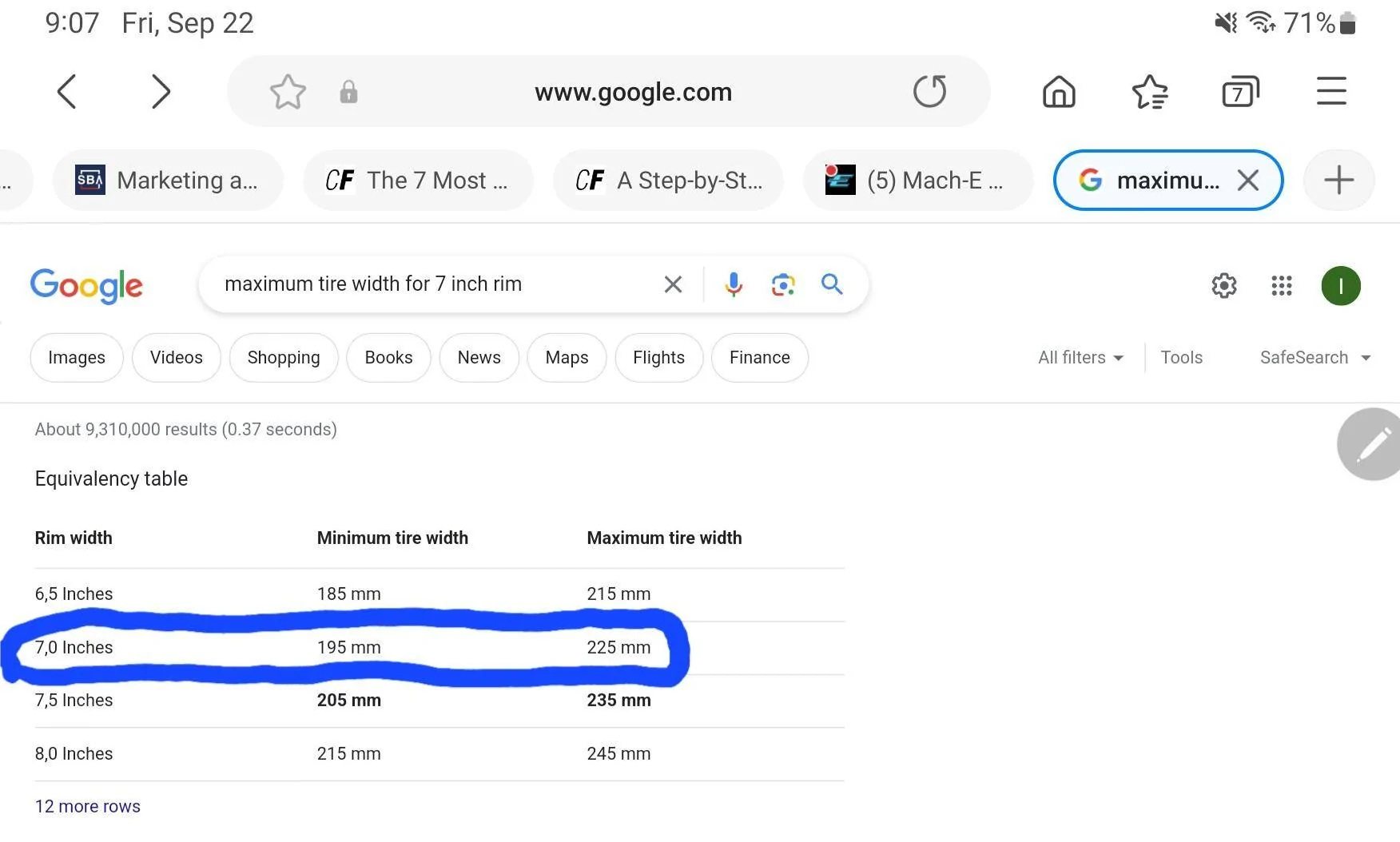

Sorry for misleading anyone... Google lied to me
Tire racks is going to be much more accurate as they get that info from the tire manufacturer. You will also notice there are small differences by manufacturer and model.
A 7" wide rim is from the inside of the flanges. So if you measure the outside flange(edge) it's likely a little over 7.5".
