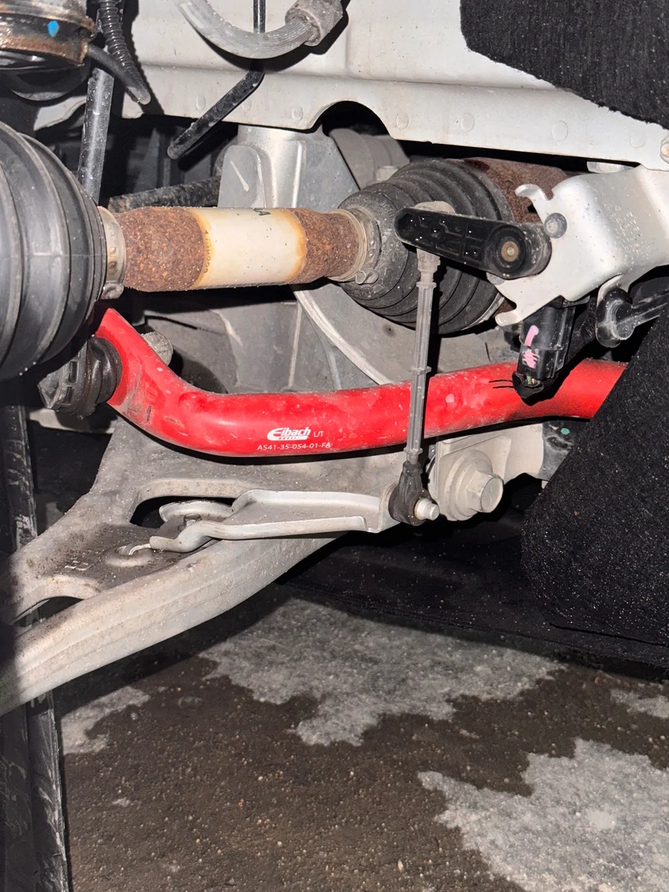

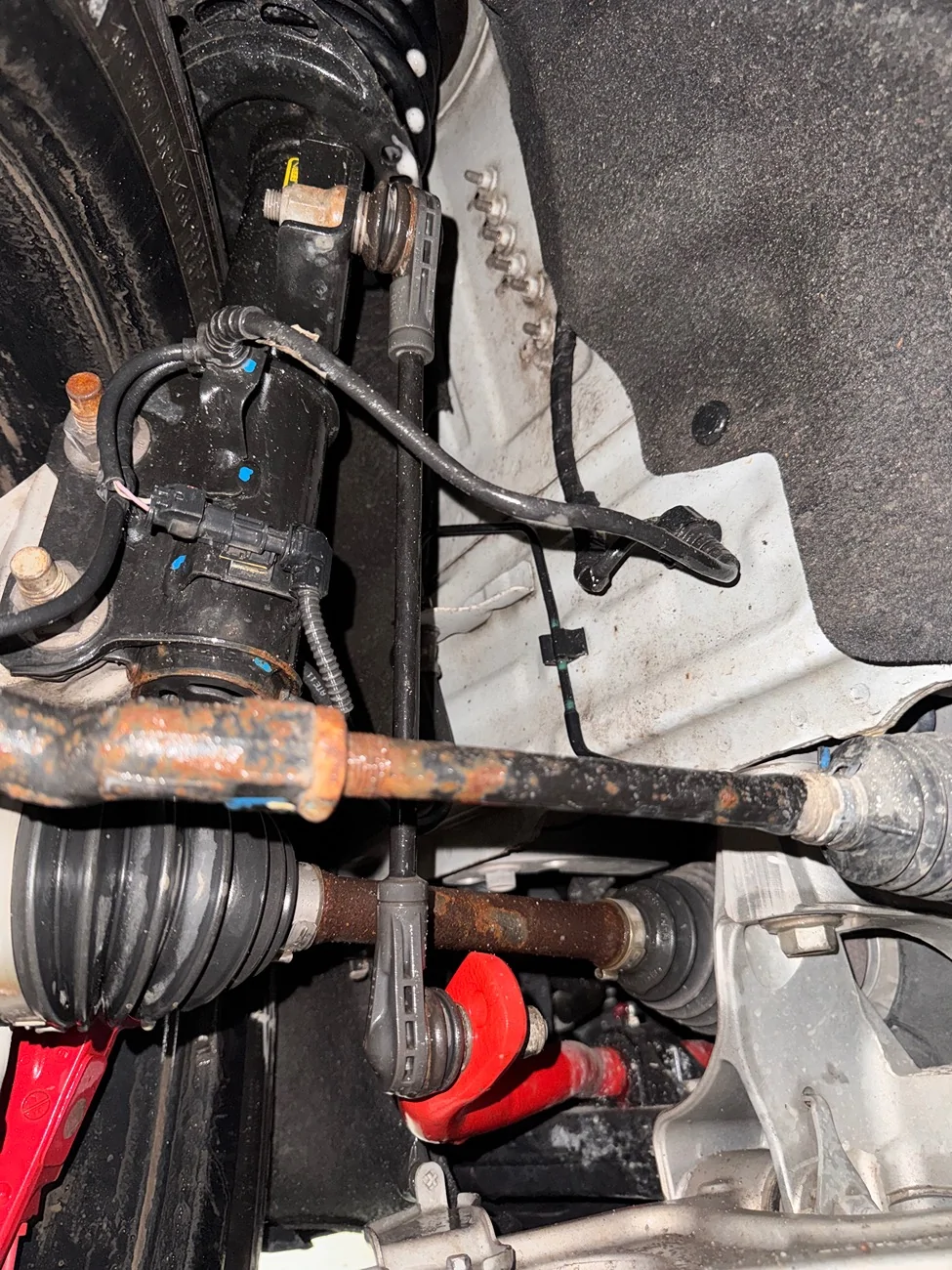

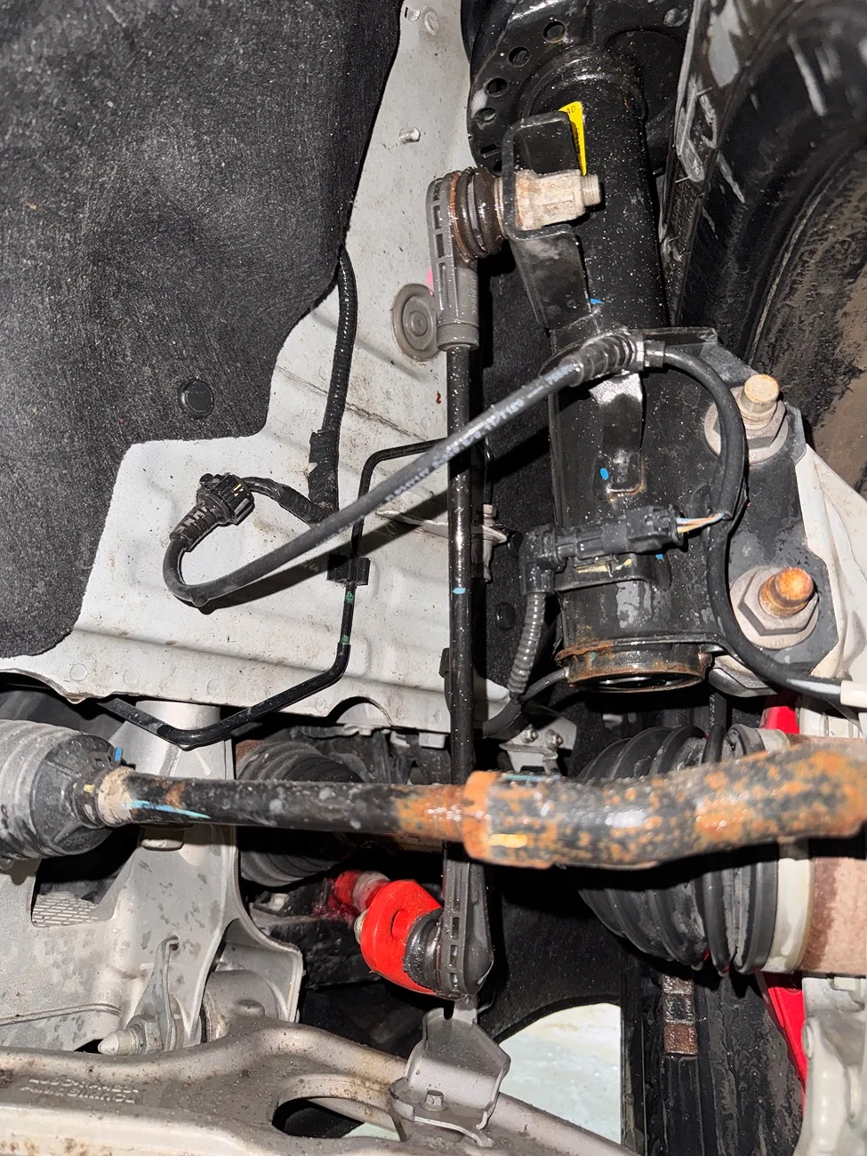

i just turned the wheels and got some photos here:
Ford Mustang Mach-E Eibach Sway bars now avalable for the Mach E IMG_9281
Ford Mustang Mach-E Eibach Sway bars now avalable for the Mach E IMG_9282

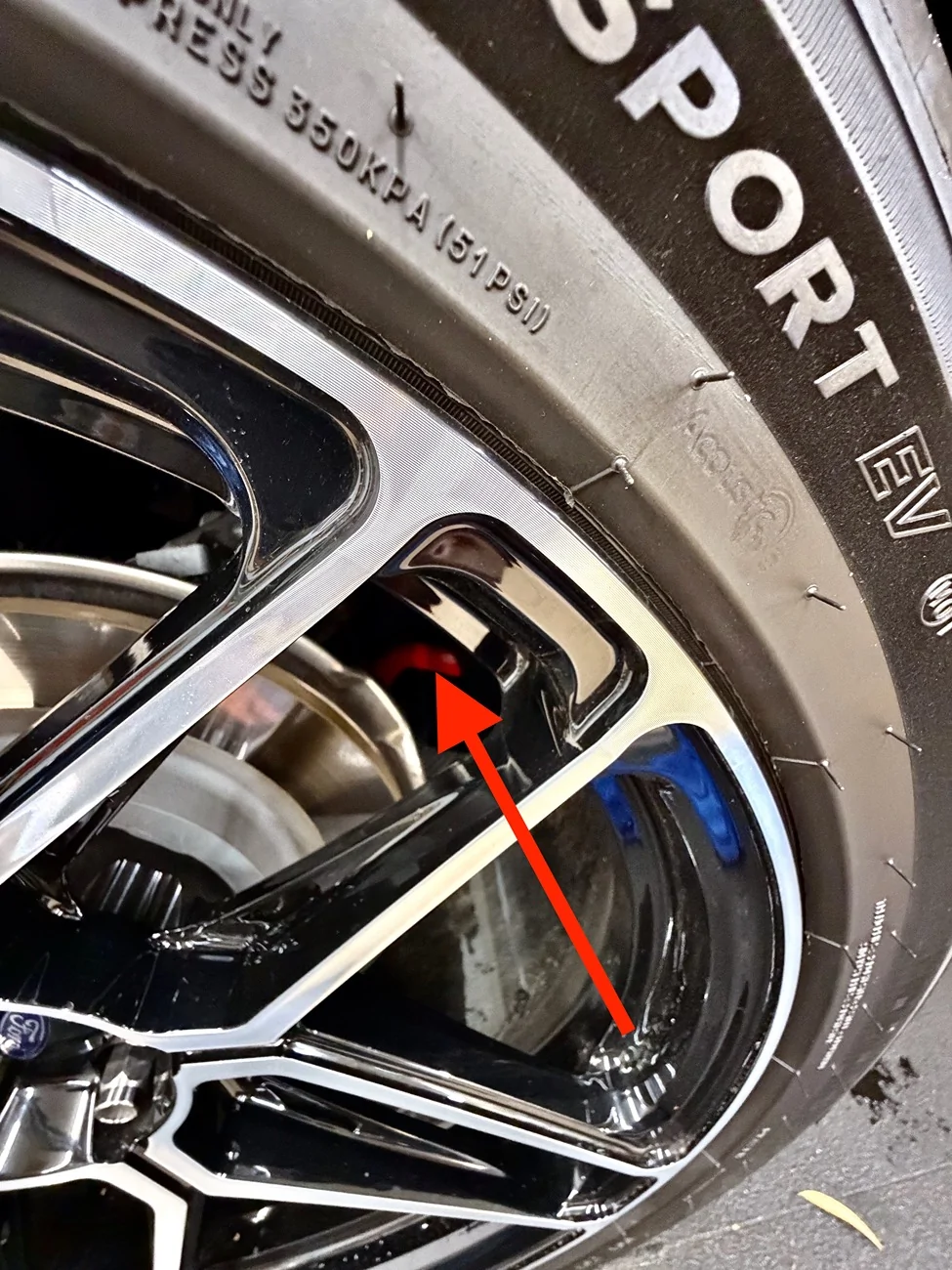

Hard to tell from the photos because of the angles but yes there is an easy way to tell if the bars are installed correctly.
I just took these photos right now to show you. On the right side (passenger) with the steering wheel turned all the way to the right, look at the end of the sway bar. You will see the word "EIBACH" printed (right side up). If you do not see this, then the printing is upside down on the drivers side.
To get an idea where it is:
Ford Mustang Mach-E Eibach Sway bars now avalable for the Mach E IMG_8982 (1)

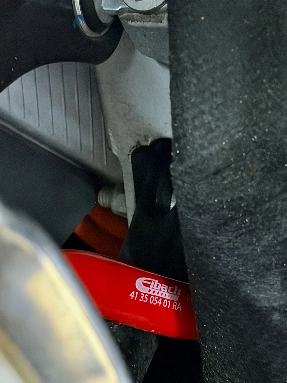

Close up:
Ford Mustang Mach-E Eibach Sway bars now avalable for the Mach E IMG_8985

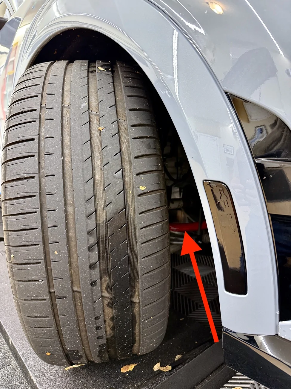

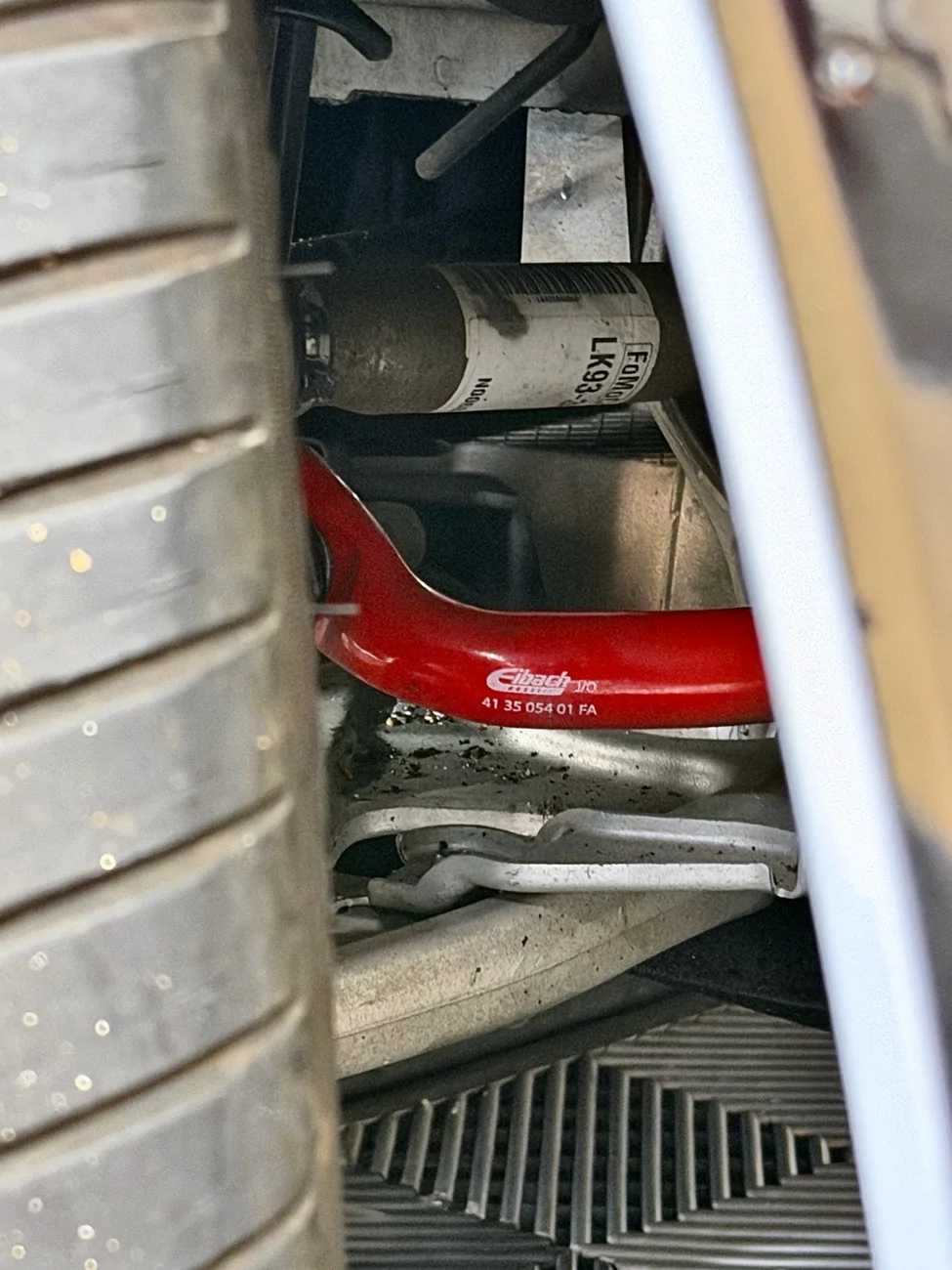

Same thing in the rear right side (passenger). Looking through my wheel, which have large open areas, you can barely see the sway bar end. Your wheels do not have as large of an open design as mine so may be harder to view. You should see "EIBACH" printed on the bar towards the end. If this printing is on the drivers side upside down, it's wrong.
Ford Mustang Mach-E Eibach Sway bars now avalable for the Mach E IMG_8986
Close up:
Ford Mustang Mach-E Eibach Sway bars now avalable for the Mach E IMG_8987

Seems like it’s at the right location. I guess I’ll have the endlinks checked out
Ford Mustang Mach-E Eibach Sway bars now avalable for the Mach E IMG_9287
