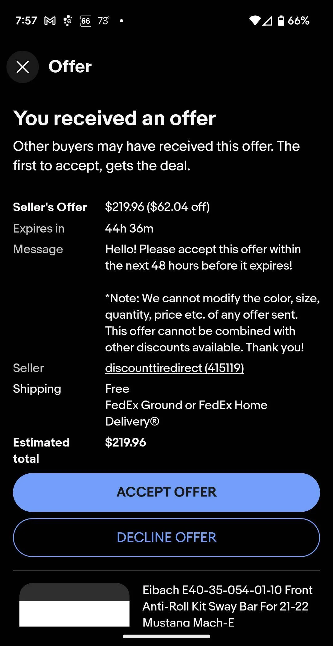

Ok I have a tip on how to get a deal on the eibach sway bars. Discount tire is selling them on eBay so find them and add to your watchlist within a day they will send you an offer for $219.96 each shipping included to buy it now.
YMMV but that's what they offered me

Ok I have a tip on how to get a deal on the eibach sway bars. Discount tire is selling them on eBay so find them and add to your watchlist within a day they will send you an offer for $219.00 each shipping included to buy it now.
Thanks! will give this a shot
It worked for me, too. Added to my Watch List and a day or two later I got the offer e-mail.
