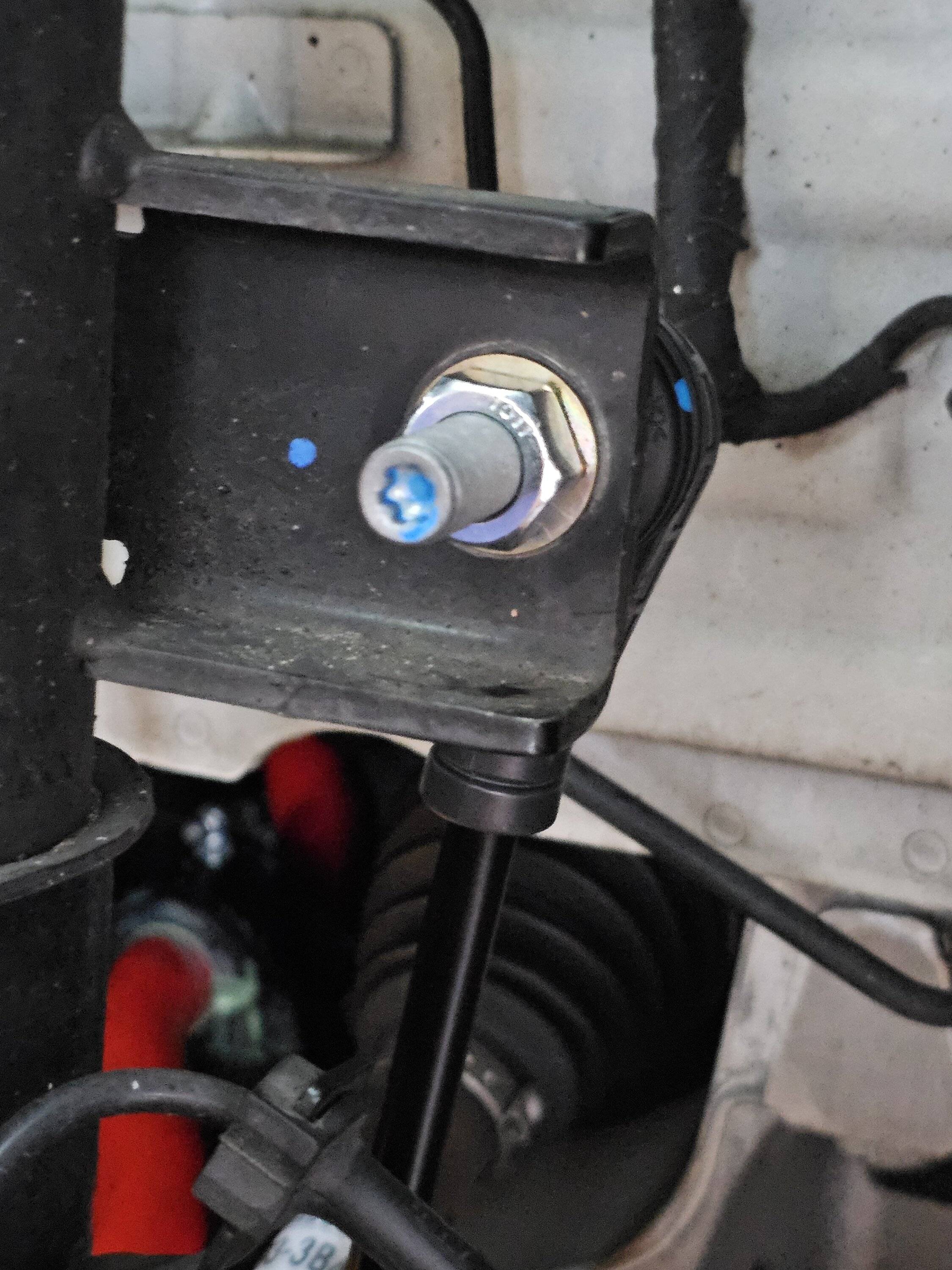

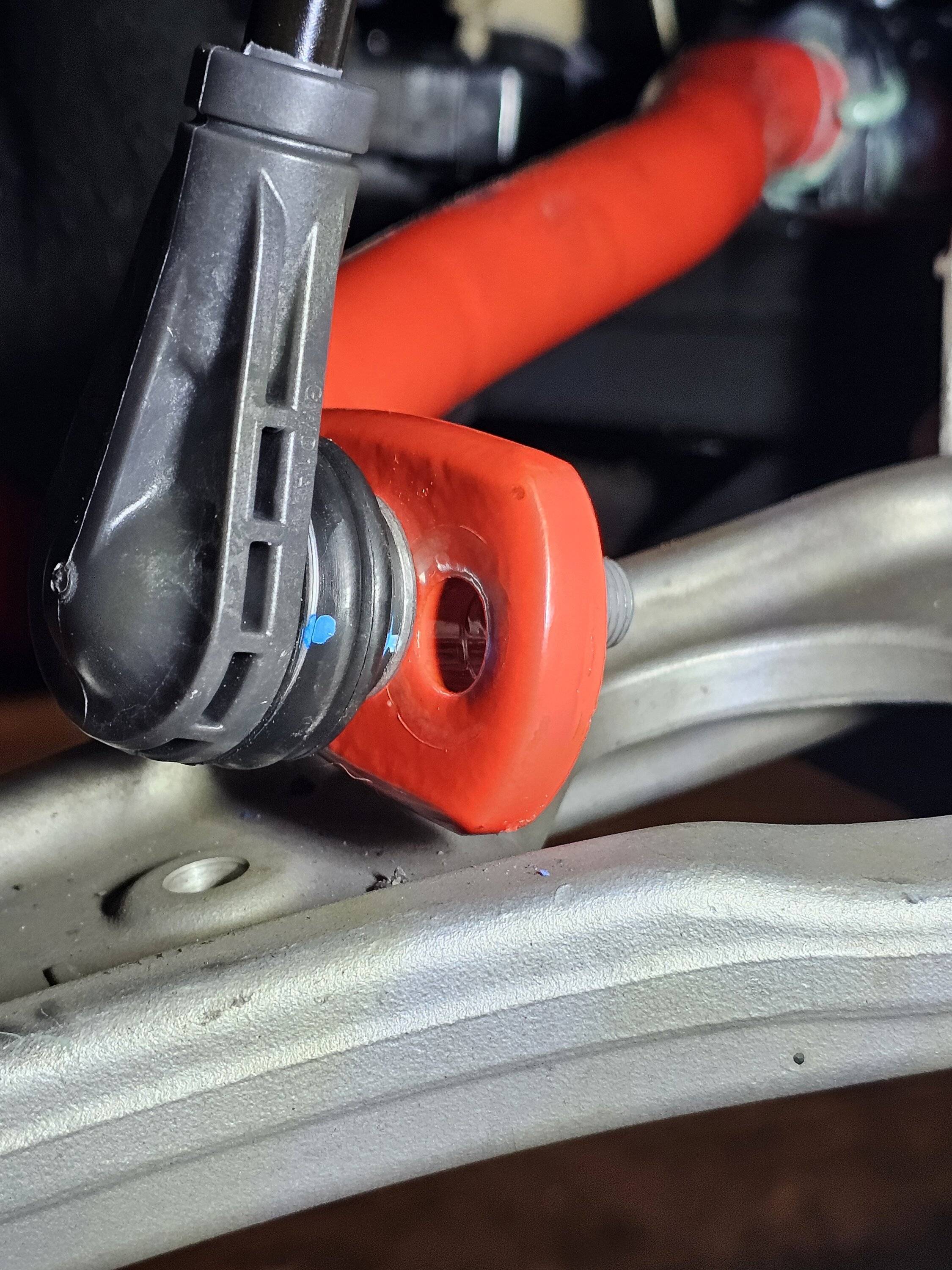

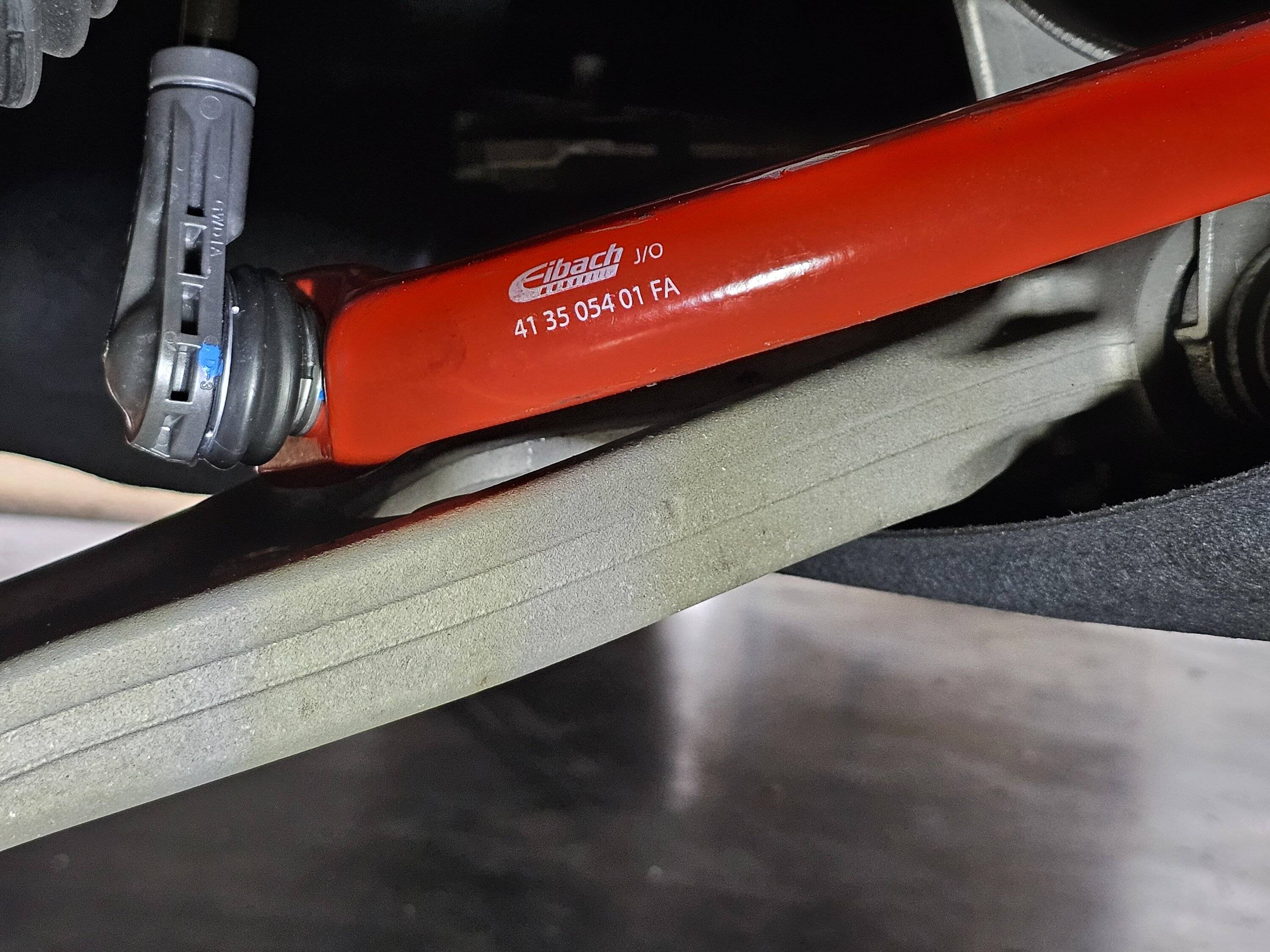

I installed the front bar yesterday. The clunking and creaking noises are gone. Here are a few pictures. I need to point out that if you are like me, and threw away the stock end links, make sure you get the right nuts. The Steeda nuts do NOT fit the OEM links. I forgot about that and was ready to attach them when I realized I didn't have the right sized nuts.
I had to order new OEM end links. Which is great, because now I know I have new parts in that part of the suspension.

Bar installed at the stiffest setting:
Ford Mustang Mach-E Eibach Sway bars now avalable for the Mach E 53392203293_2109462faf_o
The clearance concerns me, but this probably means I don't need to worry about the bar rubbing on the half shafts.

I loaded up the bar with the grease @markboris recommended, but is no longer available. It was a little messy. I positioned the bar all the way towards the front of the car, because when positioned towards the rear, it was close to hitting the motor insulation.
I
Ford Mustang Mach-E Eibach Sway bars now avalable for the Mach E 53392204323_a022bf86f1_o
I had to run out to Lowe's to get four M12-1.25 nuts because I didn't remember that the Steeda end links used a different nut. And of course I threw away the OEM nuts. @HuntingPudel told me I should add some green Loctite and that will prevent the nuts from coming off if they loosen. Or I could order the Ford nuts. Actually, it was soooo much easier to put the non-locking nuts on, I would rather just put the green Loctite on there and call it a day.
Ford Mustang Mach-E Eibach Sway bars now avalable for the Mach E 53391095462_9c97462c0b_o
I love how much better the car drives now. It is quieter and smoother. The bounce is the same, but it definitely is an improvement over the Steeda front bar.
I
