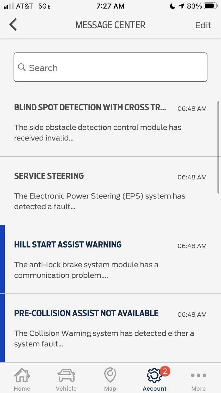

Had exact same issue when driving my new MME home. Turned out to be a faulty module. Took a month to get the part but that did fix it. Now never had the 12v battery issue until a week ago. Now twice have come out to a dead car. The odd thing is i have seen in the ford app that it was charging the 12v battery.

I just had same issue. All same warning lights. Had drivetrain power, AC and such but no power steering. Towed to Jim Ellis Ford in Sandy Springs. I’ve forwarded this thread to service advisor and await word on issue.

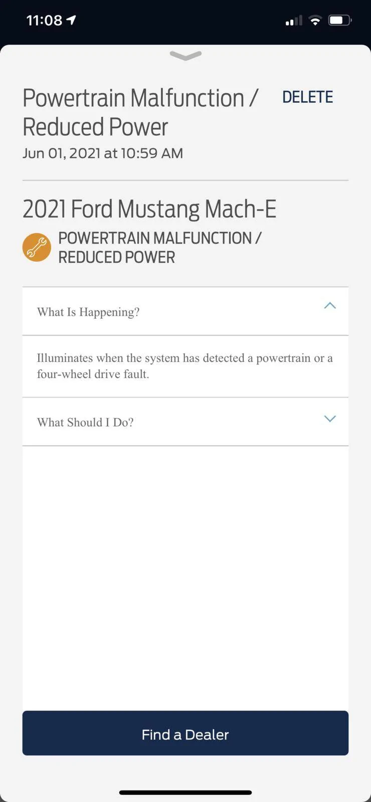

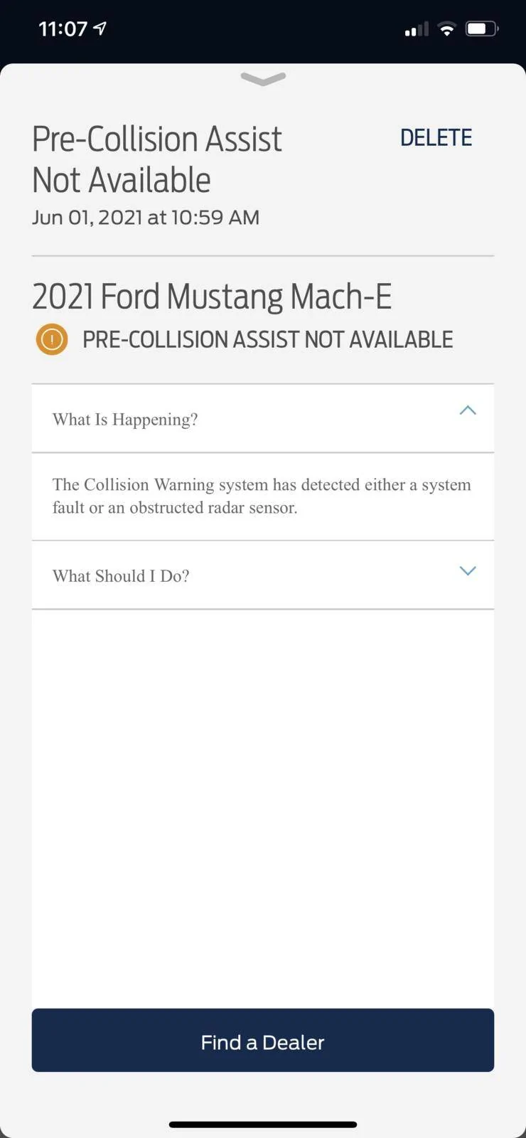

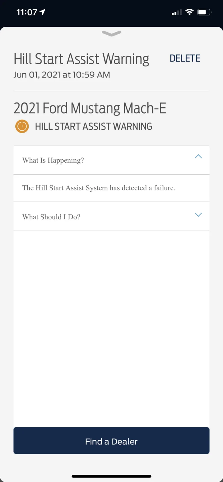

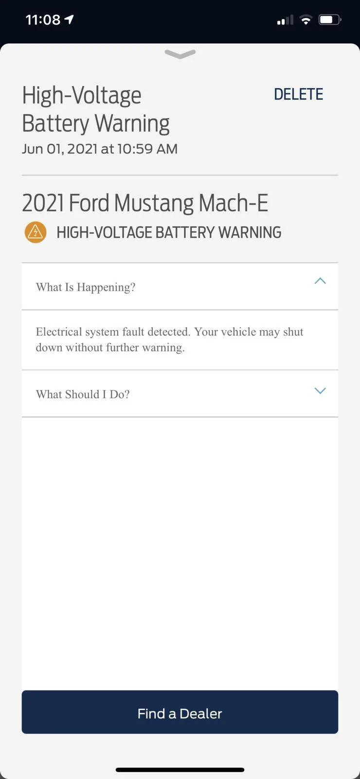

We purchased a 2021 Ford Mustang Mach e premium extended range model with 20 miles on the odometer. On our way home from dealership while traveling 65 mph with 55 miles on the odometer the vehicle started flashing the following codes listed below on the dash screen.
1) Service vehicle soon
2) Pre collision assist not available
3) AWD fault Service required
4) 1 Pedal Drive fault, Press brake pedal to reduce speed
5) Stop safely now
6) Service Advance Trac
7) Full accessory power active
The car now has 1500 miles and this same thing has happened 5 more times. It seems like this happens more frequently at slower speeds with 1 pedal drive active when you are releasing your foot from accelerator pedal and preparing to stop. When this happens at slower speeds while preparing to stop at a stop sign the vehicle makes some very strange sounds like electrical motors clashing and the vehicle jerks back and forth very quickly several times. This has also happened at higher speeds with auto pilot active. I have noticed the weird sounds out the vehicle jerking back and forth when at higher speeds, 60 mph +. Only at slower speeds when preparing to stop.
When this happens the following messages appear on the ford pass app.
The vehicle has been back into the Ford service shop twice and is currently at the Ford dealership now.
Ford has not been able to figure out what is causing this to happen. Please let me know your thoughts and or recommendations. Any help would be appreciated.

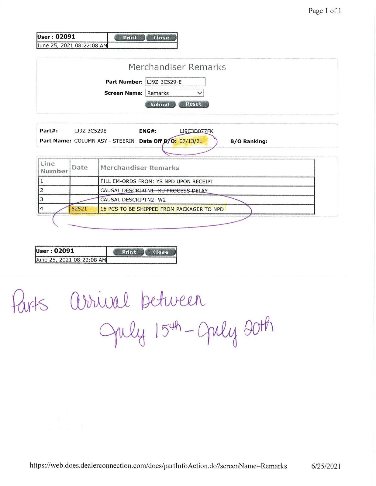

1 month update for me. Got a call from service/parts yesterday that the part that had been ordered to replace my steering module was cancelled and replaced with a new part by Ford. Apparently they've still had issues with that part, so I'm thankful it was discovered before it was put back in my car only to have issues again. They estimate arrival of the part August 17th... so will be about 2 months total... possibly. The manager said they'd help me open a ticket with customer service regarding payments or something. Kinda hurts paying for a car you don't have. On the bright side they have provided a loaner this entire time. I know it all could be much worse, so just trying to be patient and look on the bright side!
Attached is the original parts ordered but have since been cancelled and replaced (don't have a copy yet of new part numbers).
