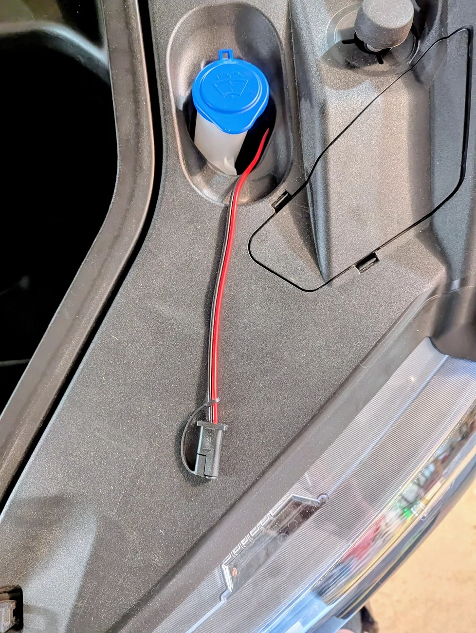

We have a 2025 GT that we took delivery of on June 5th. It only has 888 miles as we don't drive it much. This morning I went to back it out of the garage and this warning keeps popping up. Is this just the LVB not charged up enough because we don't use the car as much as our other vehicle? If so, what's the best way you guys have found to use a maintenance charger periodically on the LVB to keep the charge up on it.? I know it's under the Frunk trim on the left side. Does the LVB get any charge from the system when a L2 charger is connected, or only when you are driving?
Go through the list here: https://www.macheforum.com/site/thr...-system-drain-service-required-message.36140/
I would also recommend you get the 12 V recall update done as soon as possible. That will help keep the 12 V battery charged more.
