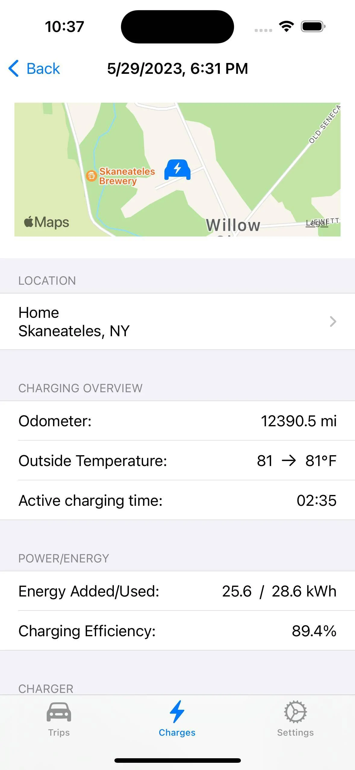

I agree. Thanks for helping clarify. And typically it is around 10%.
Just recorded an L2 charge tonight and was just under 90% efficient (kWh delivered to the battery divided by the kWh measured at the MME plug).

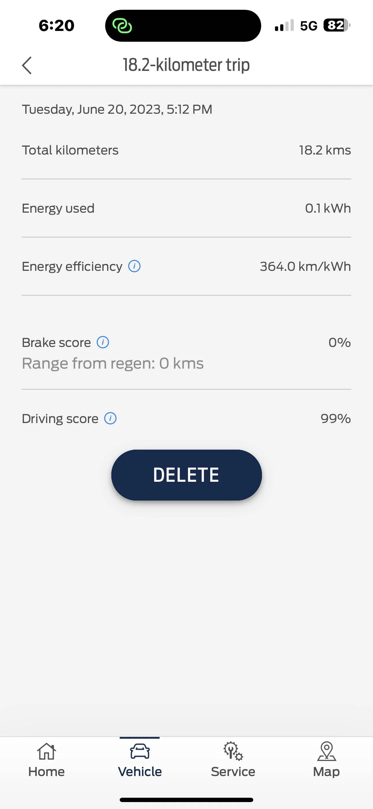

Because we are discussing this, I decided to check through my EV driving history logs over the past week or so. Only one looks incorrect, which really surprises me. I literally have not looked at this data for months and now it looks pretty good. I wonder if one of the OTAs finally addressed the issue? I seriously doubt that, but it does seem better.
Of course now it will all go to crap...

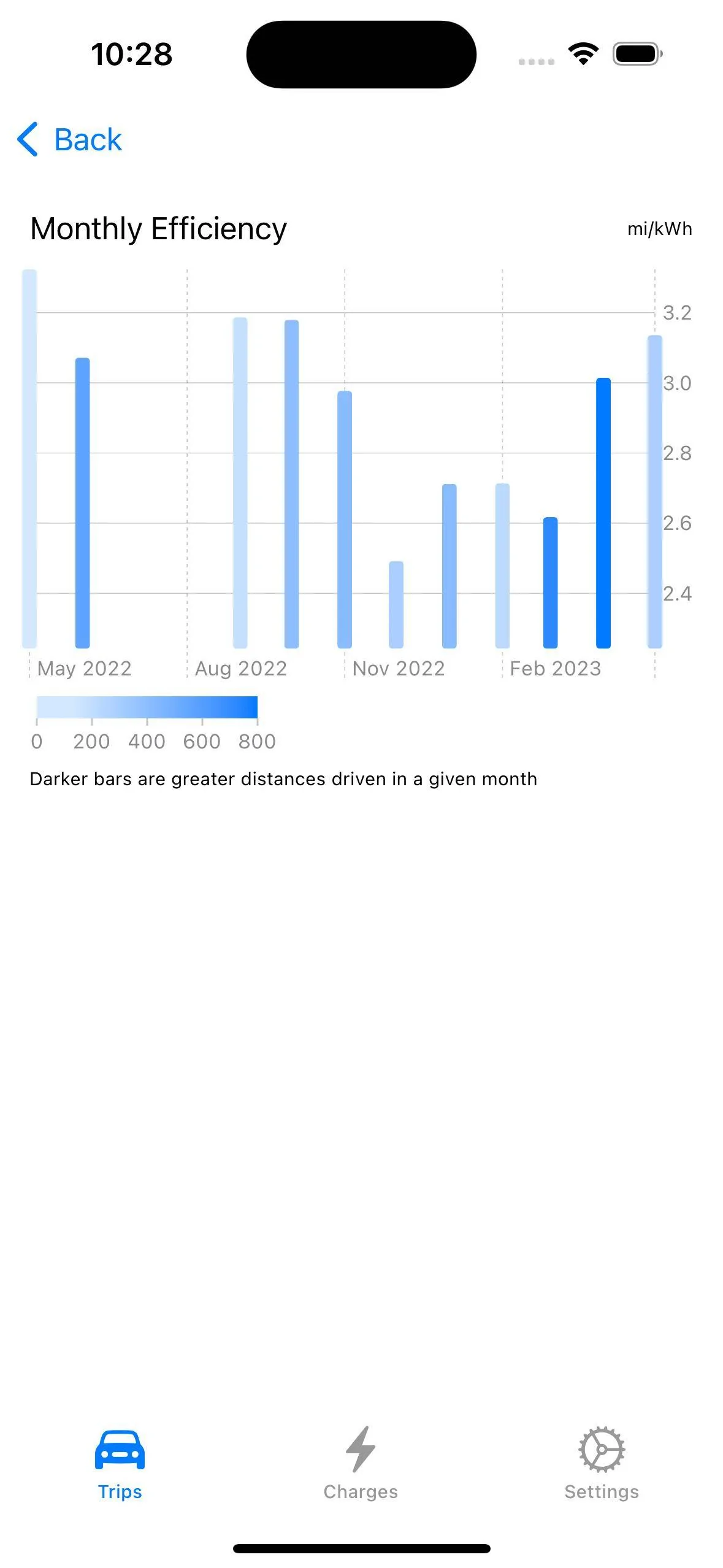

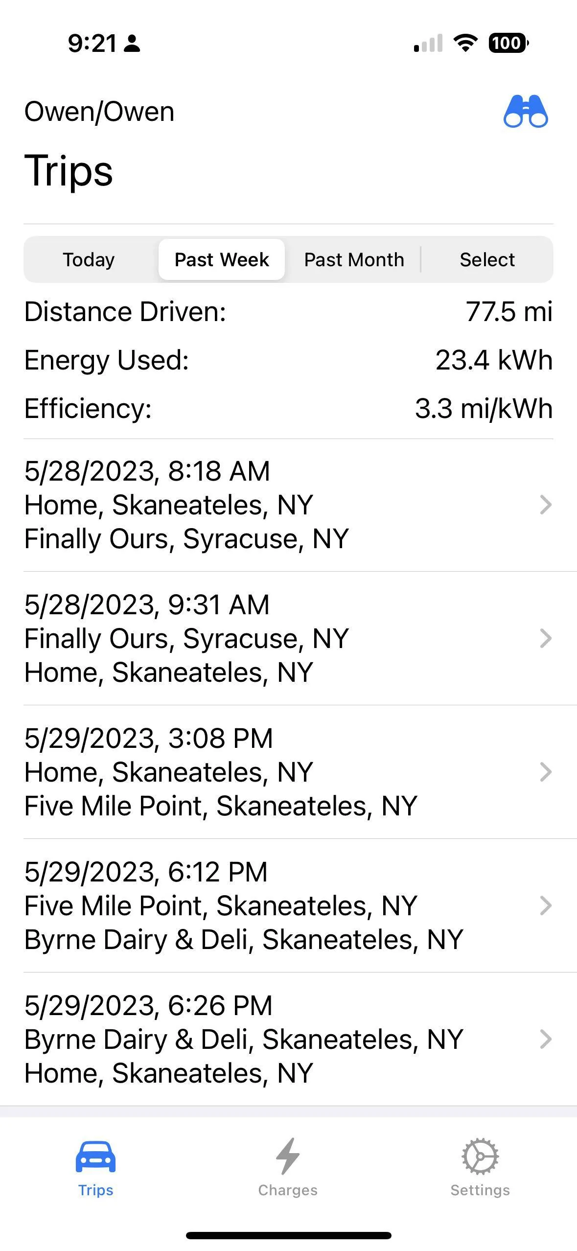

I am also in upstate NY and here are some real efficiency values for the past week on my wife's MME GT, I would expect your results to be similar:
Your efficiencies should be around 3.3-3.5 mi/kWh in summer and perhaps 2.4-2.7 mi/kWh in the winter, less if colder or if driving on wet roads or in slush. Here are my efficiencies over the past year (the darker bars have more miles than the lighter bars):
Try the trip odometer in the vehicle for better results but even it is flawed as it often combines multiple trips into one. But at least it gets the efficiency right.
Is this the Apple app? The Android app doesn't provide this level of detail.
What app is this?

Your conclusions are flawed. Rest assured the data is still fubar. On Monday, May 29th, I took a 13.5 mile trip and used 0.2kWh, for an efficiency of 90.3mi/kWh. Yea, me!
