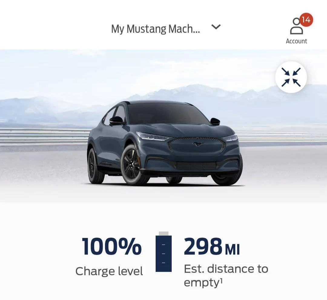

Have had MachE 2023 CA Route 1 for a little under 4 months now.
When we got it from the dealership estimated range shown on the dash at 100% charge was around 270 miles, quite a bit below the EPA estimated 312 for this trim (as well as real world driving test reports). I did some nervous searching on the forums, read that the estimate was a bit conservative, reset the driving data tracker in settings, and waited to see what happened.
This past weekend I charged to 100% for a road trip, and right when the charge ticked over from 99 to 100%, estimated range showed 298m. My long-term trip average is 3.3mi / kilowatt, which with the 91kw extended range battery is almost exactly 300m. So it now seems pretty spot on.
(I also noticed, on a drive back from Vegas to LA, that the range estimate dynamically adjusted with the miles/kw of the trip at any given point. This is also really helpful, though it can be a little nerve-racking when going over a mountain pass.)
Ford Mustang Mach-E Estimated Range really does adjust to driving data Screenshot_20230527-105931
