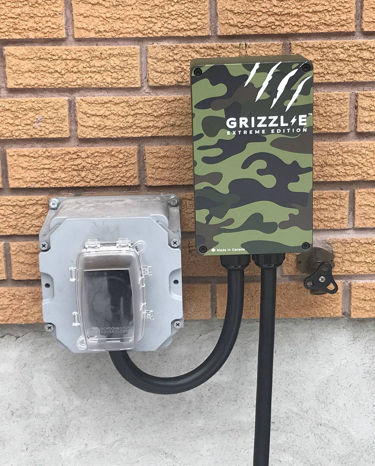

One without underground lines, foundations and structure.
Ford Mustang Mach-E EVSE without garage or carport IMG_2982
Curious, why the Grizzl-e? Seems like I'm seeing a few pics of that one. Based on the advertisements on this website or research? I did the JuiceBox based on the review by Moloughney's from Insideevs.com. Just curious thanks
I just wanted to be extreme ;) . I like that is is dumb less to go wrong and less on the brain.

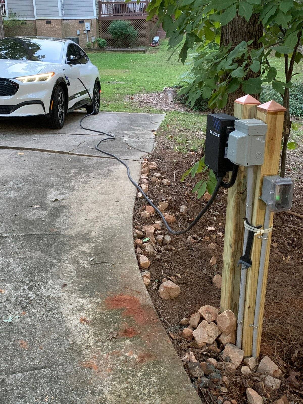

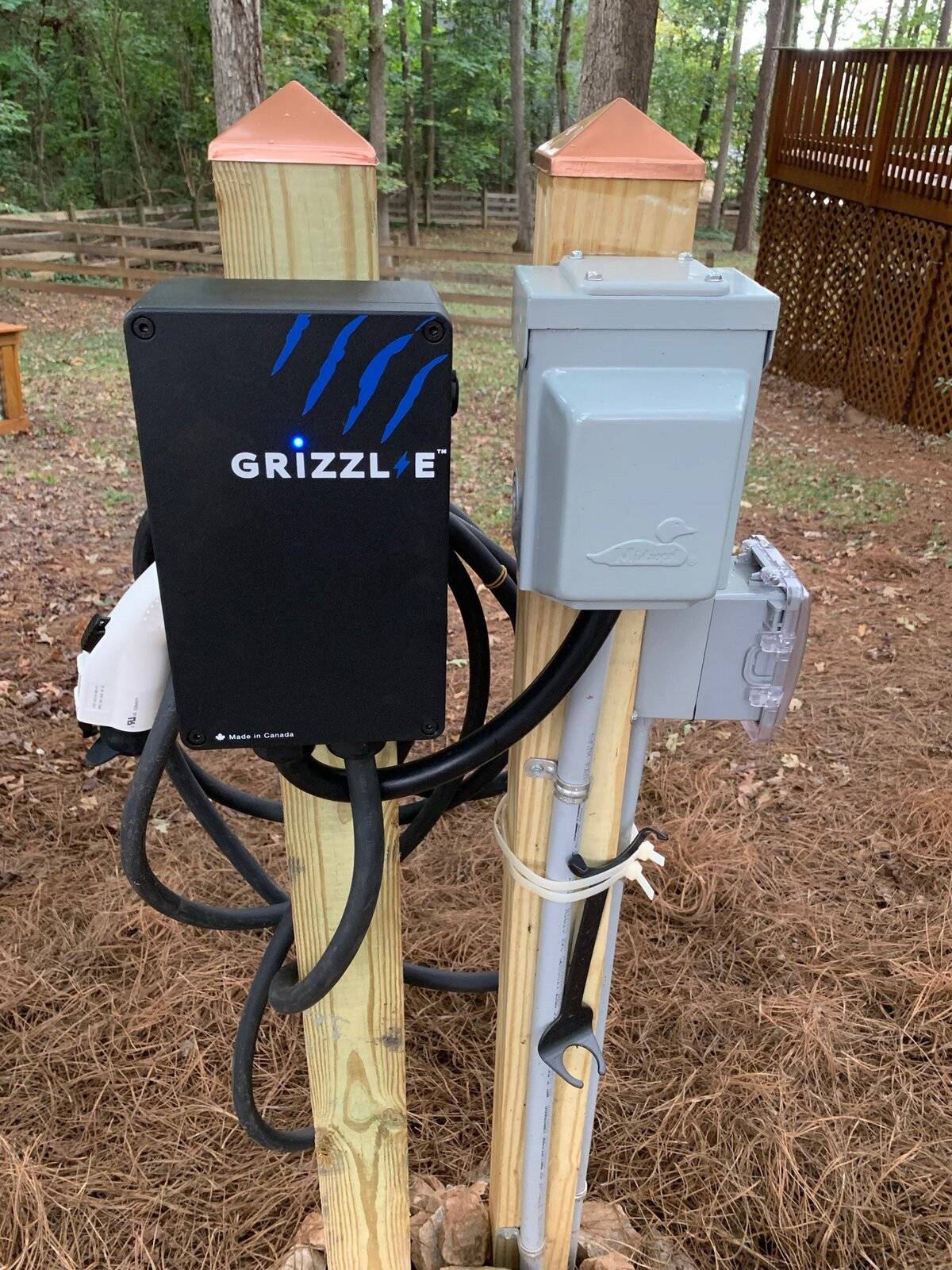

Here is my setup. I did the work myself, with the wires inside the post (in 3/4 Sealtite) as well. I also did the install 4 months before the car (estimated build 11/01) because I didn’t want to be digging a trench in NY winter.
I thought about adding the 14-50 outdoor outlet as well, but couldn’t figure out a good way to install an isolation switch so a person couldn’t overload the 60amp breaker by plugging in anything while charging the car at 48amps. Hardwired, the ESVE should be the only appliance on that circuit and I wasn’t pulling more wires for a separate circuit in the 3/4 with the 4/2.
Plus, I have the luxury of 2 welding outlets in my garage I can convert if I have to use the mobile charger.
Very clean install!
Your charger is ok, but that sweet '66 Stang in the profile pic is the real Beaut!!!

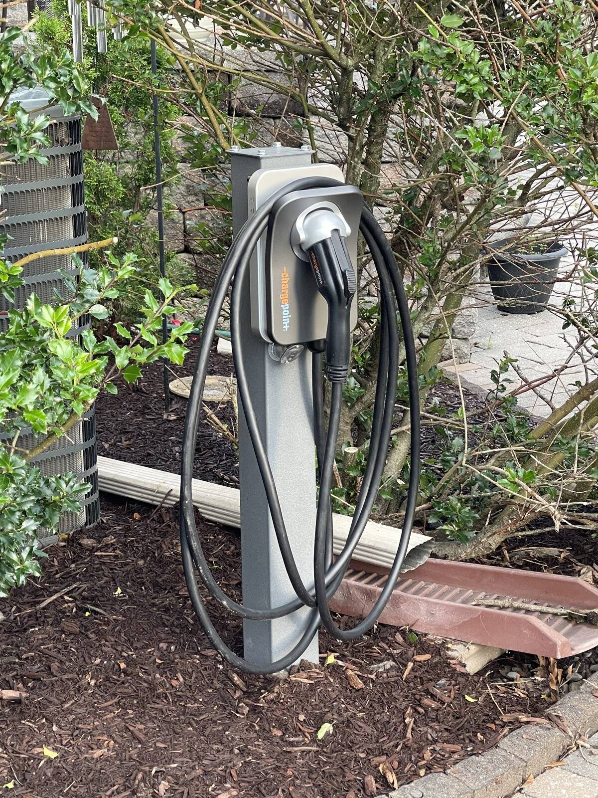

Pole mounted as well. Saved a bundle digging the trench and setting poles myself (quick dry cement and a level)
Ford Mustang Mach-E EVSE without garage or carport IMG_3503
Ford Mustang Mach-E EVSE without garage or carport IMG_3505
. Adding a 110 is a great decision while you are at it. Grizzl-e are weatherproof but if there is a significant chance of rain, I'll cover with a jumbo plastic storage bag (like you would use for clothes/blankets). Also you can turn the power off/on at the breaker panel so it's not live all the time. I'll be considering a more permanent cover, like the examples above. Got the 24 ft regular cable and key lock and a refurb Classic unit. Cost was $412 total.
