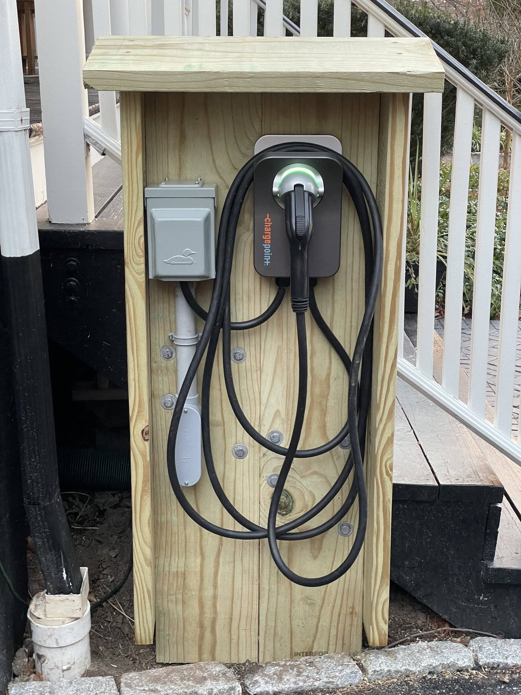

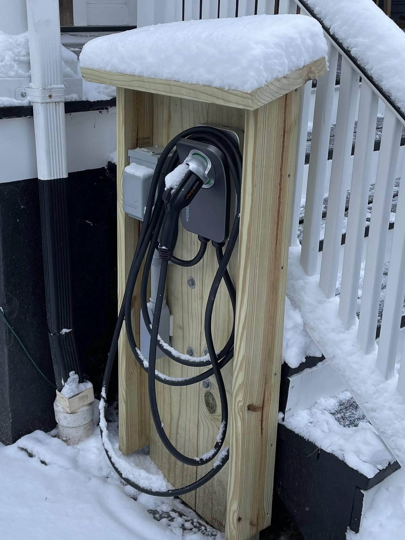

I had it unstalled by professionals and inspected by the town. I asked about the orientation when they started and they said it’s designed to be rotated if needed. There are many pictures online of the ChargePoint Home Flex installed this way. Pics of my install are attached…I built it a little home!
Note that it’s raining now so I don’t want to go outside and unplug it to get a pic of the outlet itself but will when things dry out.
Ford Mustang Mach-E Installing a Home Charging Solution in a Carport DF6A04C1-44FE-4C25-9E80-3FB2F017F0AF
Ford Mustang Mach-E Installing a Home Charging Solution in a Carport 3039CEE4-D9D8-4D84-BB20-7D4B75BB5FCB

That looks great!, I see you also struggle trying to keep that cord tidy, drives me nuts.

Nope, that’s perfect, and you answered my question. I was told that rotating the outlet would not be up to code, and that sounded silly to me at the time, but I didn’t question it.
That is pretty much how I wanted to install mine, until I was lead the other direction.
That’s a nice clean install there and looks great. I like the housing built for it.
