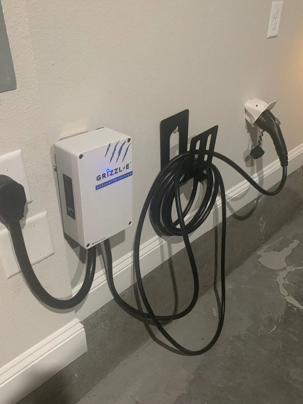

I tried a few home charging units for my Mach-E GT and I finally found the one that works flawlessly for my home, it really does the job and charges quickly in comparison to other options I tried. I would highly recommend this charging solution for anyone looking. See pic.
$349 at amazon
I just got one a month or so ago. Gets about 8.6 kwh an hour for me at home. Not as high as I hoped, but certainly beats relying in the mobile charger at 7wh.

I’m most impressed with painted walls and baseboards in your garage
My Autel dispenses 11.3 kwh. It's hardwired on a 60 amp circuit though.
$349 at amazon
Nice setup. I also have a Grizzl-E and recently added an adapter to charge my wife's Tesla, replacing the Tesla system.
Nice, yeah I just love this thing, it is so fast and never fails in over 6 months.
