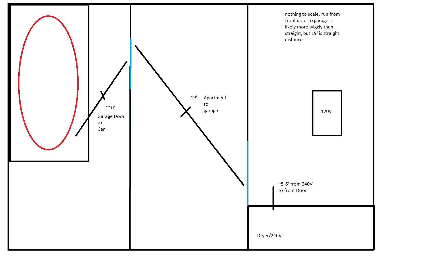

While I await my Mach E to arrive, I've been trying to come up with ways to charge it in my current apartment, as the property lacks EV chargers and isn't very keen on getting some added, despite my discussions with some of the managers (they implied the parent company doesn't want to shell out the money to get the infrastructure installed anywhere on the property despite electrical runs everywhere). So I've been looking into extension cables to make it possible. I'm fortunate to live in an area where there are numerous public chargers, EA and other brands, very close to my home. But I'd still like to charge at home when I can.
Does anyone have any J1772 extension cables that might work for my scenario? I seriously lucked out when I started paying extra for a reserved parking space that is right near the door from our parking garage, and that my apartment is the closest unit to said door, so a cable seems like a good possibility. However, I want a cable that either A) is long enough that the entirety of the cable sans the male end of the cable be in my unit, to help alleivate any tampering with it or B) has some kind of lock system to prevent people from trying to tamper with it. The people in my complex are very nice and I doubt anyone would cable try and unplug a big cable in the hallway, but still.
I found this charger extension, that is 40'. Right next to my front door is my washer and dryer, with the dryer's 240V outlet easily accessible. I measure about 36' in total, including some drops and height needed for the plug and charger on the car. Idea is that I plug the Mobile Charger into my dryer's outlet when I get home from work, leave the charger in my apartment, and then plug the extension into the charger (leave the charger male end/extension female end in the unit), run the extension the entirety of my run and into the car.
But hoping other's here have better ideas. I also made a really crude mock up of the layout from my apartment front foyer to my car's parking space if it helps!

Most of this has been said but:
- Overnight charging with an extension cable if any kind is a fire waiting to happen. I would argue the 120V cable is even less safe in this regard, because many apartment outlets are old, not wired properly (I.e back stabbed with #14), and likely daisy chained to other outlets increasing the likelihood of a loose connection somewhere.
- That dryer outlet isn’t designed to be plugged and unplugged a lot. Over time it will wear out and could cause a fire from a loose connection. Once in a while is probably fine (but I wouldn’t do it while I sleep).
I really feel for people in apartments, but at the moment there aren’t great options. If it were me, I would use the 6.6kw chargers at WalMart and Sams Club once or twice a week. Or use an extension cable on Saturday morning while you are there to monitor it.

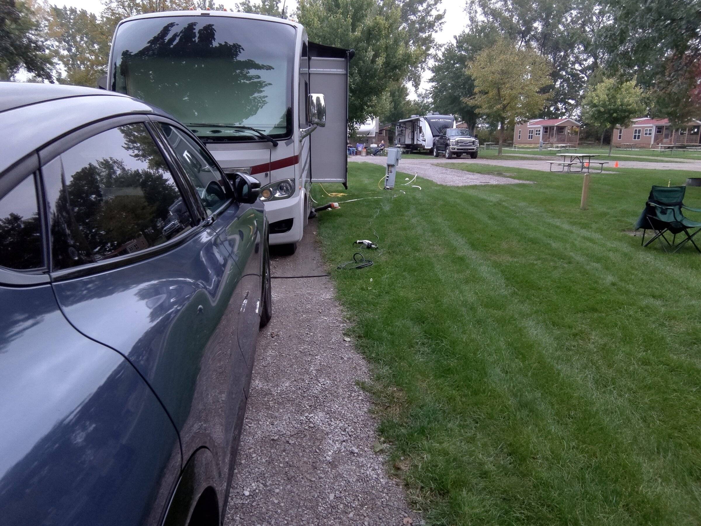

The J1772 extension cables are designed for the current and thus aren't a fire waiting to happen.
Especially since you can get an EVSE with lower current if you're concerned. I've had a 40ft J1772 extension cable similar to the one OP linked above and have used it on all four of my plugins since 2013.
Ford Mustang Mach-E Extension Cable for charging in apartment? BoltExtension2
Ford Mustang Mach-E Extension Cable for charging in apartment? 2021-10-07 18.47.21
I typically only run about 20 amps through it. At that current it doesn't get warm at all. (In the above pic of the Bolt I was running 30 amps through it.)
I’m not talking about the J1772 extension itself being a fire hazard. I’m talking about the outlet inside his apartment (either the dryer or 120V). Both are likely to be old and I wouldn’t feel comfortable running max current through them overnight without inspecting them first.
